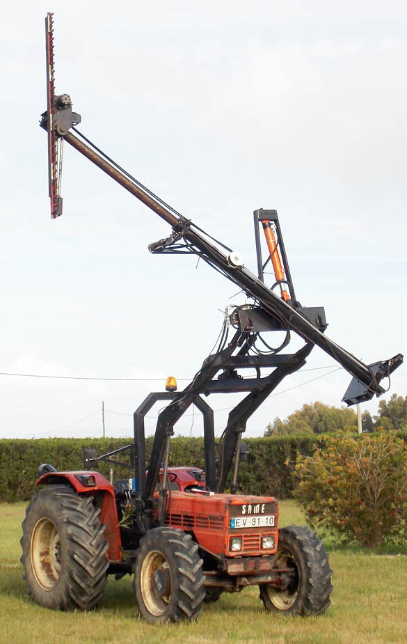

I thought a picture of the SAME Mercury would be in order; the loader is from a 1965 MF35, I made the rops and the hedge cutter in my home workshop.
And some other stuff not pictured.

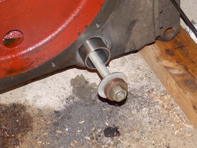

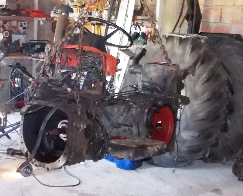

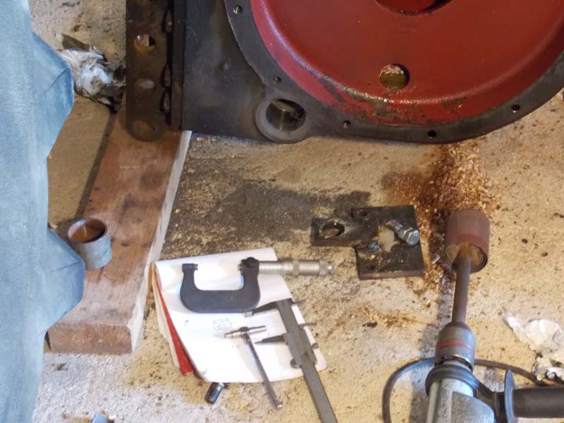

Yes, I still have the Same; I changed the clutches, rear axle seals, installed 3point shaft bushings [had to bore the gear case!] changed the front axle bushing, rebuilt the steering cylinder [new end joints] and other things.
I think I had to consult the manual for torque settings on the clutch.

I made a drill powered carbide cutting tool to bore the egg shaped 3point hole in the gearbox round, then made steel bushings to fit and pressed them in.

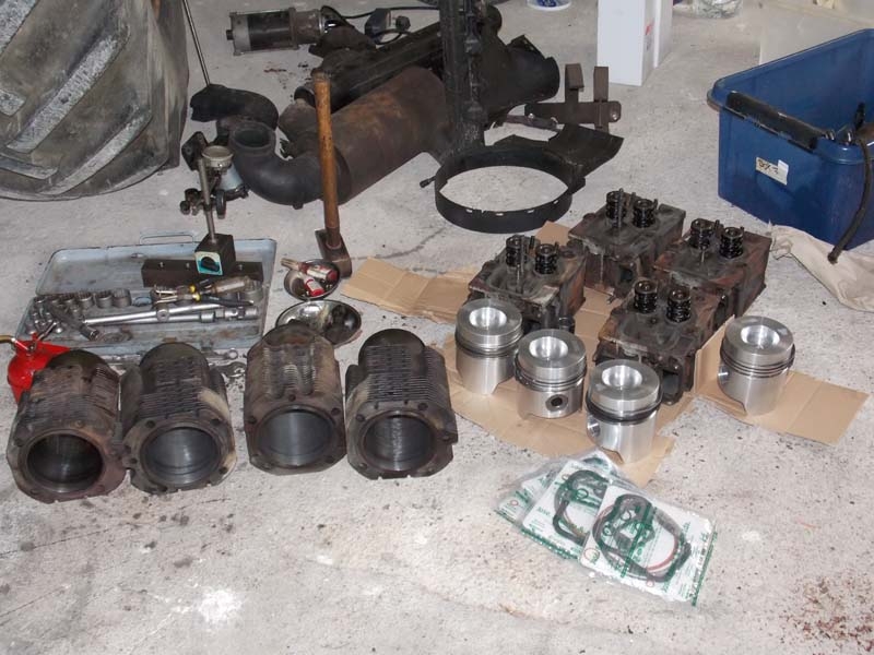

A few pictures of the top end rebuild I'm working on right now.
While bringing the tractor into the garage, I saw that the left wheel had a loose bearing; bolts had come loose. I had to take it all apart to clean and repack the steering bearings (taper roller bearings), and I put in proper seals to replace the original rubber disks.
The pistons were worn but the cylinders weren't; an odd situation.
I had the valves and seats ground, and the injectors checked. one was bad.
