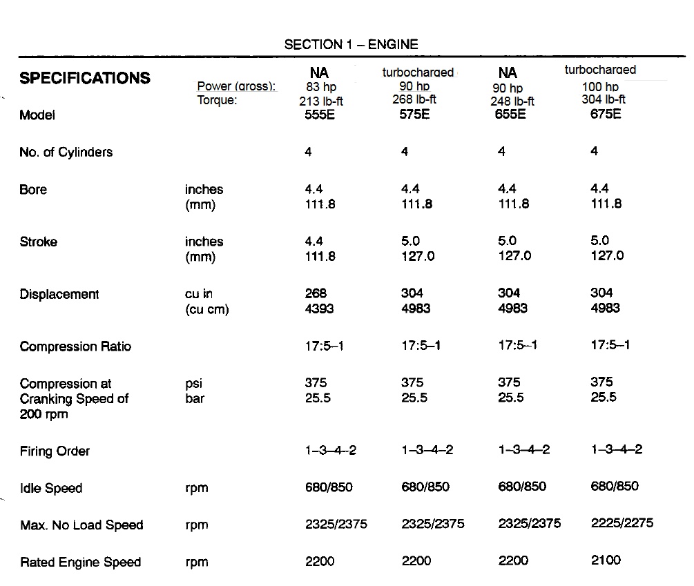

I致e been looking at some compact tractors and I知 confused about something. Spec sheets show 3 different HP ratings (40, 45, 50) but all 3 tractors have same engine, same frame, and same weight. What makes the difference in HP?
No different than having three different engine choices when ordering a pickup truck .

My neighbor and I have the same brand tractor, his is 60hp mine is 50hp. They ARE the exact same tractor through and through, except for tire size and pump settings. (mechanical pumps)
I've used his tractor quite a bit, as we hay together, and his has noticeable more power over mine. You can really feel the difference with the extra pto power, when it's needed.
Some new bigger tractors (electronic pump) will up the power automatically, when you have something hooked to the pto that's a big power draw. Some will go up 20hp or more when needed for a limited amount of time...
