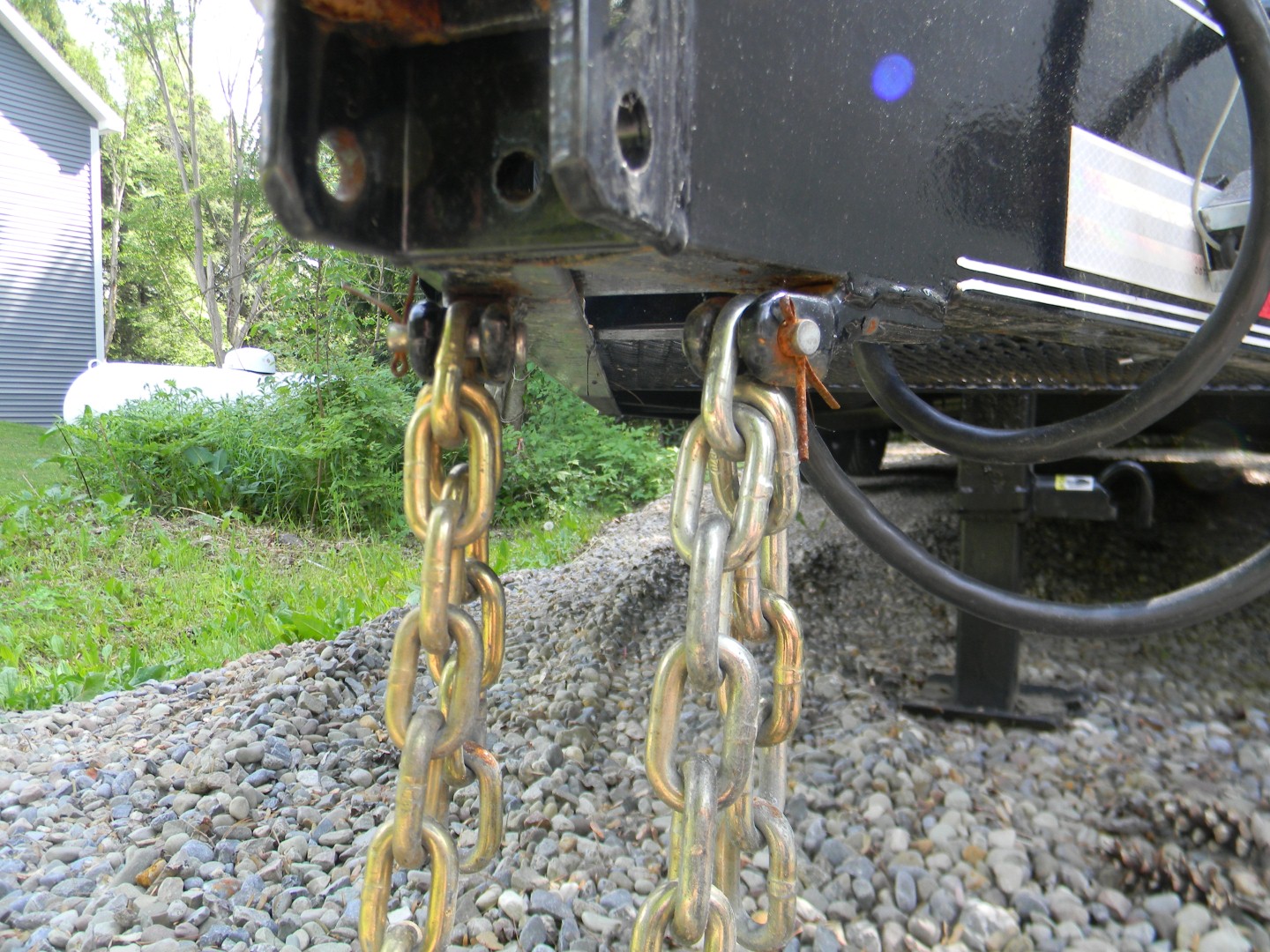

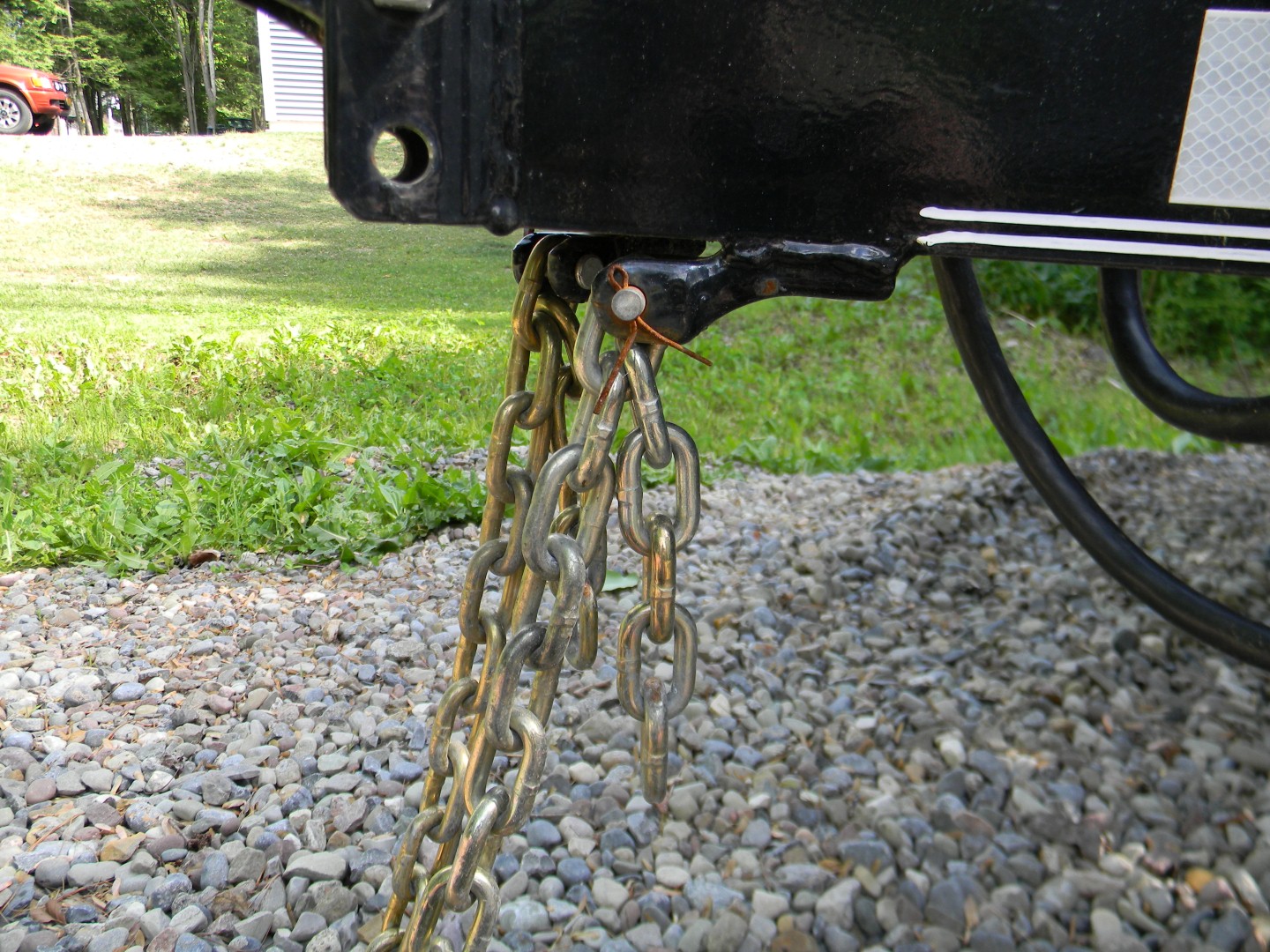

I am annoyed with the length and the hooks on the safety chains for my trailers. One trailer is a 5K flat bed and the other is a 7.5K horse trailer. Right now I tie knots or twist the chains so they don't drag on the ground. I can't believe they would meet their rating all twisted like that. Also some of the hooks just don't fit well on the truck hitch. So what is the standard for ratings on safety chains and hoooks to what is being pulled?
/ Safety chain regulations #2
My PJ trailer has clevis links welded to the frame. Just have to pull the pin and use a shorter link in the chain depending on tow vehicle used. Dump trailer has clevis pin hooks for the tow vehicle side if you need to shorten the chain. Also attached state requirements for safety chains.

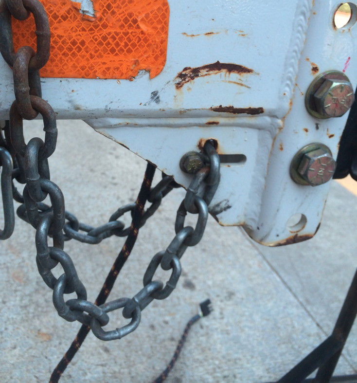

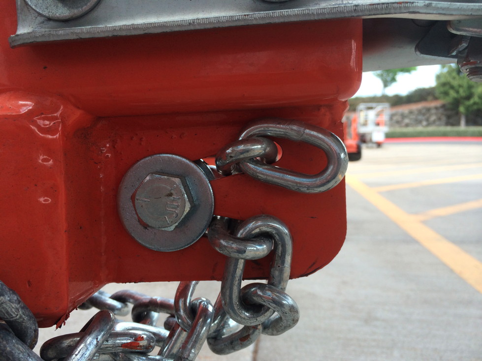

A couple of slow-adjust methods I've found:

One benefit of the ones I linked to above is that you can take them off and move them closer to the trailer to shorten the effective length of the chain. They should be good up to a trailer up to 3500# (possibly 5000#?)
