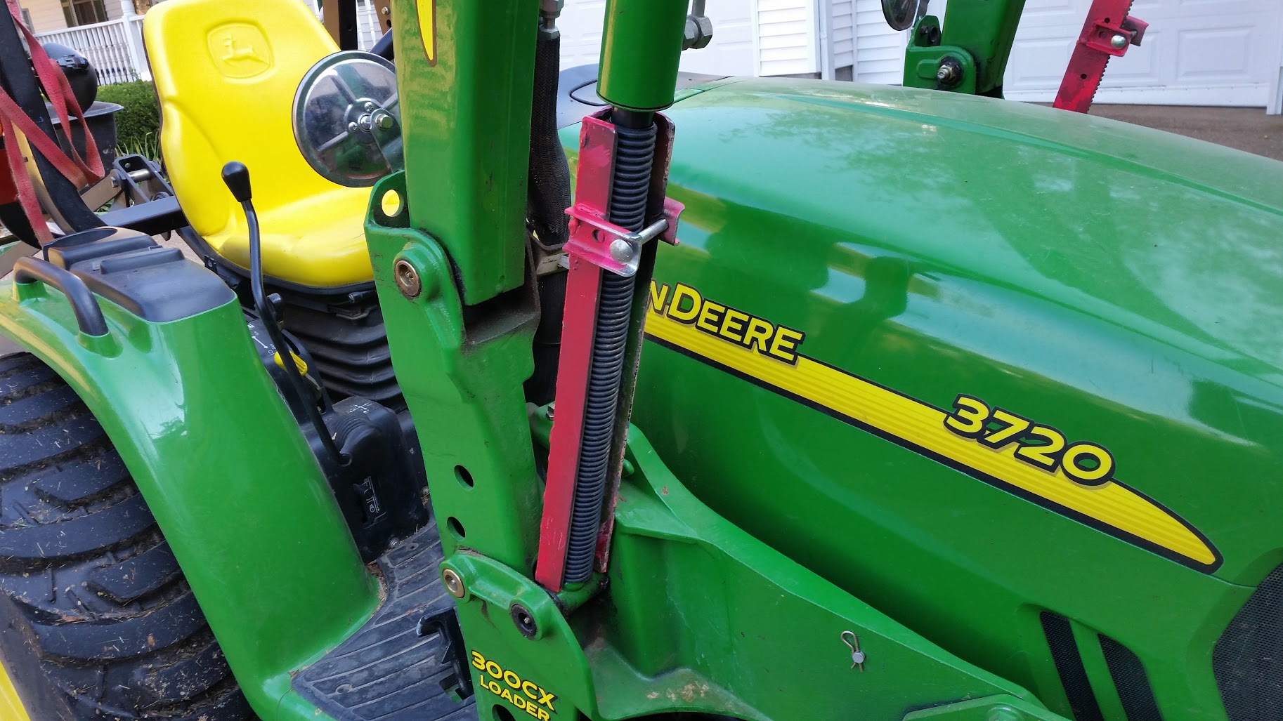

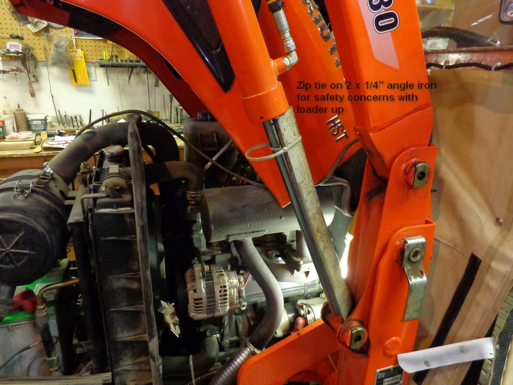

The angle, channel or bracket to block the cylinder from closing would be the OSHA approved method. Whoever said the steel could fail is correct so it does need to be sized properly. However the load required to buckle angle iron say 1/4" thick is way more than the loader weighs (or way more than 10 loaders weight).

The angle iron works well. Better yet is a custom formed piece of deep channel with holes in each end to put a pin or bolt. But angle with some tape and/or zip ties works fine.
As to the poster above that doesn't bother with this safety procedure, you will probably die of old age and never have a loader crash down on you...but in our shop if a guy has that attitude he gets sent home for the day, and if he does it again he is fired. The most likely thing to happen in a shop or at home is not an actual failure of a hose or fitting, but a friend or co-worker inadvertently moving the joystick. It happens often enough to not take the chance in our opinion. And it takes well under 5 minutes, in fact under 1 minute to place the support.
