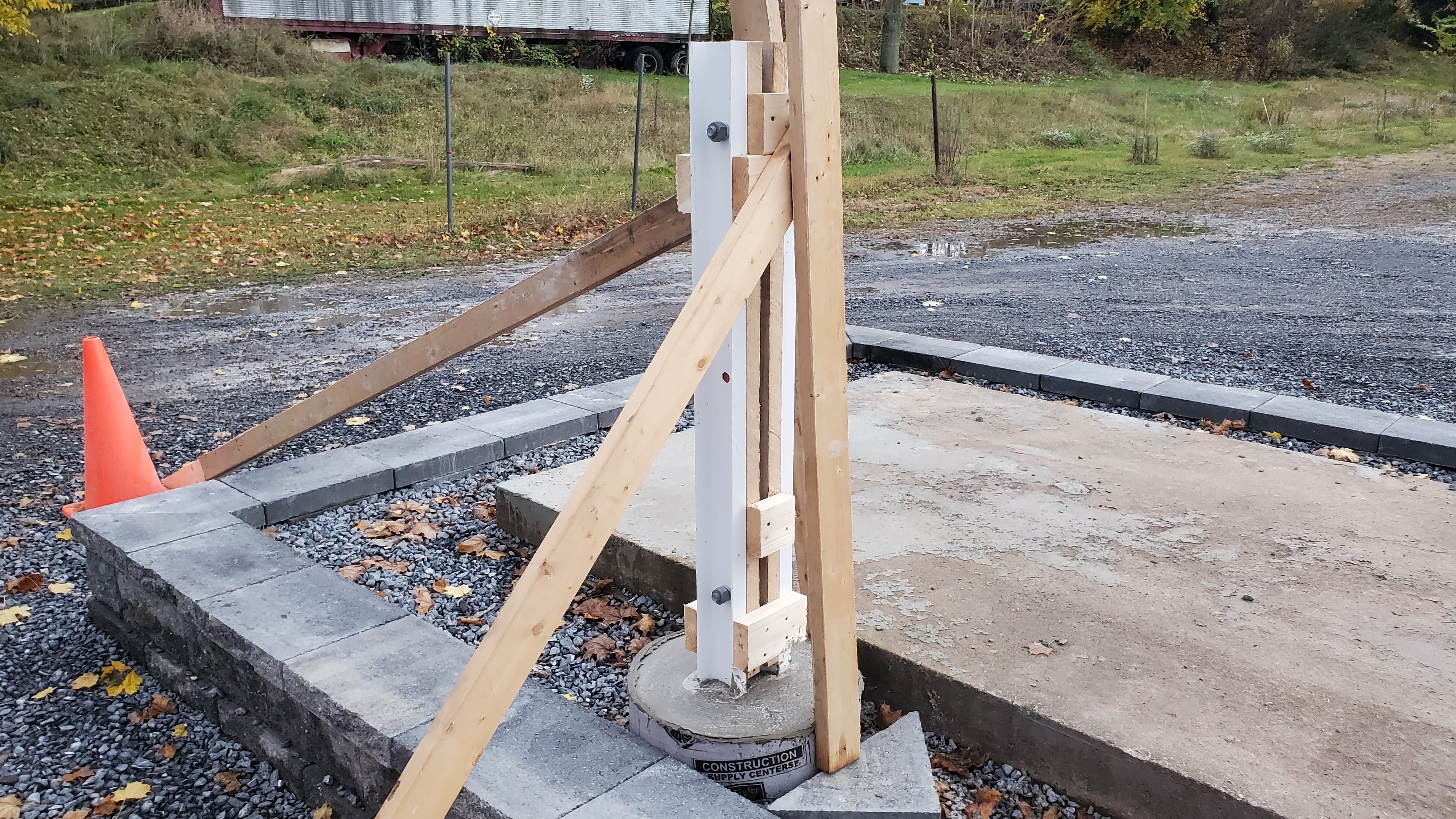

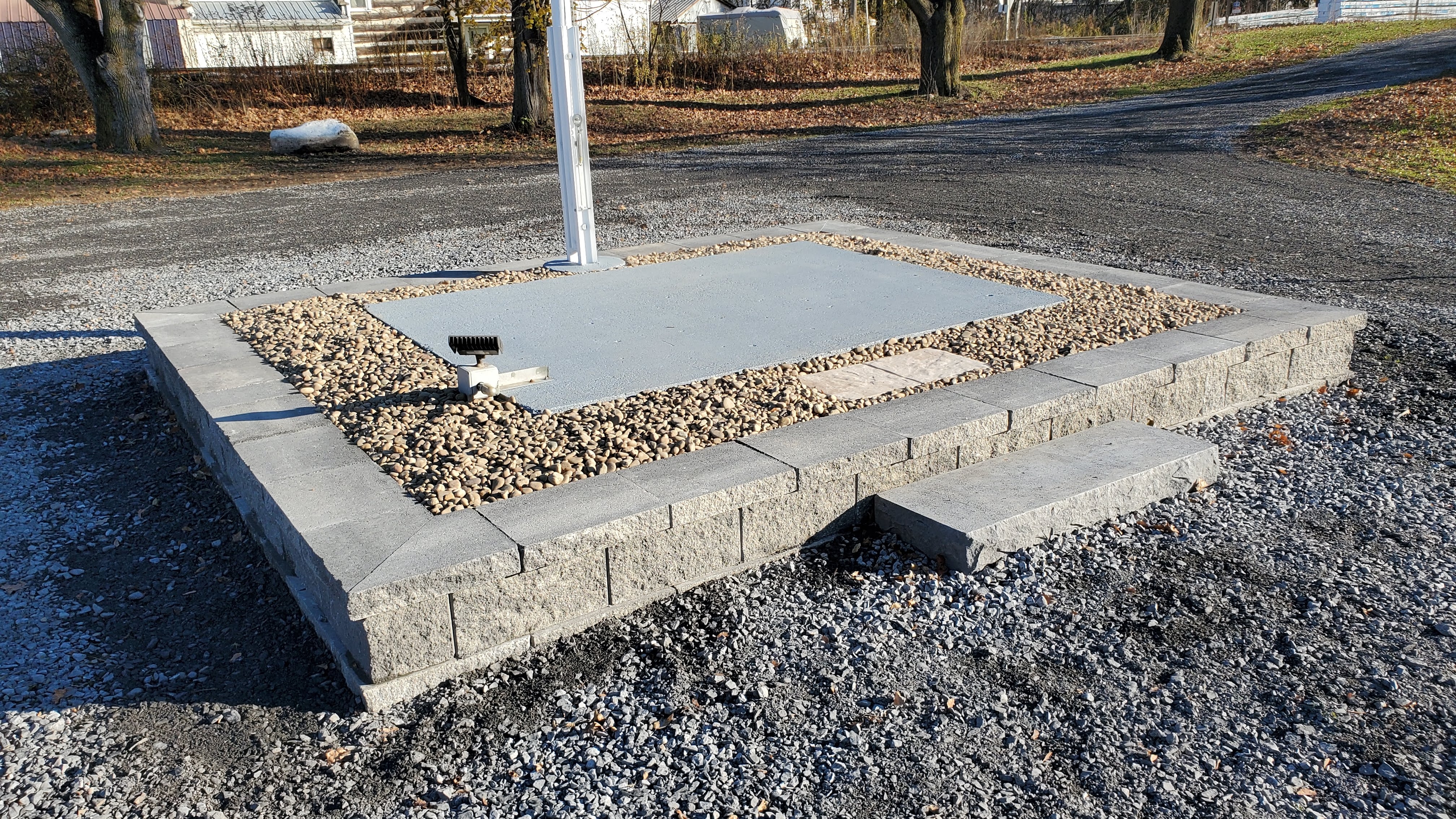

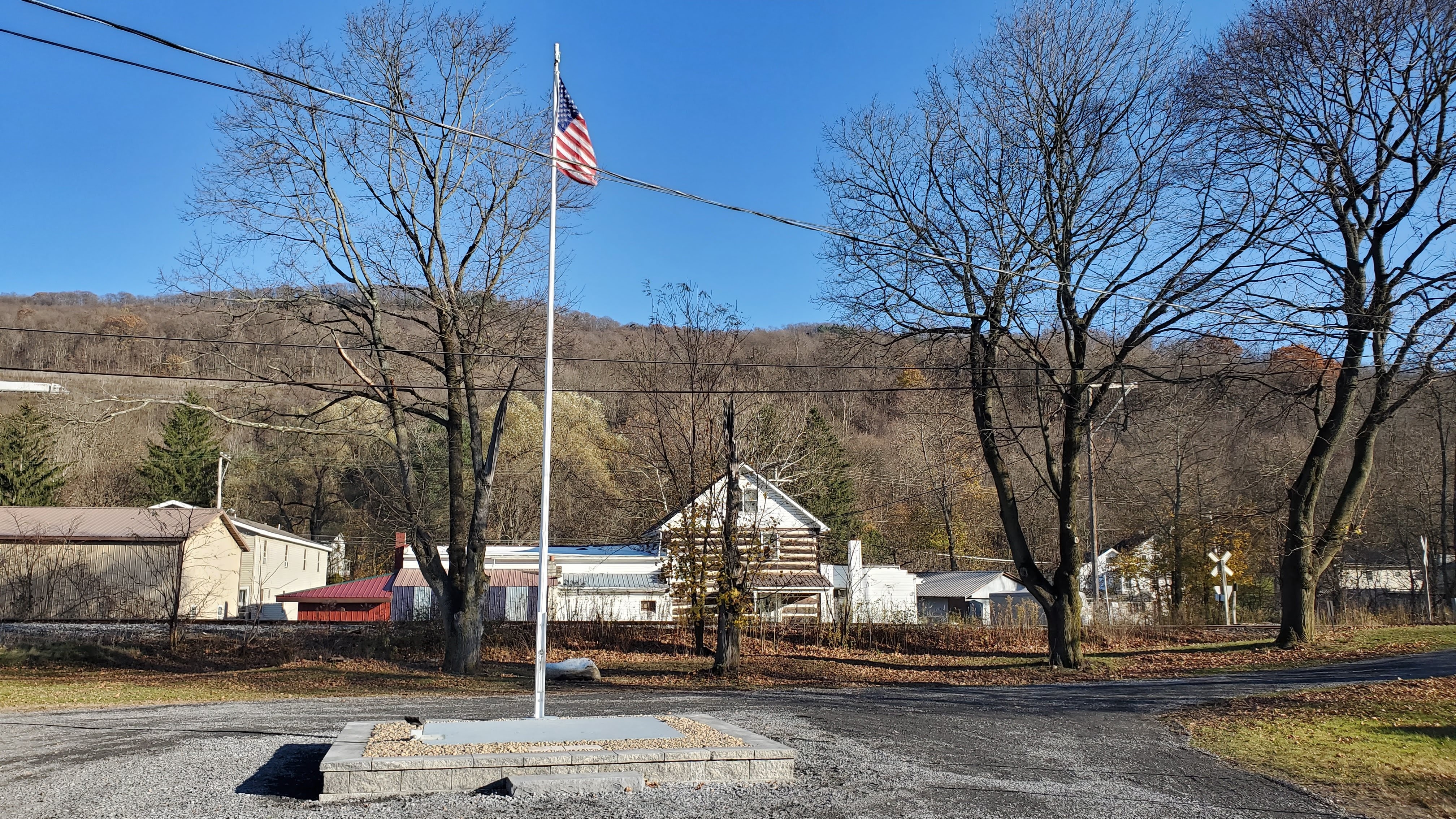

We poured a concrete base with 2 opposing pieces of steel channels to serve as the anchor. The steel pole was bolted to the channels with (3) 3/4" bolts. The bottom of the pole is left several inches off of the base to allow room to pivot. We basically installed one of the upper bolts to serve as a pivot point, raised the pole as much as possible using my FEL, then hooked a come-a-long to the bottom of the pole and the tractor and winched it up, pivoting on the center bolt. A few inches of movement at the bottom was a few feet at the top of the pole. Once vertical and aligned the other (2) 3/4" bolts were installed to hold it in place. We installed the typical flag raising hardware, but the pole can be taken down or up if needed again. I always thought that would be good for a light pole also. How else would you change a bulb or light fixture maintenance without a big ladder or a bucket truck.
The original landscaping was replaced with a new decorative retaining wall, and pad for ceremonies and of course lighting.

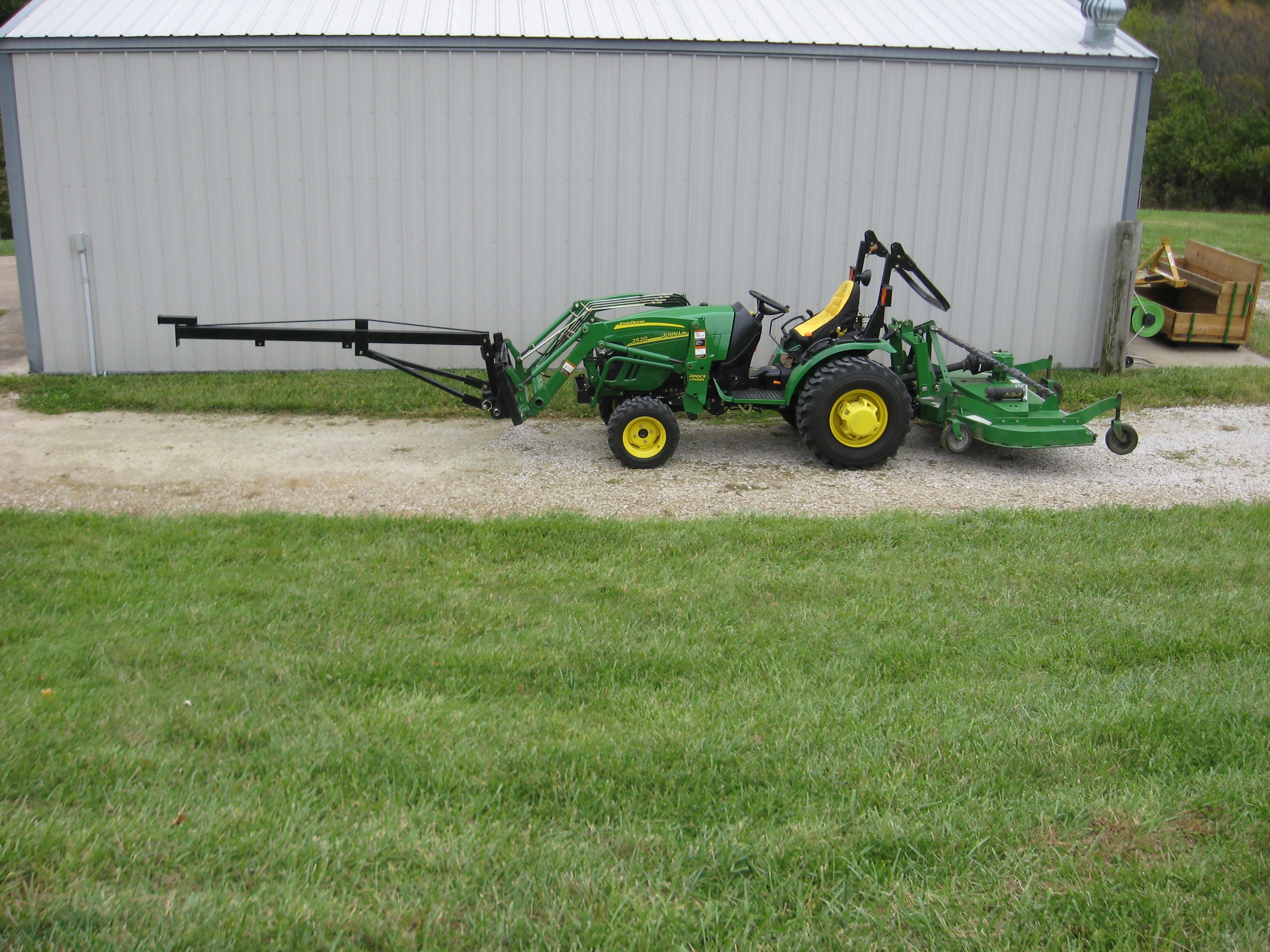

I am presuming you have a front loader. What I do is bolt an extension pole to my loader so that I can get some extra height, lets say 16' overall at the end of the pole with the bucket raised to the max height. Then I assemble the light (lantern, bulbs, cord, finiale).
Next, I add weights to the base of the light pole so that when its picked up at the 15' mark, the pole would hang almost vertical from this new c. of. g. Leave the extra foot to reach over the baseplate bolts.
When you raise the loader with a strap at the new c. of. g. (light + pole + added weight(s)), the assembly should want to travel with the base end on the ground at all times. lift it up and you can place the base on its foundation. You ought to be able to do this just by yourself since the tractor carries 99.99% of the weight. Bolt it up and remove the added weight(s). Strapped on suitcase weights work for me.
Having a smooth loader valve controller makes this easy because you can raise or drop the load very slowly. If you are going to have to travel some distance to the pole's new location use a rope to hold onto one end. They tend to want to swing around as you move.
x2 on the front-mounted boom pole idea.

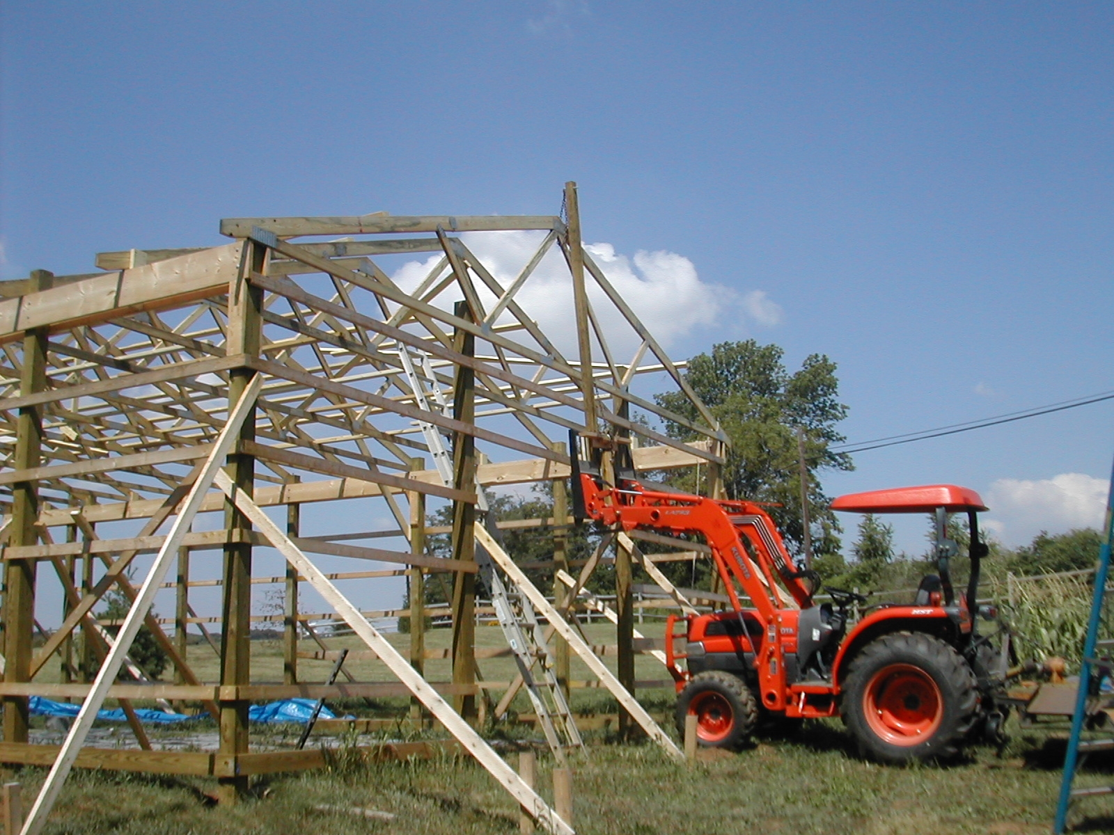

I set trusses by myself with a pole on FEL, a pole probably be easier.
