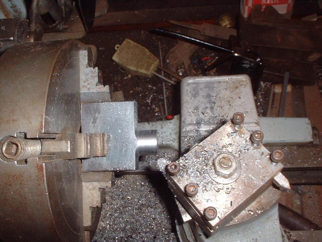

So here's a shot after profiling the radius a bit more, getting ready to begin the second port:

Then I used a center drill to mark the center of the first port sleeve, and drilled it with an 1/8", 1/4", .406", and .5" drills. The first three drills I drilled through to what will be the core of the banjo, but with the 1/2" drill I stopped at 1/2" depth to make a shoulder to stop the tubing.
The profile radiusing is almost impossible to get very smooth by hand. I just don't the proper trig calibration in my hands to CNC it manually. /forums/images/graemlins/smirk.gif The last thing you want to do is to cut too far, so I left it a little big. I will be cutting a similar radius profile at a right angle to this which will allow me to take some of the roughness out.

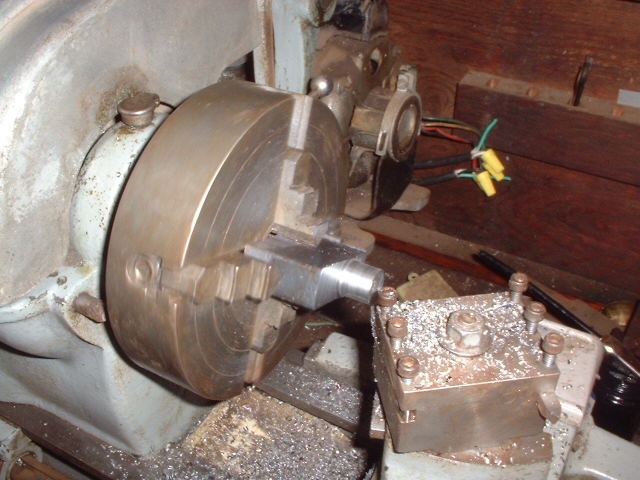

#24
This is a larger view of the drilling setup.

#25
And here's another long shot of the lathe at this setup. /forums/images/graemlins/smirk.gif
Next I will take the part out of the 4-jaw and set it up for the second port sleeve.
