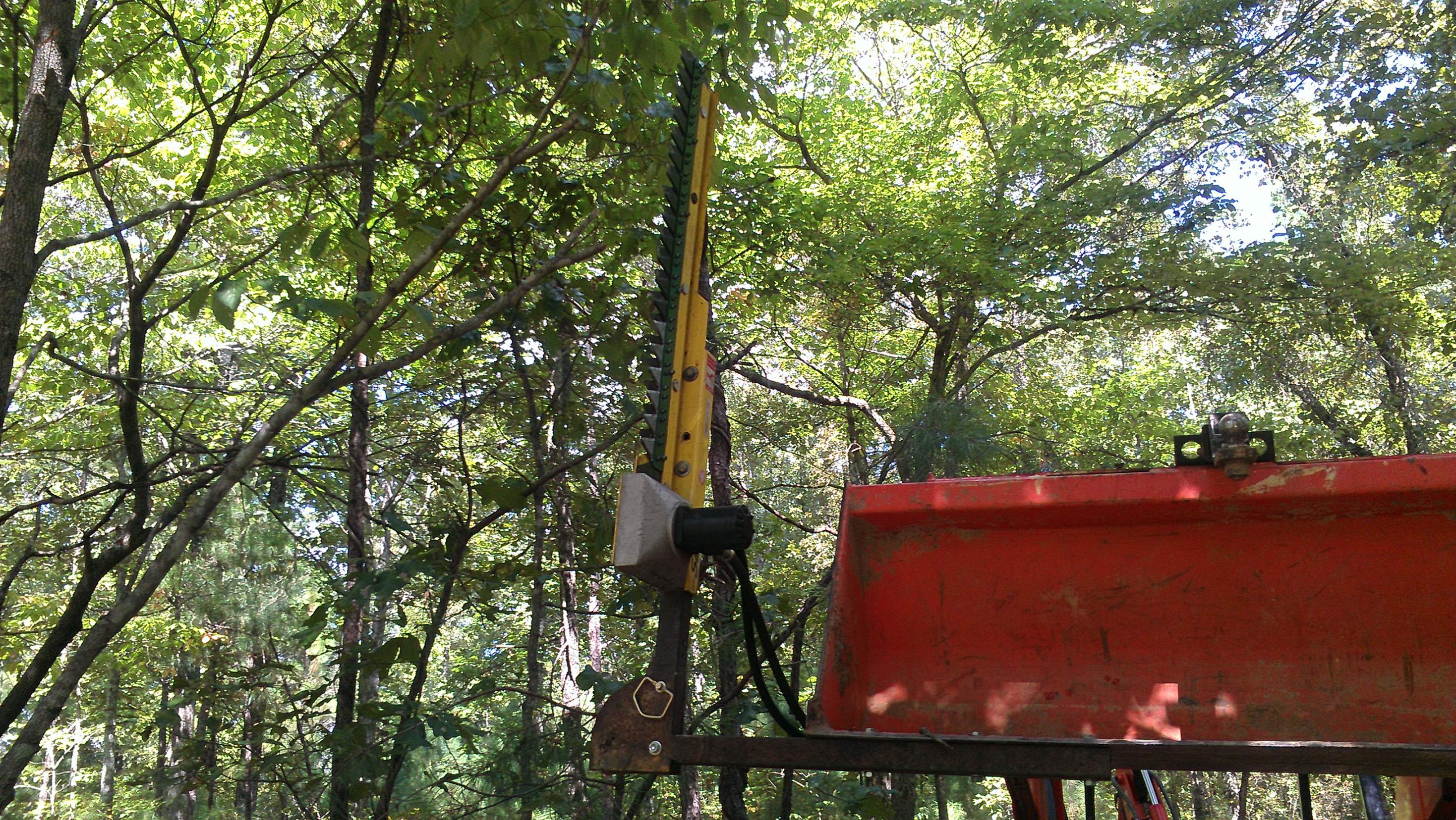

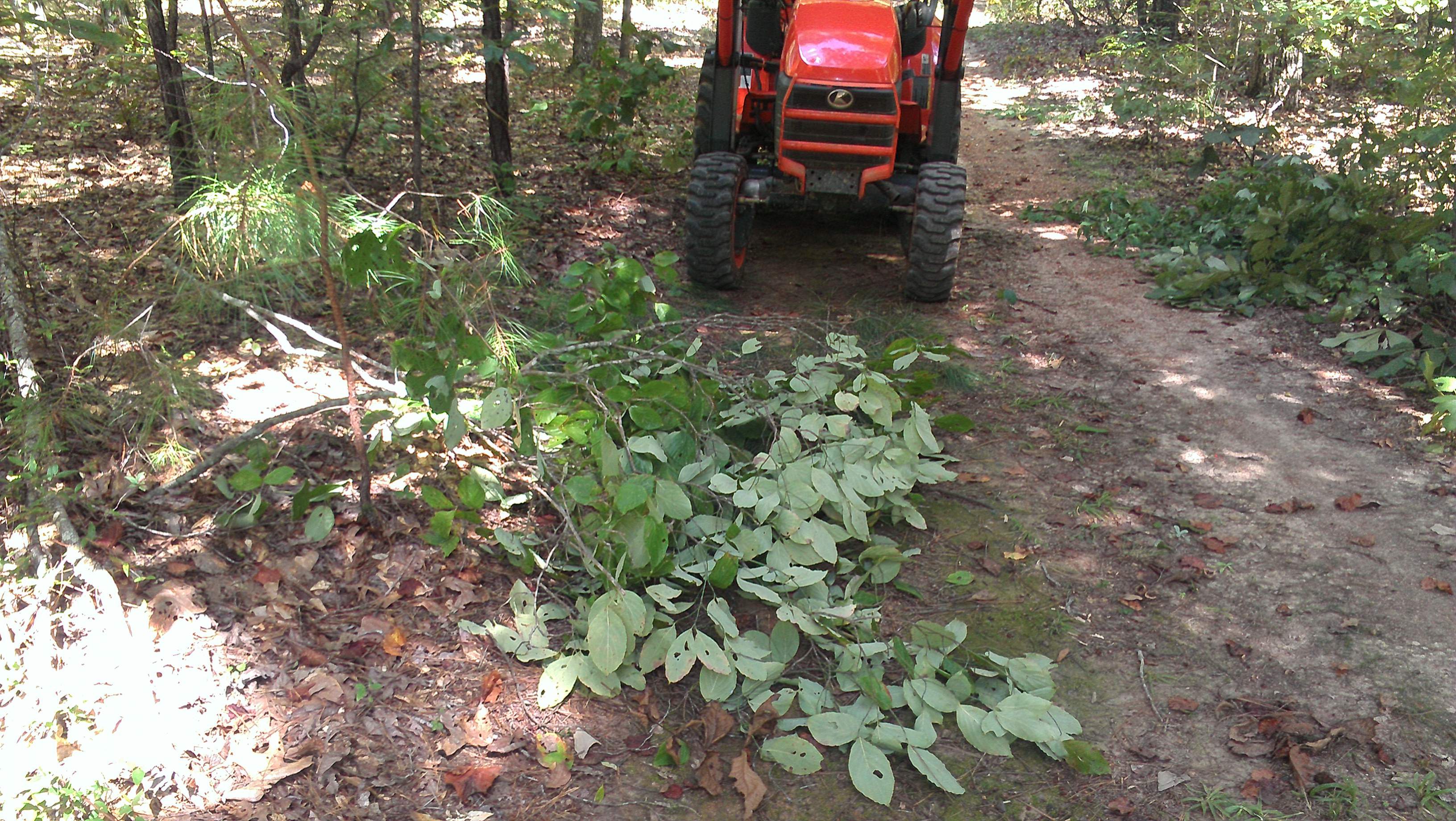

now with all that said if the Sabre is used as intended and I know everyone here uses their equipment as intended, then it does a great job. I trim my drive in just over an hour and it use to take all day and I am not near as tired as I would be if I still did the old way.
/ Sabre Samurai #29
We use ours on trails. Miles of them. Lots of variables.
/ Sabre Samurai
#30

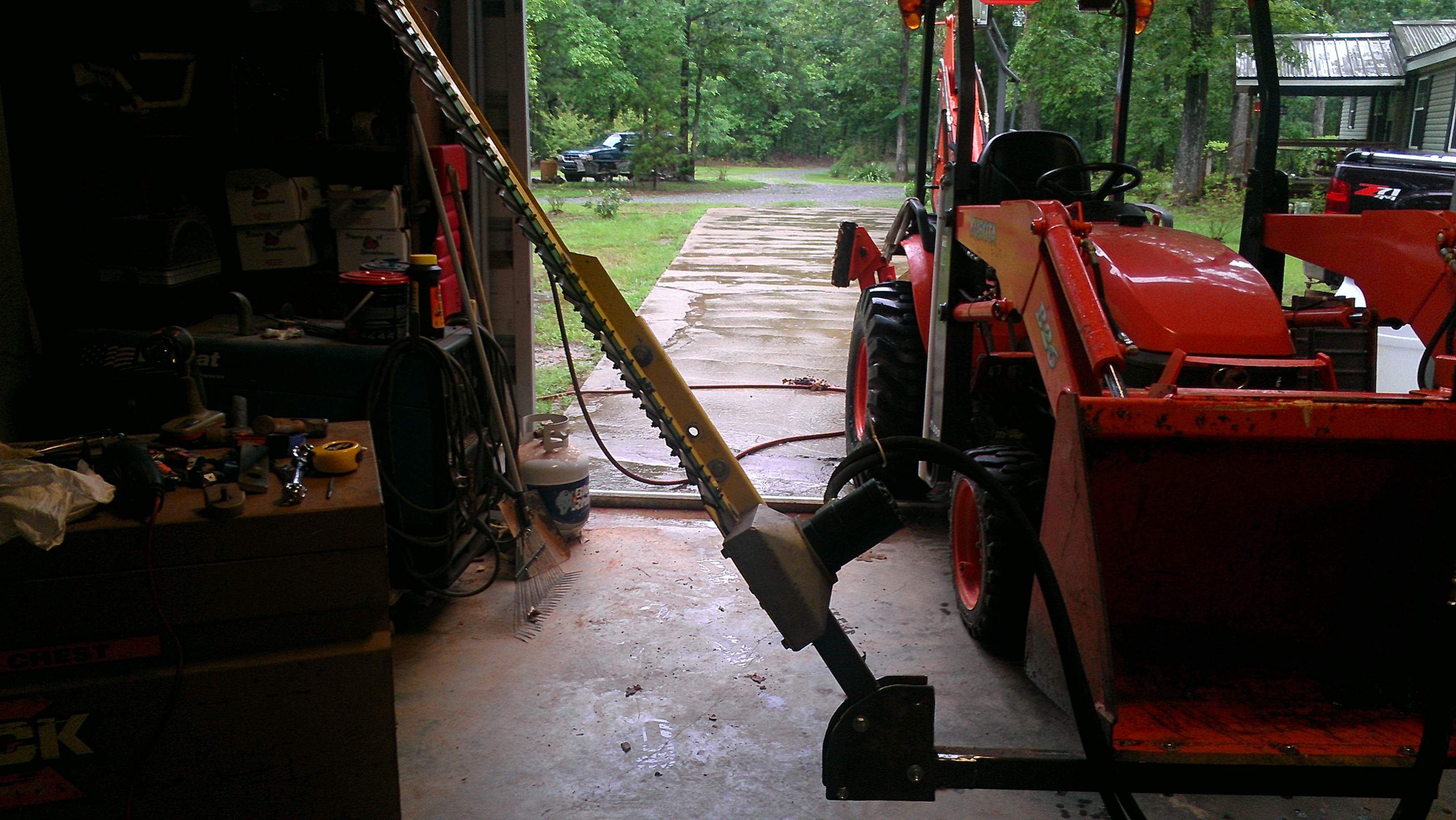

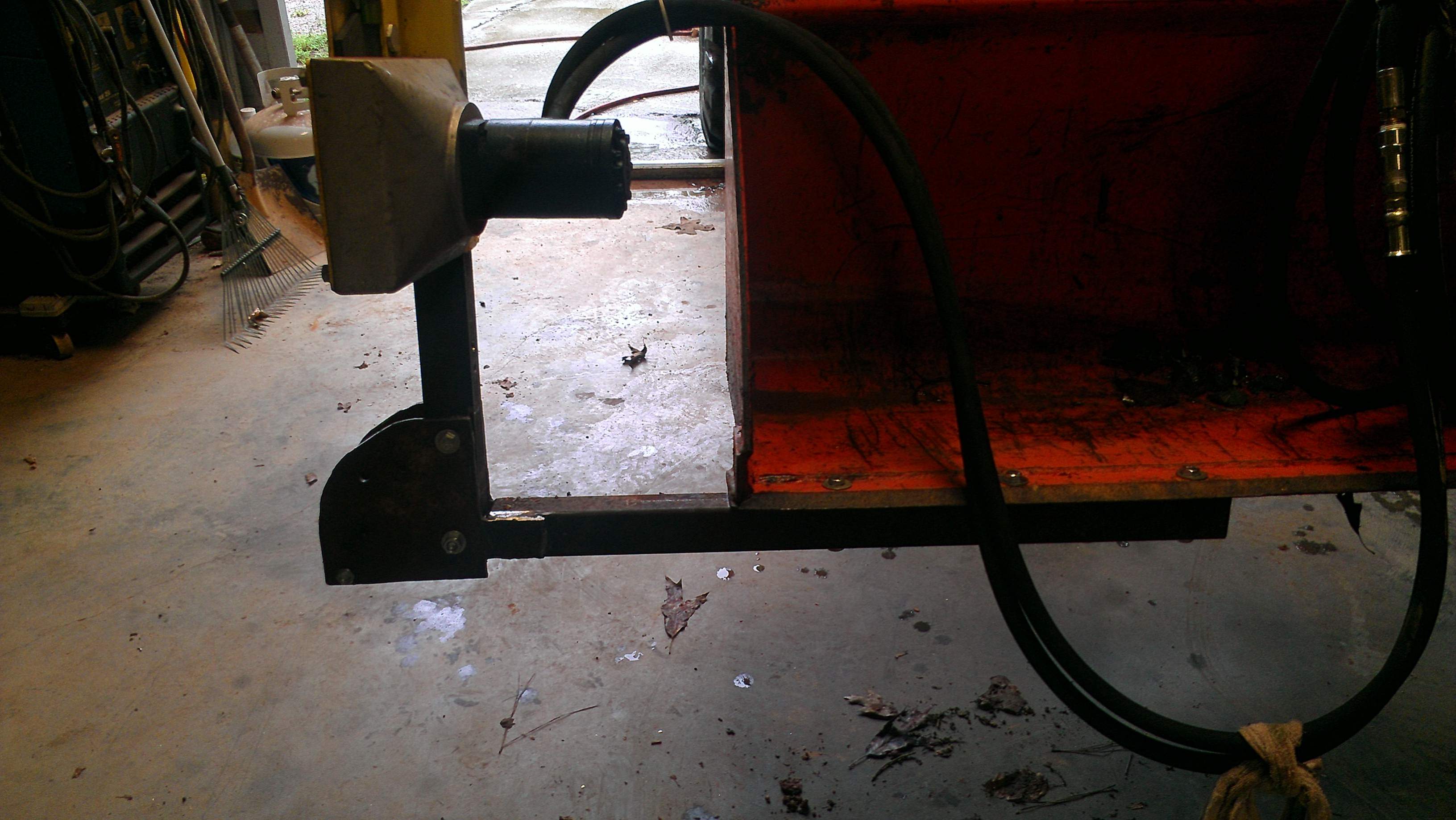

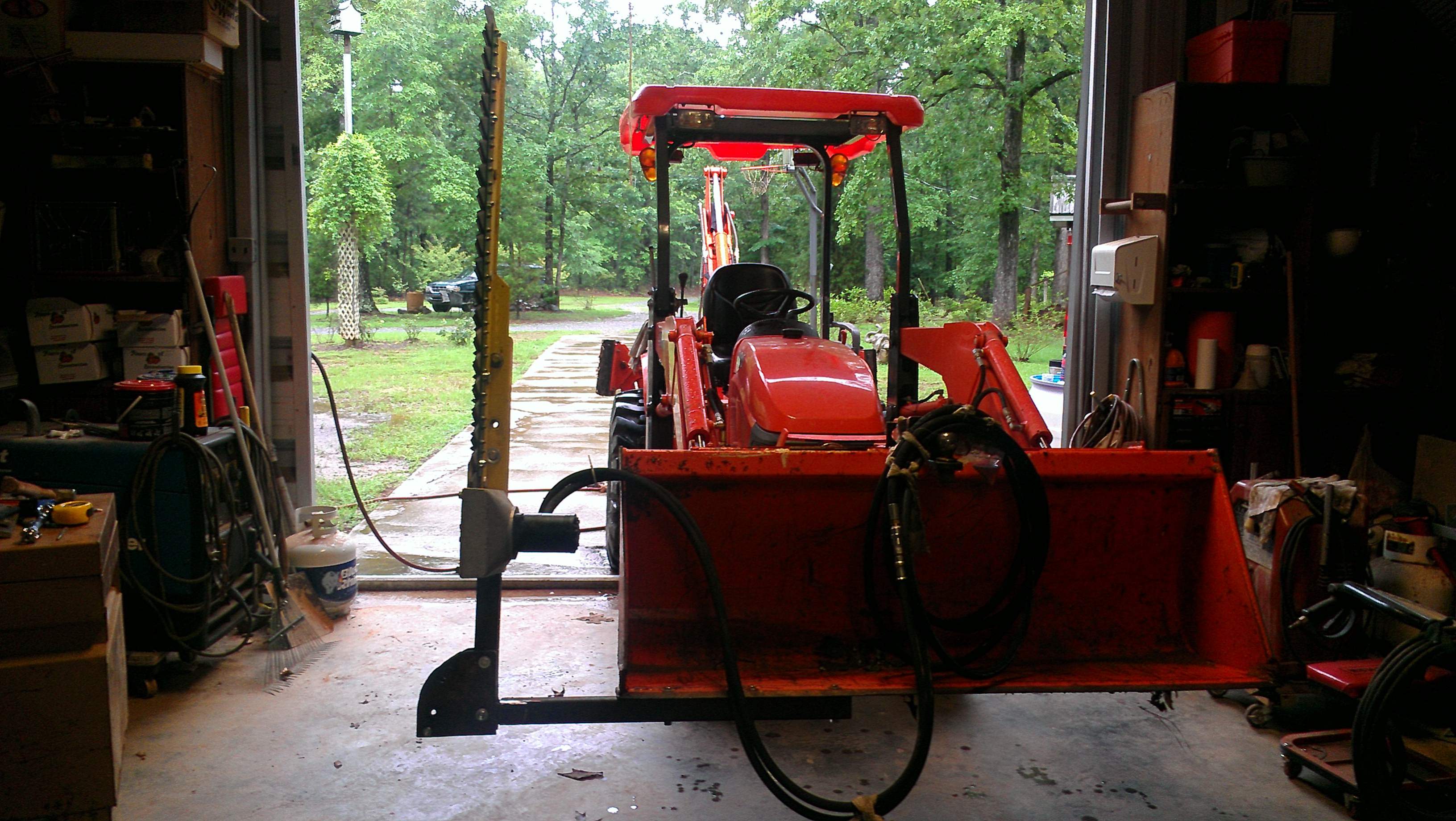

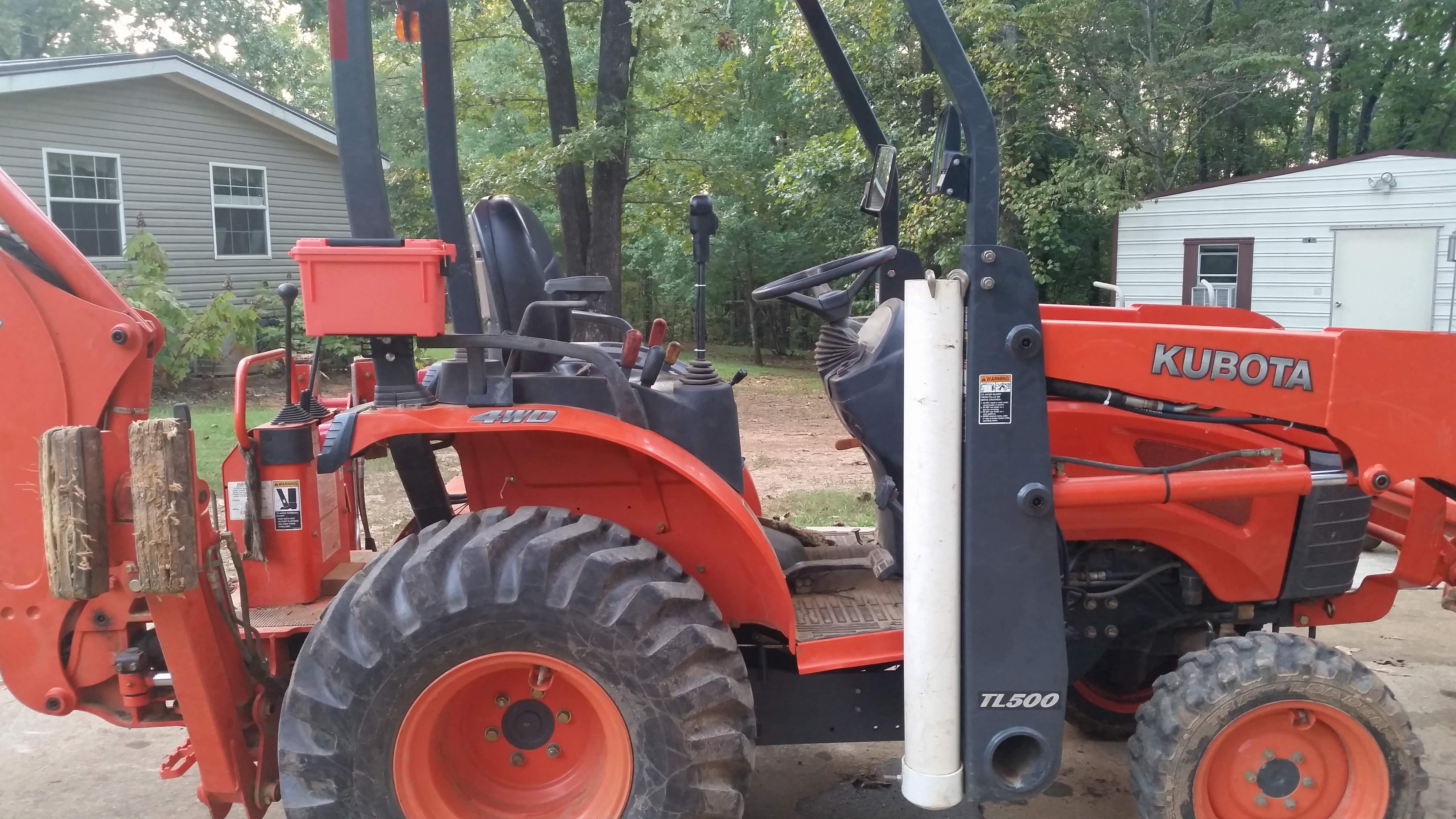

excuse me for digging up my old post but I finally got around to doing some more stuff and here it is a year later and the sabre is still going strong, refabed to mount and made it so much easier to connect I also added W.R. Long 3rd function remote, and I added a small tool box for gloves and extra pins.
