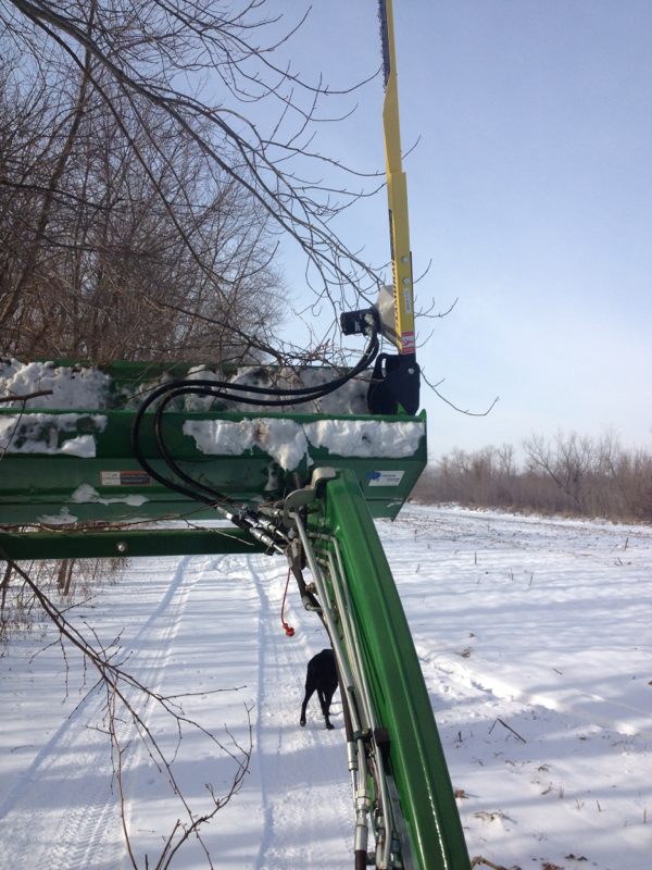

I have one which I purchased late last year. Have only used it a little this spring. As far as I am concerned, it operates as advertised. It is NOT a heavy duty saw but it is great for cutting encroaching, out-of-reach, new growth along trails, field edges and ditches. You'll need a third hydraulic source on your loader and a flow control valve.
These are photos I took when it first arrived.

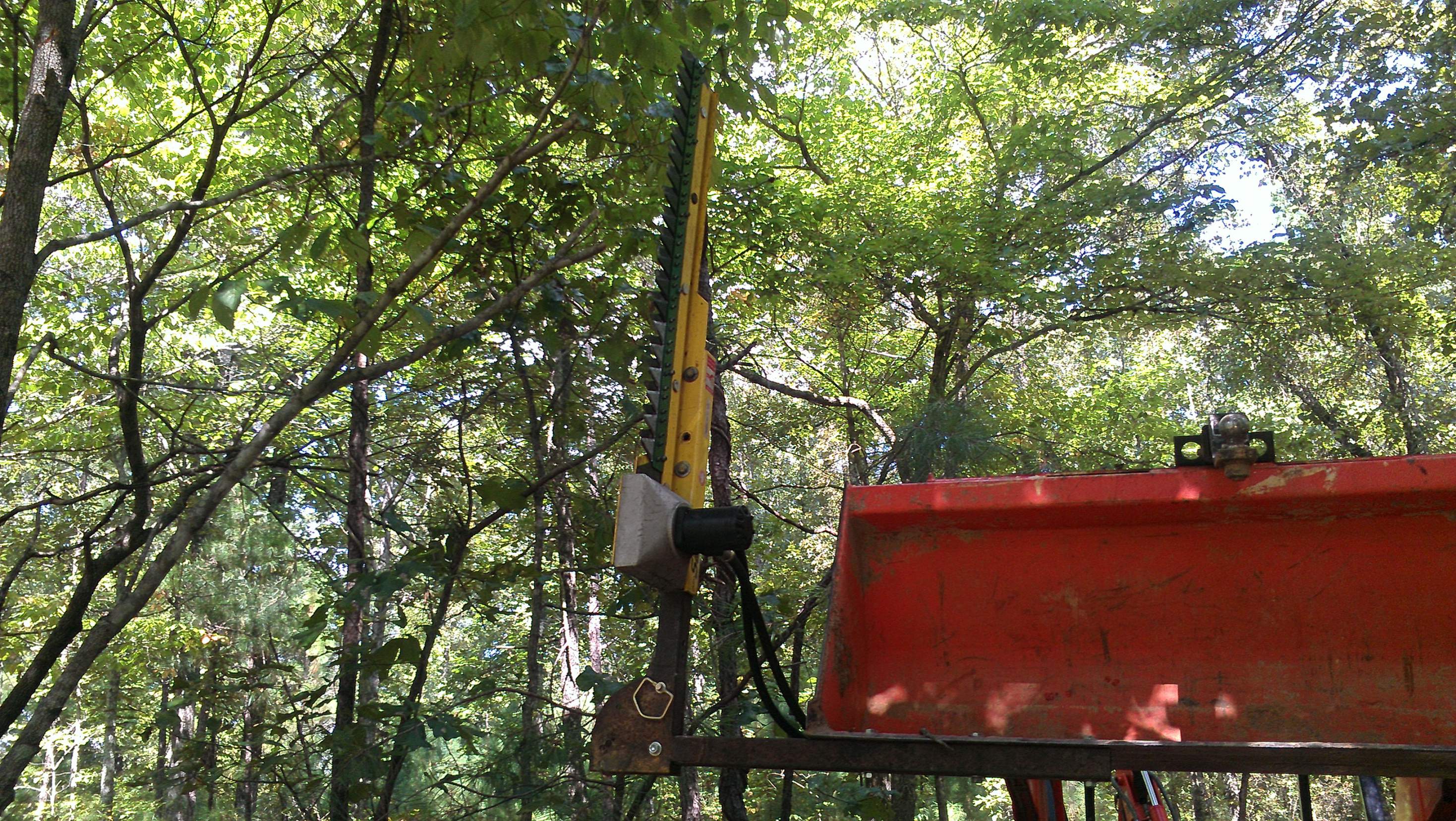

Sabre on Ebay (6.jpgSabre on Ebay (7.jpgSabre on Ebay (9.jpgSabre on Ebay (10.jpg
ok I been busy but I finally got back to my sabre, fabricated a mount so I can cut horizontal, vertical and if the tip hits dirt it can float. still got a lot to do like putting some kind of skid on the end of the bar, some quick connects, and like I said in an earlier post forward remotes or third function valves. still got to put some paint on it but I am further along than I was.

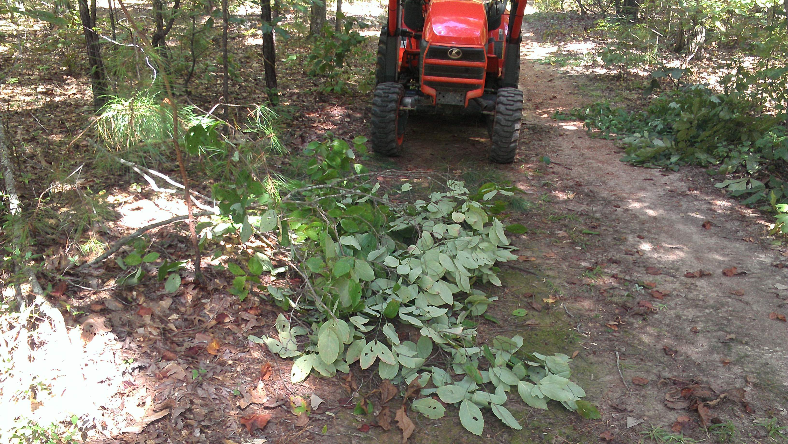

got to use my samurai yesterday did my drive and a private road for my neighbour. Louie I found out how you felt when you sheared the mounting bolt that thing makes a loud noise when it breaks.IMAG0479.jpgIMAG0480.jpg

got to use my samurai yesterday did my drive and a private road for my neighbour. Louie I found out how you felt when you sheared the mounting bolt that thing makes a loud noise when it breaks.View attachment 337792View attachment 337793

I rebuilt the mount from when I got it so now as you can see I have an adjustment up and down but I will have to do some more thinking on a friction plate and I am still going to add a wheel on the end instead of a skid plate. I have it simple to hook up only takes a few minutes and as I work the brush down I may be just cutting grass that I can't reach with the riding mower.
