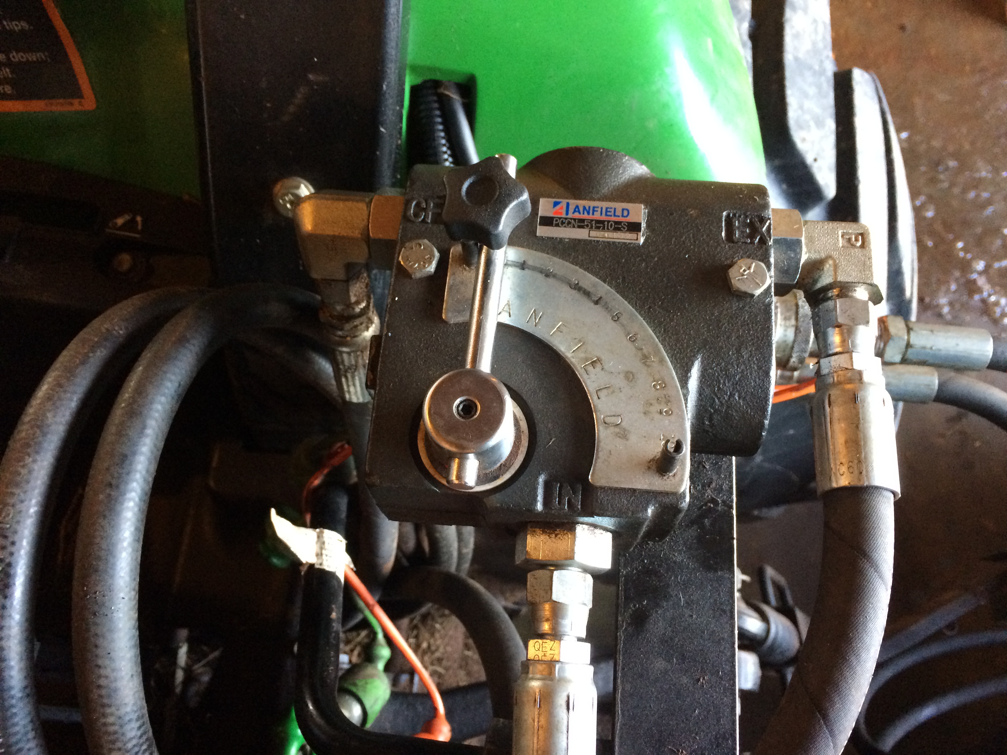

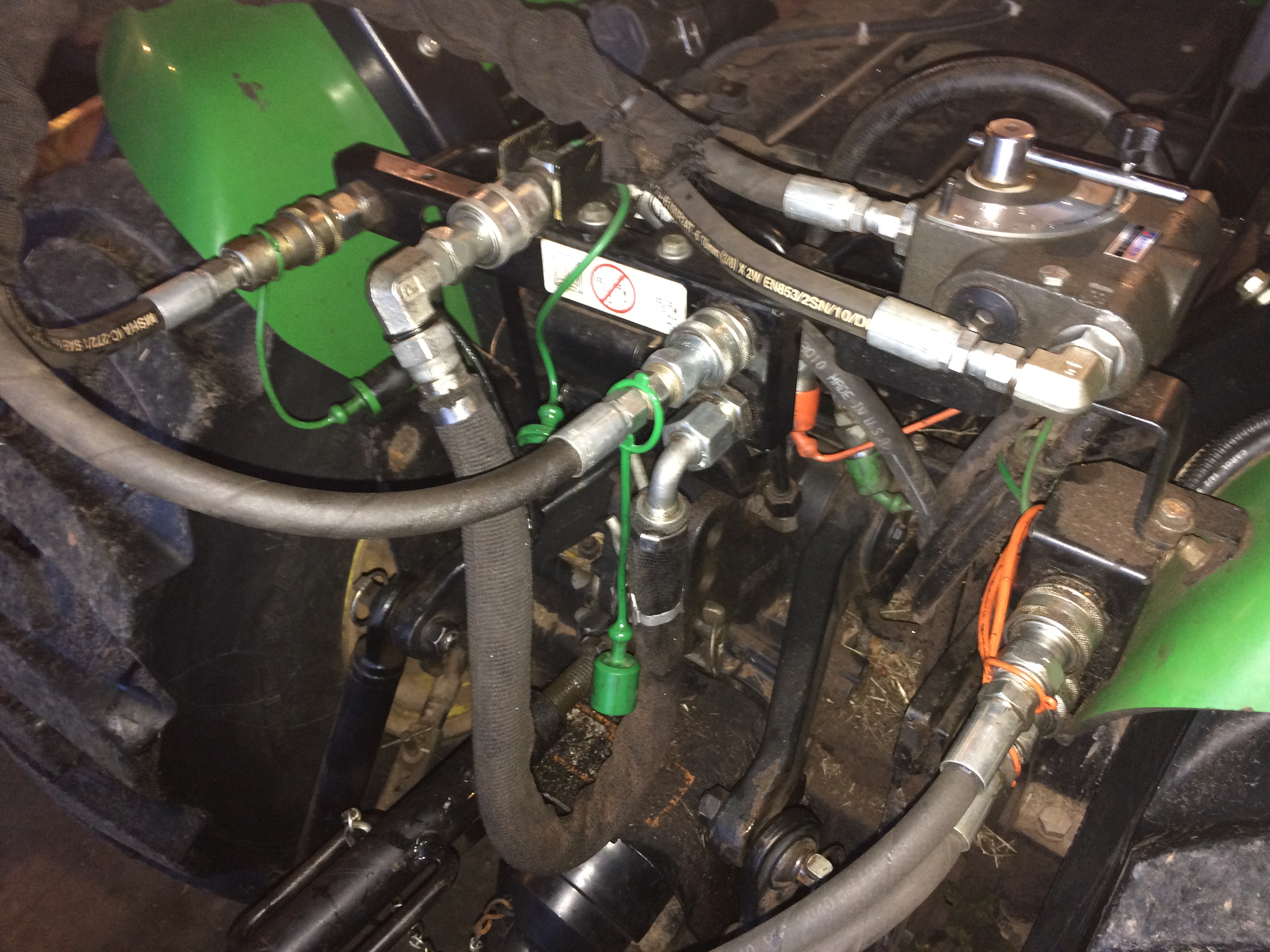

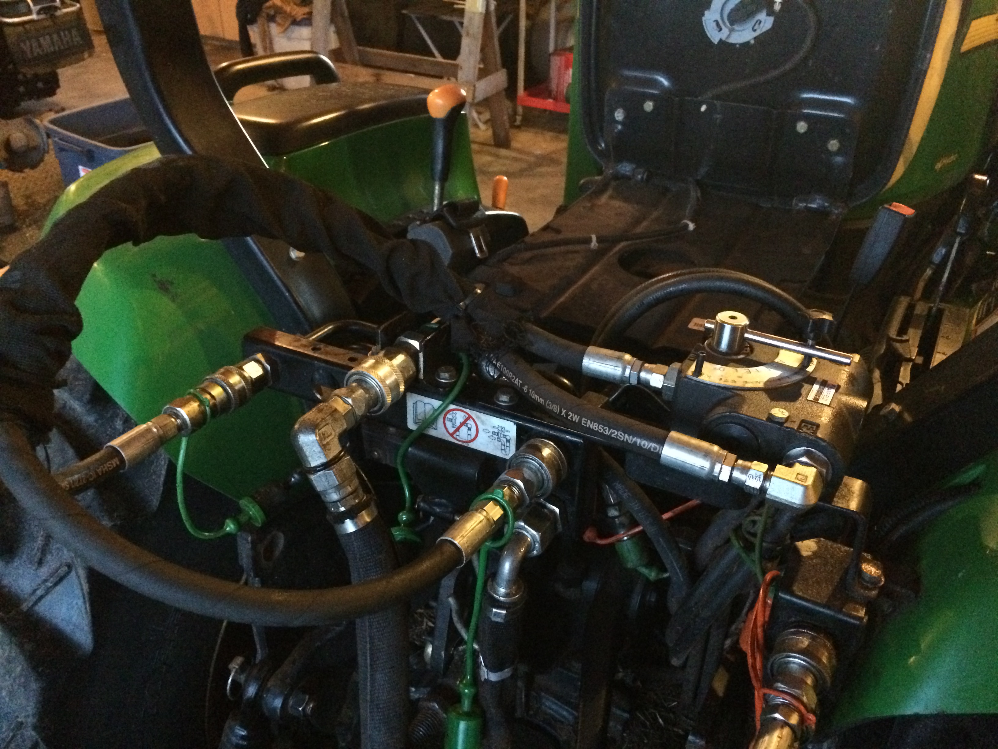

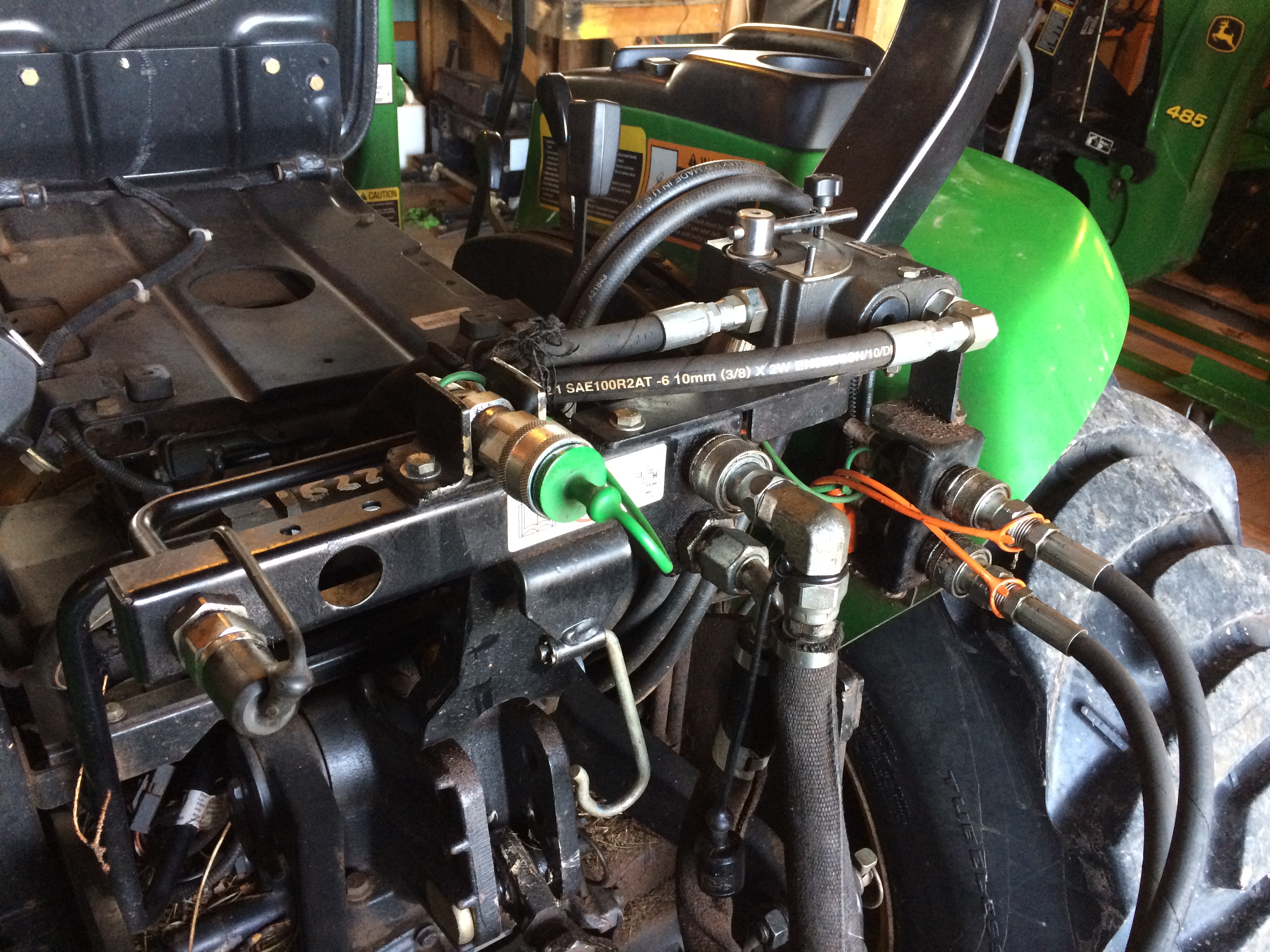

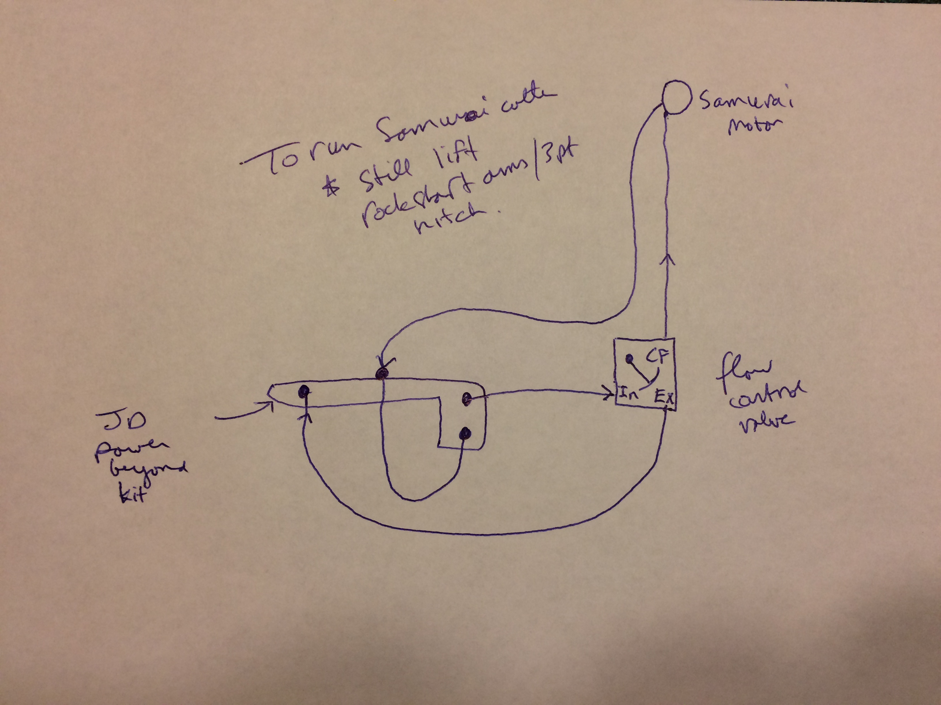

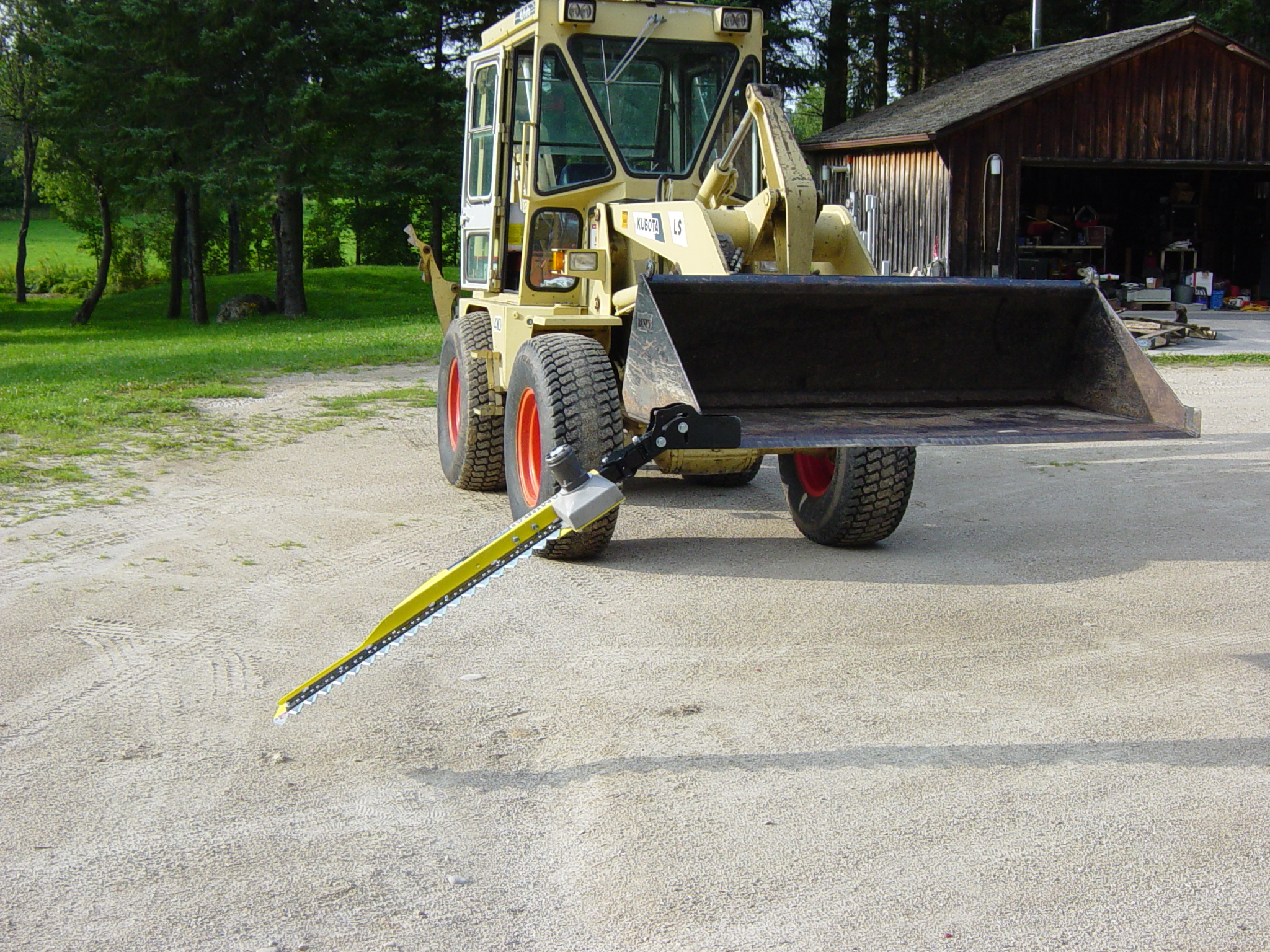

I ALSO found that hard older growth on laurel hedge will stop the Samurai in its tracks unless you go REALLY slow - there's been too many distractions since I last posted, so never made the changes I intended - today I finally ordered a directional control valve to add to the mix; without that, if the cutter stalls out on a hard 1"+ branch there's no EASY way to get it loose.
Here's the valve I ordered, it's 3 position with detents and it's open to tank when in neutral. (All necessary for controlling a motor instead of a cylinder)
1 Spool 2 GPM Prince RD-2575-M4-EDA1 Motor Valve | Prince Mfg | Brands | www.surpluscenter.com
There's another one on surplus center that sounds like this one, it's a few $$ cheaper - do NOT fall for it, it's the same valve but with a SPRING RETURN to center. In english - you have to HOLD THE LEVER to get it to work...
the GOOD news about that linked valve - it also has a built in adjustable relief valve, so if you end up plumbing things in AHEAD of your loader valve without realizing you just BYPASSED your main RELIEF VALVE, you won't GRENADE your hydraulic pump like I did :confused: - THAT was a $450 lesson...
My install is STILL a work in progress (note that "progress" is in small letters) - eventually I will add a couple more articulated joints and a pair of small hydraulic cylinders so this thing can reach across the fence and trim the blackberries, etc, my useless neighbor can't/won't control. Guess it's always good to have goals and ambitions :laughing: ... Steve

My cutter is run through my loader joystick 'trigger' via a diverter valve which feeds my front torsion bar of the loader. When I get stuck on a branch I pull the loader's joystick toward me and then away from me while holding the trigger. And, if needed back up or go forward slowly using the weight of the sickle bar to free it from the branch in question. I find it takes some finagling to get it free but it almost always does. Also when seeing that I may run into larger branches I slow the tractor forward motion to near stop while allowing the teeth to chew through the branch diameter.

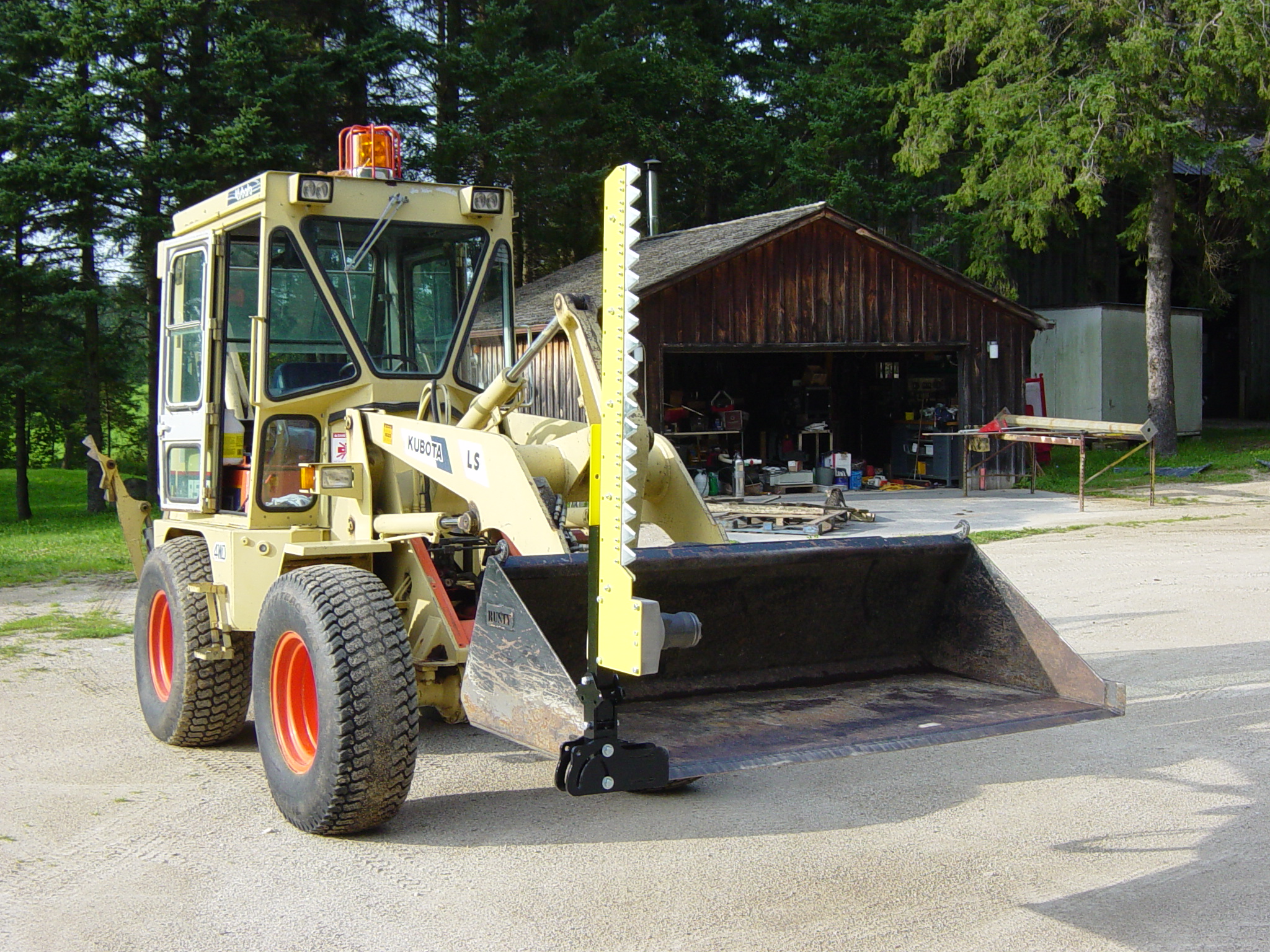

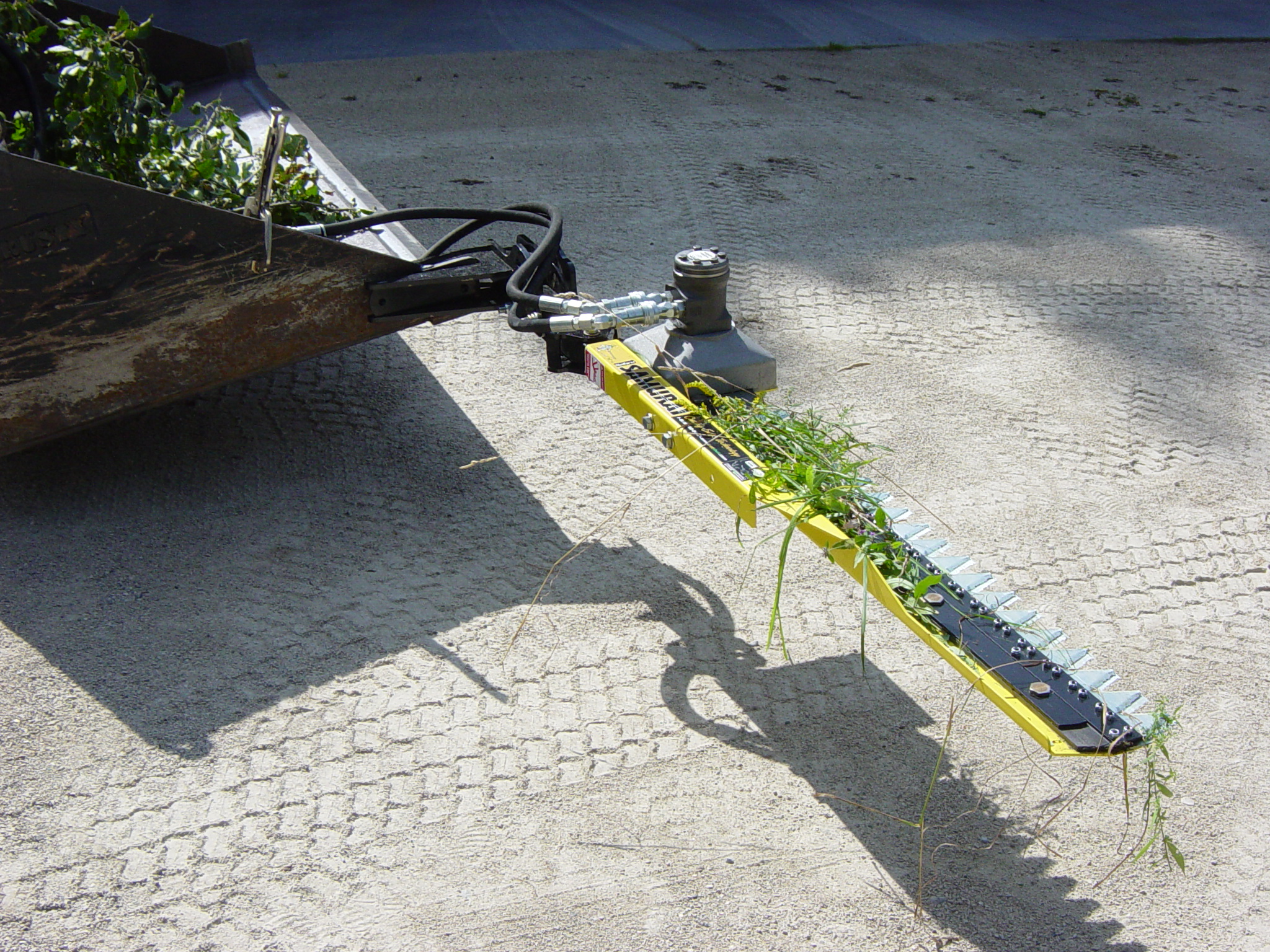

Today I did stage two of my semi-'permanent' mounting QA plate, then did a trial run. I took the QA plate I had a bracket welded to a year or two ago and added some improvements: I replaced the Allen screws that came with the OEM bracket and added some 2.5" grade 5 bolts. I had the location of where the rear bolt now contacts the horizontal plate the OEM bracket slides onto, on my QA plate drilled to create a recess in the plate's base so the bracket CANNOT move due to vibration, the weight of the entire setup, or for any other reason. I had another piece of metal welded in place to keep the bracket from moving fore or aft by forces exerted when cutting branches, and/or when I move the QA plate to positions other than vertical in order to 'attack' overhead branches etc.
These two items FINALLY make the 'system' work as intended. I cost me $120 in customized welding on the QA plate, in two visits to my local welder, each session done when I dropped by unannounced, and completed between other projects he had in process. And $10 tip today for rush work over both sessions. Also the QA plate cost- around $150 IIRC. I am pleased with the functionality now and hope to get a lot done with it over the next few days, and future use as well.
Note, the other bolt, which replaces the supplied Allen screw is located too close to the edge of the OEM bracket to be of any real use, so I did NOT drill a recess in my QA plate's custom designed bracket. Rather I tighten the forward bolt with a socket and breaker bar until tight but NOT over-torqued so there is less chance of the bolt or any other part of the OEM bracket damage due to un-warranted pressure or other stresses/metal fatigue. If, over time the above mentioned bolt indicates need to recesses into the base I will do so, cautiously.

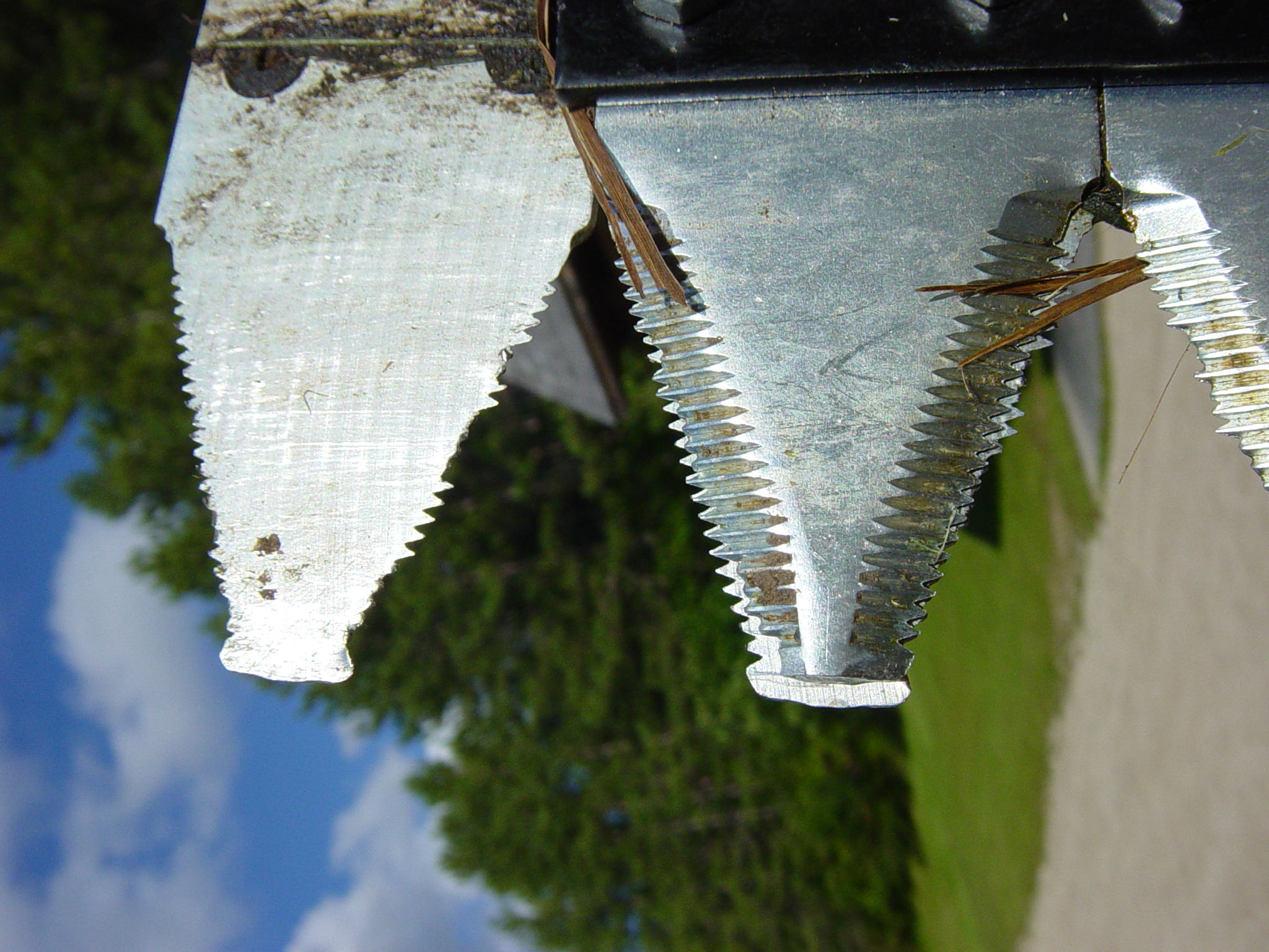

I wasn't too thrilled that my knives were buggered after half an hour or so of trials, on hardwood branches of smaller diameter than claimed. At that point, they were in no condition to cut grass and weeds any more.
The jury is still out as to whether this was a wise buy or waste of money. But, I don't really have a better (or cheaper) alternative.

It sounds like the knives on the cutter bar are dull/nicked and no longer sharp enough to cut grass.

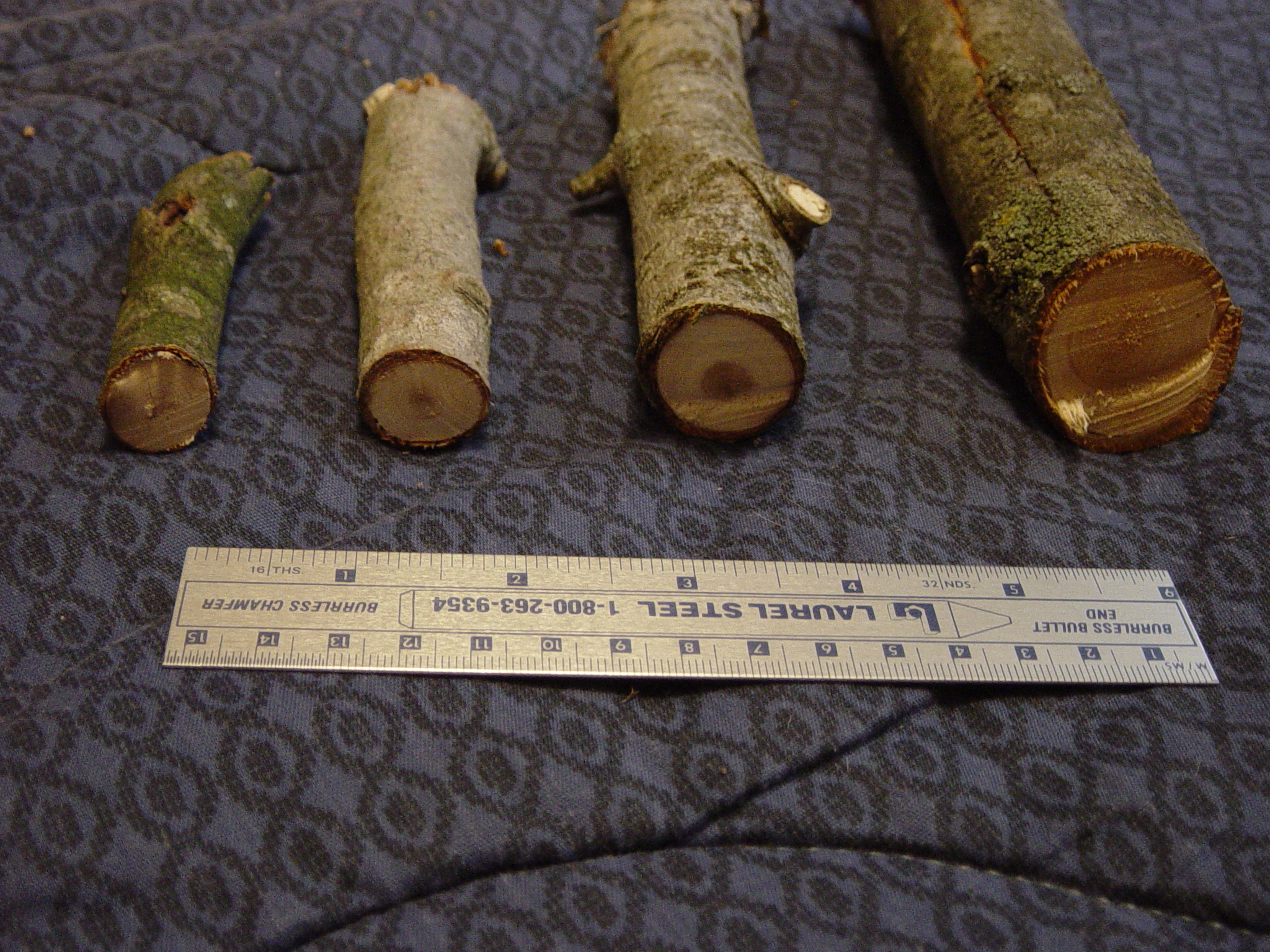

I am trying to locate the pictures of the wrecked knives, from cutting branches that were within spec for twenty minutes.

Found some pics.
Was NEW about twenty minutes earlier!
Collected the heaviest of the branches off the ground. These were very much in the minority, with the majority being very small branches.
