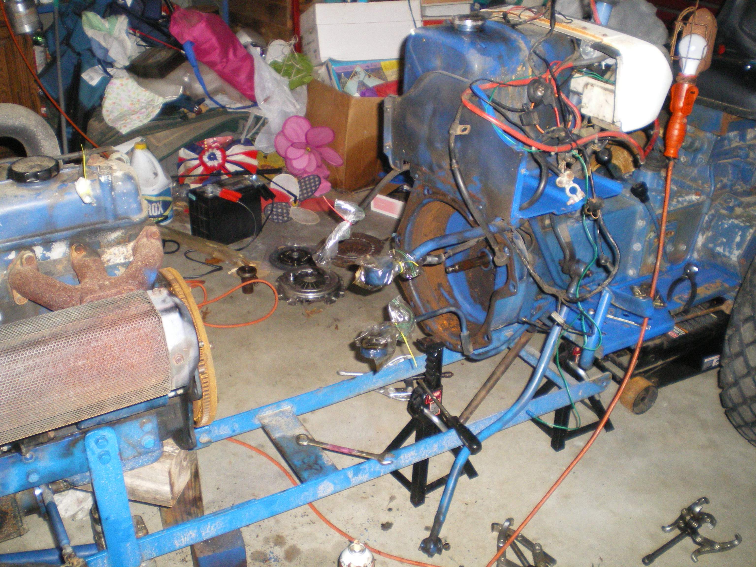

Working on Son-in-Law's Satoh Buck Ser S470D-02861. Looked at different forums on topic, but one more check before I undertake the unpleasant task of splitting the tractor. The clutch pedal moves freely, but very little/no resistance. Clutch is engaged. Grinds when try to put it in gear with engine running. Can shift gears with engine off. Tried pulling and braking but didn't want to put it under too much stress and break something would regret later. No repair manual. Looks like throw-out bearing gone and need to split? See several have split their tractor, any instructions out there on how to do it? Thanks for the input/help.

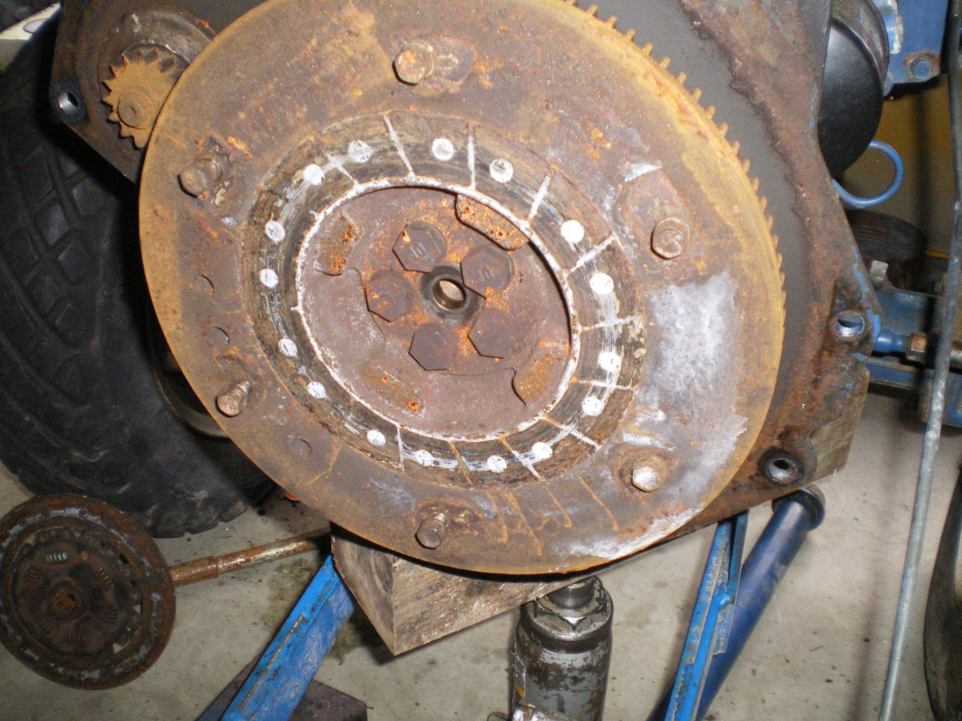

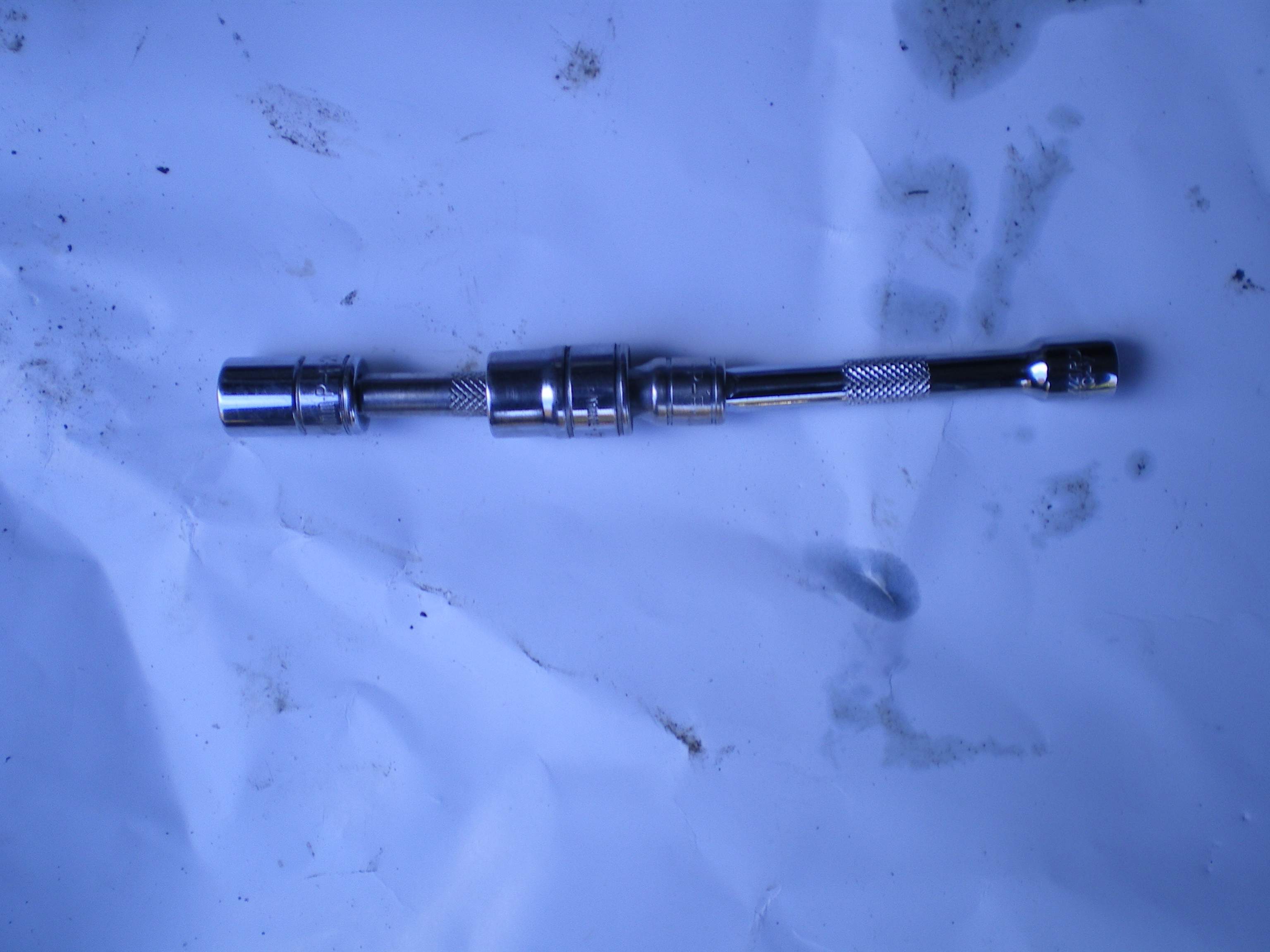

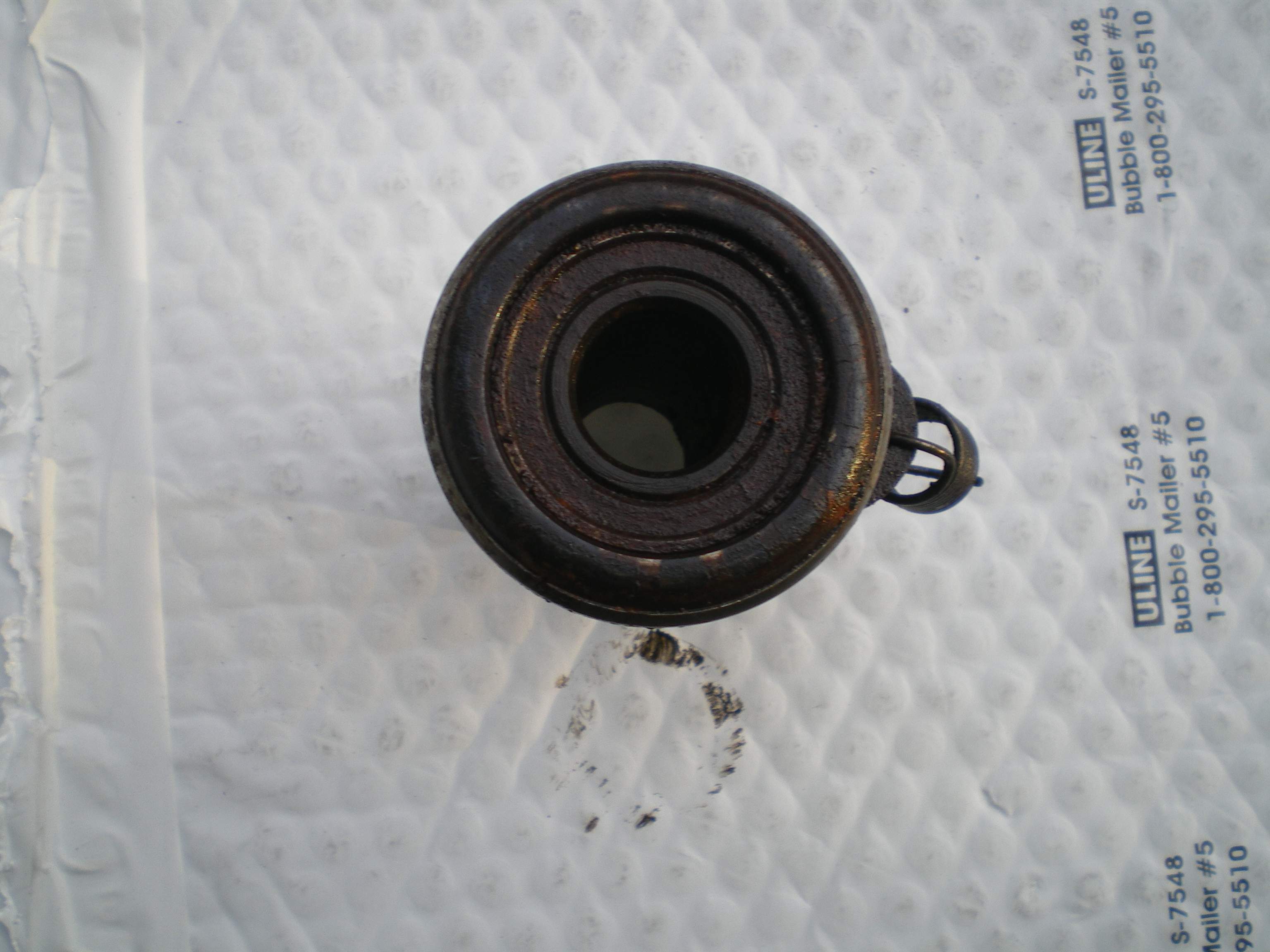

Thanks guys for you input. Took me most of the day to split and replace clutch and bearings. But an interesting project. Hopefully don't have to do this again real soon. :) Will attach some pics if I can figure out how.

/ S470D Buck Clutch Problem #16
Boy, that was a lot of rust. Glad you got it done.
/ S470D Buck Clutch Problem #17
Yeah looks like you made the right call...bet it works good now.

I am assuming that the collection of sockets/extensions is your alignment tool.
Did you have the flywheel resurfaced?
