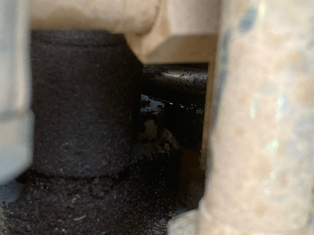

machine has around 1500 hrs on it. after using a grapple bucket a bit i noticed fluid coming from the front right foot hole area in front of machine. after searching i found the control valve assembly on right side and noticed a drip from the bolt head under the solenoid so i took it out but all the o rings look good? now i am wondering if the solenoid above is leaking?

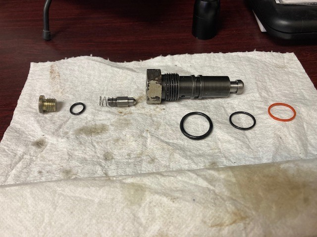

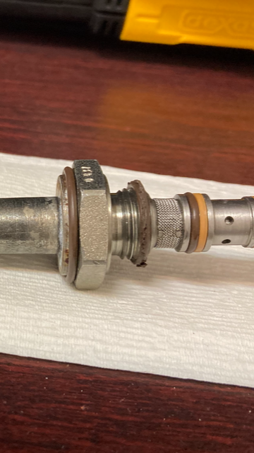

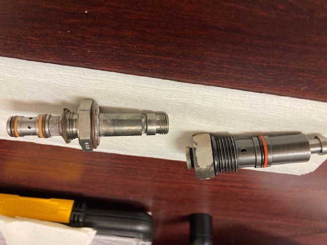

so i pulled the solenoid yesterday to check since i had stuff ulled off anyway.
the 2 smaller o rings on the shaft are good, the big o ring is hard and chipped/nicked and the outside o ring in the recess is loose fitting and nicked.
hopefully dealer has them in stock and they aren't terrible......

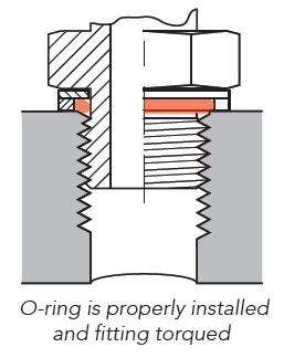

i think this is it.
   / s150 hydraulic leak
what really shocked me was that none of the treads had any teflon tape or pipe dope on them and only relied on the o rings.....

got it- thanks.
now to find the new o rings-
i can only find a whole new stem but not replacement seals....
   / s150 hydraulic leak #7
any hydraulic shop, bearing supply can find O rings, we have a local bearing supplier that has found us some odd seals over the years, check the local supply guys out
