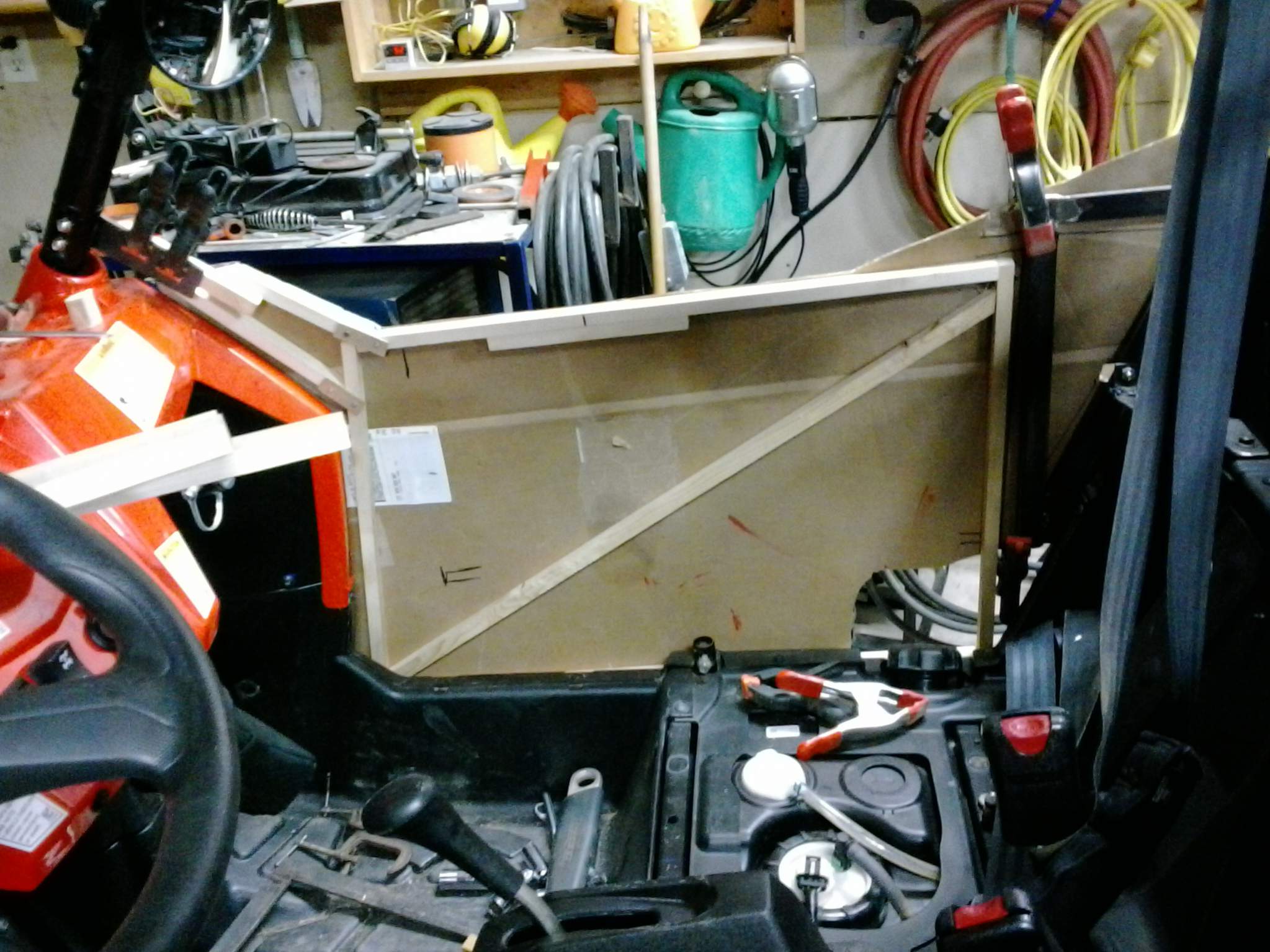

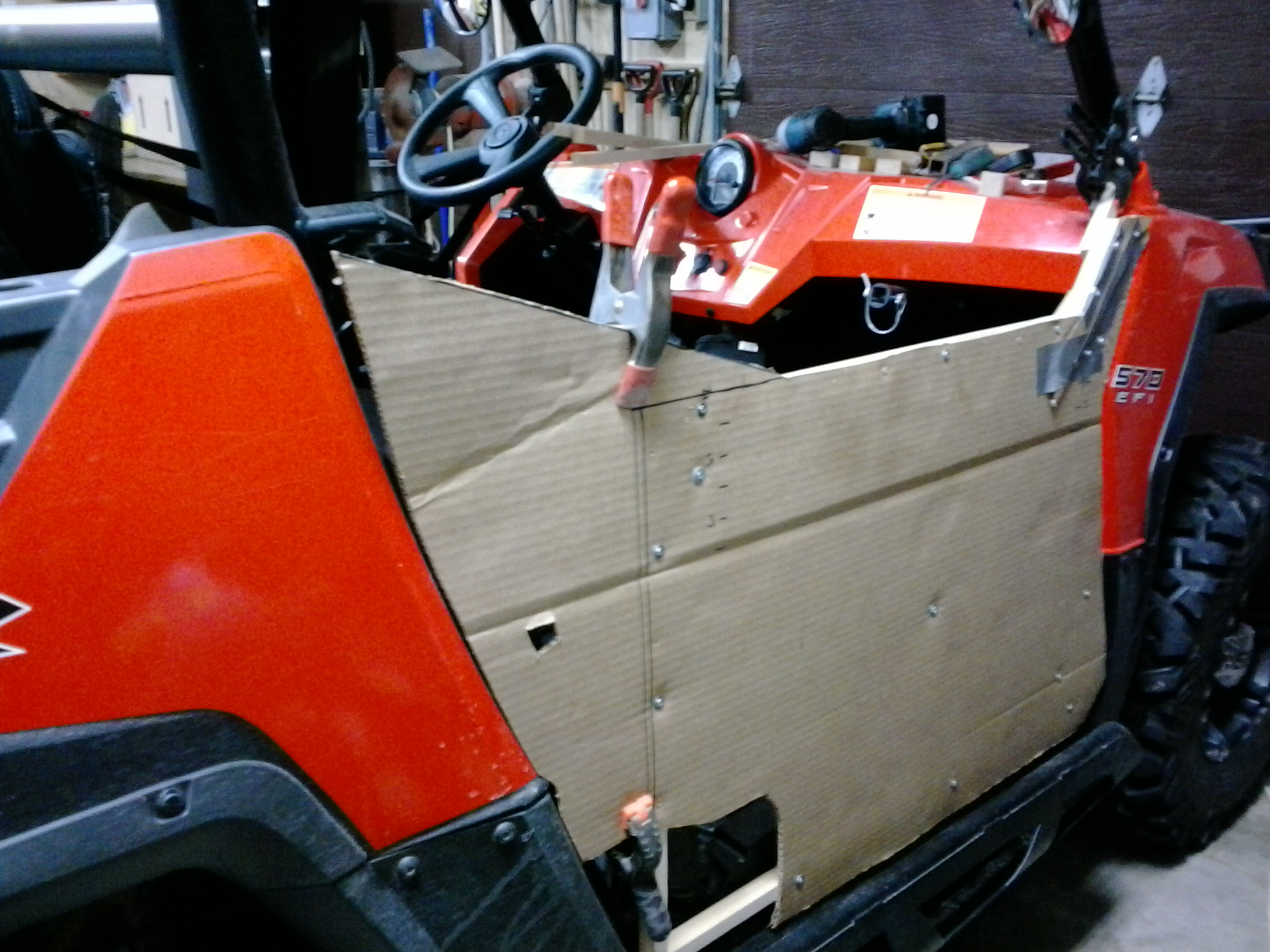

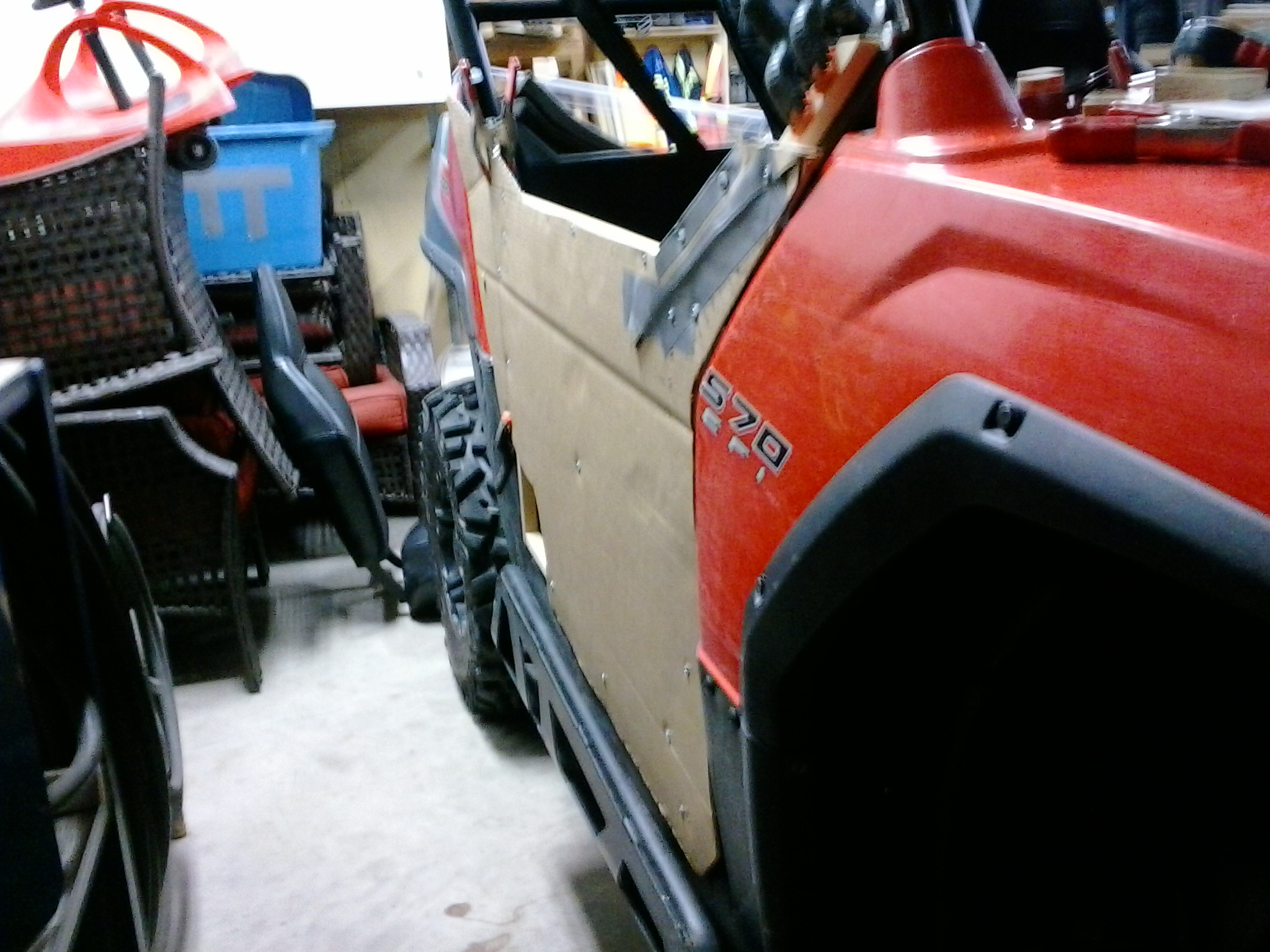

Any one here attempt to build their own doors for one of these machines. I want to try and build a set for my brothers RZR? Looking for any tips or insight. This is the first mock up.
Thanks
Steve

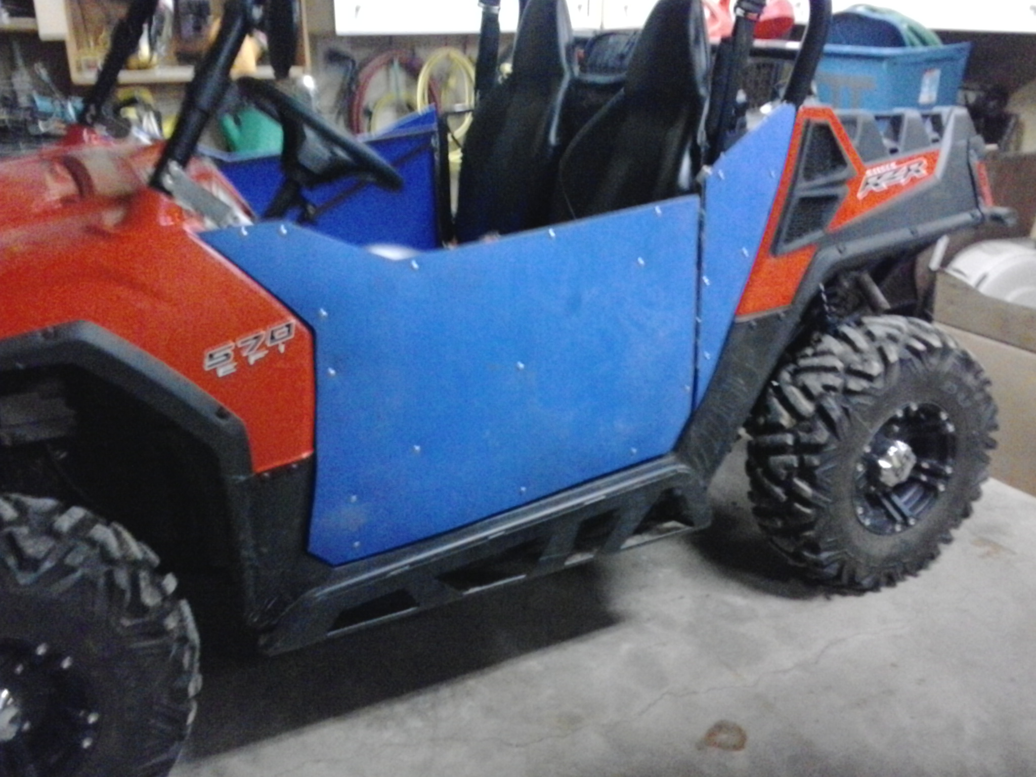

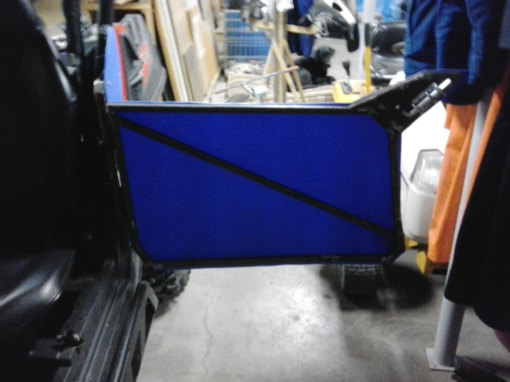

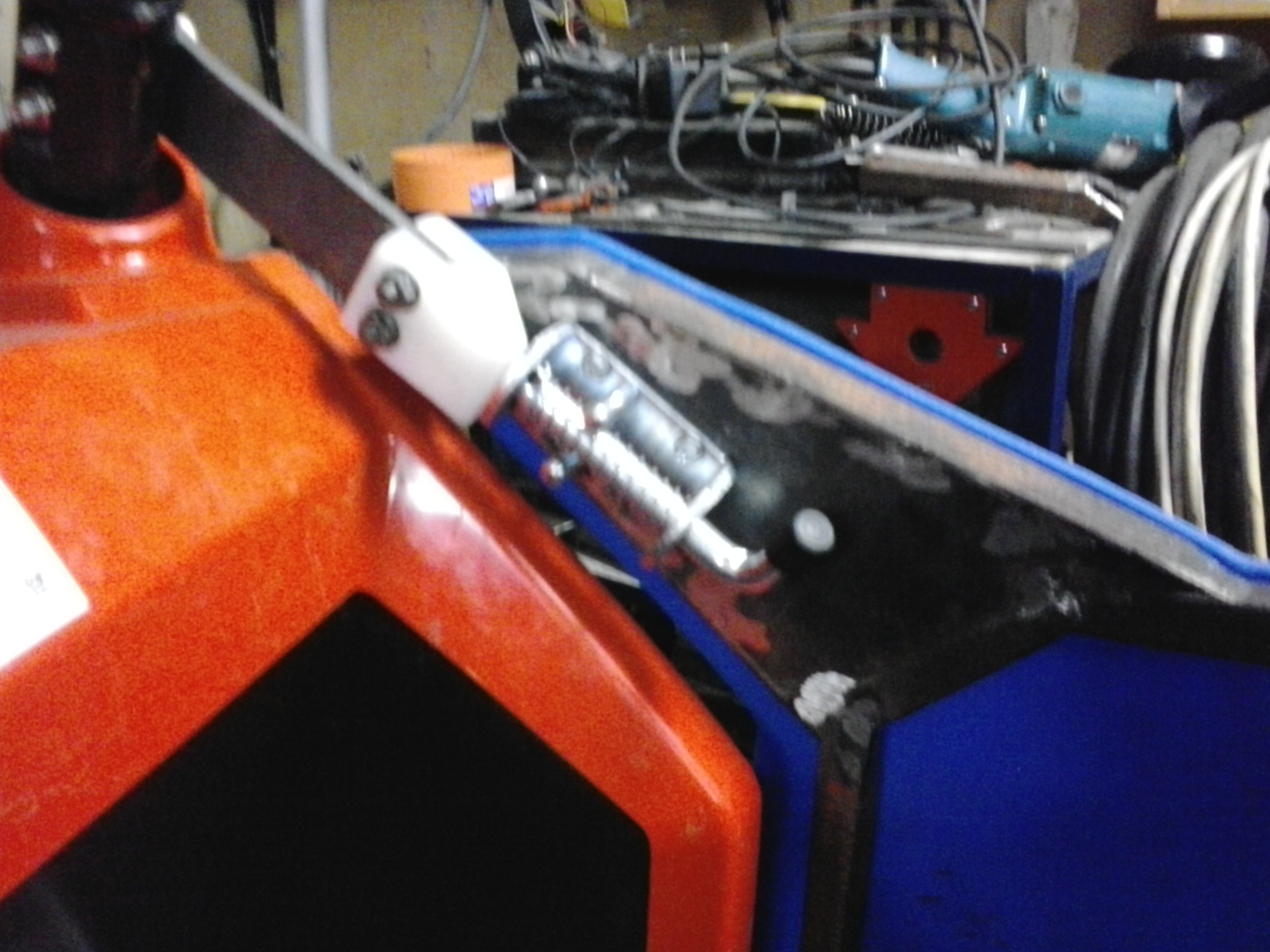

Here are the doors skinned with a 45 gallon drum. they are slip on/off hinges.
Steve
