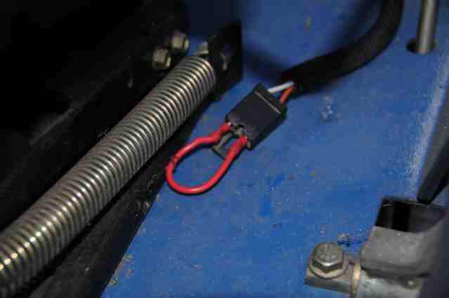

As for the seat switch issue, that’s why on my NX I did redo the seat mount to defeat it. All other safety switches are still in use.

A few different ways it can be done, the most common way is to unplug the wire connector from the base of the seat and install a jumper wire to complete the circuit.
This is another way a few have done, gives the best of both worlds with the flip of a switch.
http://www.tractorbynet.com/forums/kioti-owning-operating/357076-nx-safety-seat-switch-mod.html
On mine I did a different way, on mine the seat cushion is held up off the switch with two springs under the front two bolts holding the seat cushion , I just removed the two long shoulder bolts and replaced with short fully threaded ones that when tightened holds the cushion down against the safety switch.
