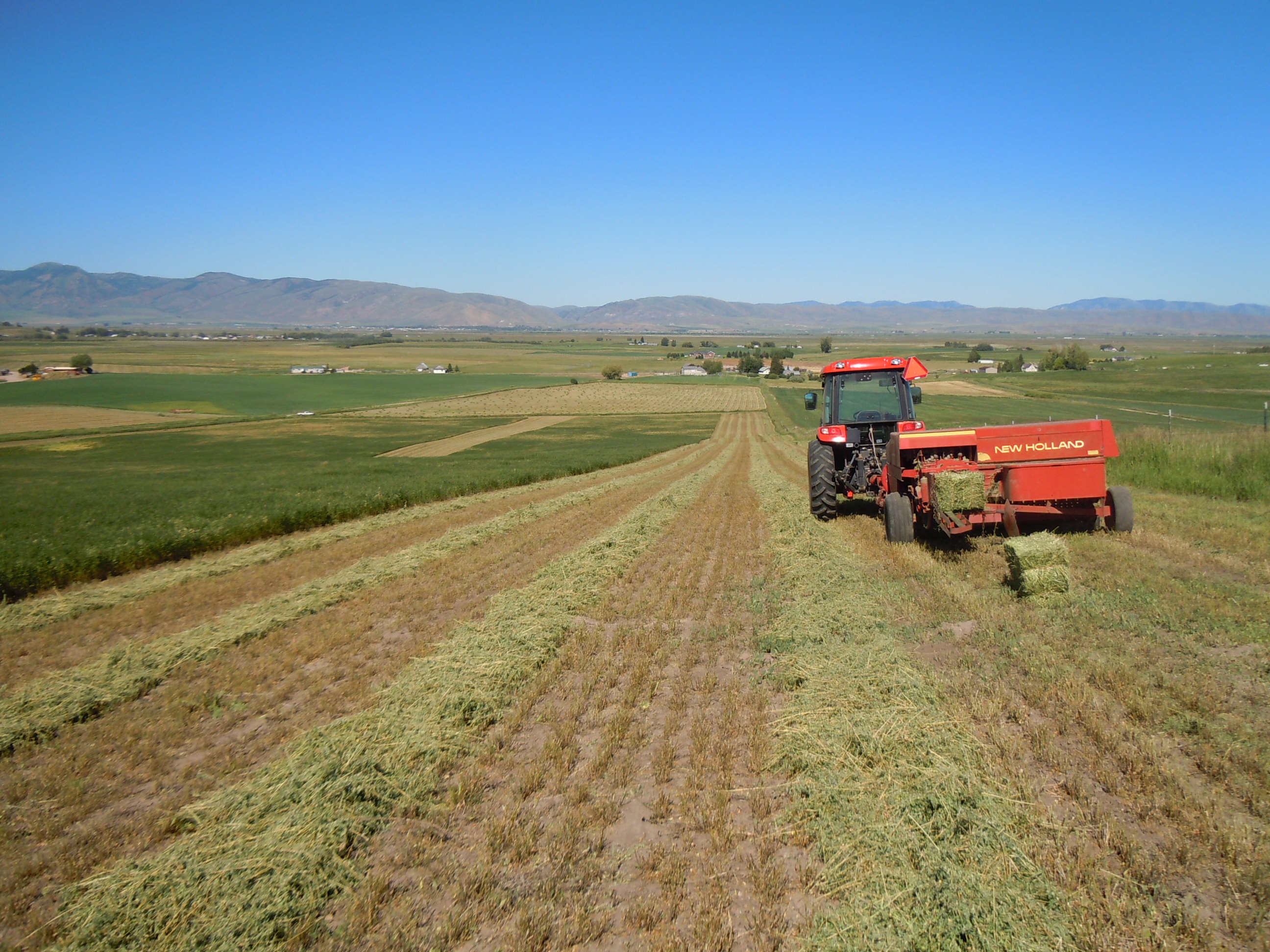

Do you run a baler with yours? If so, what kind of baler are you running and how does your tractor handle it? I'd like to be able to borrow my neighbors round baler, but I think it might be a bit of wishful thinking on my part. I do not recall for sure what his baler is, but it builds nice firm 1600+ lb round bales and net wraps them.
   / RX7320 problems @7 hrs on the meter #109
I only run a small baler NH316 and it works just fine.

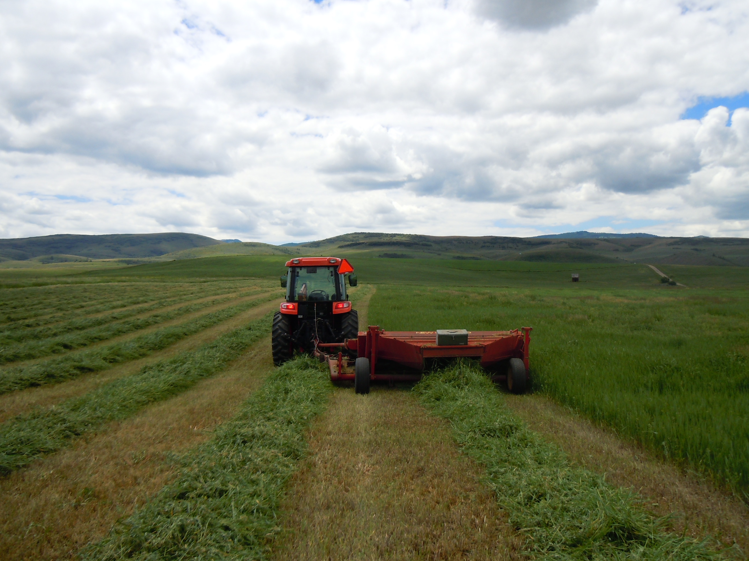

   / RX7320 problems @7 hrs on the meter #110
NICE PICTURES.
