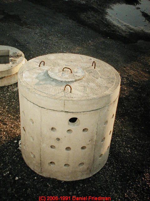

Something like this would work good for a dump station no bottom in it and you could back fill with drain rock within a ft. or so of the surface. Often a septic tank isn't in a convenient place to get the RV near a clean-out. It would last many years before needing to get pumped.
Billrog that concept has some definite possibility. At the risk of sounding totally stupid, what is the common trade name of that illustrated dry well? I have a local concrete company that makes a lot of precast stuff so I guess I'll make a few phone calls. Thanks.
As has been suggested, tapping into the existing house septic system would be simple but the RV landing pad is about 50 yards from the house and is separated by fairly deep valley.
