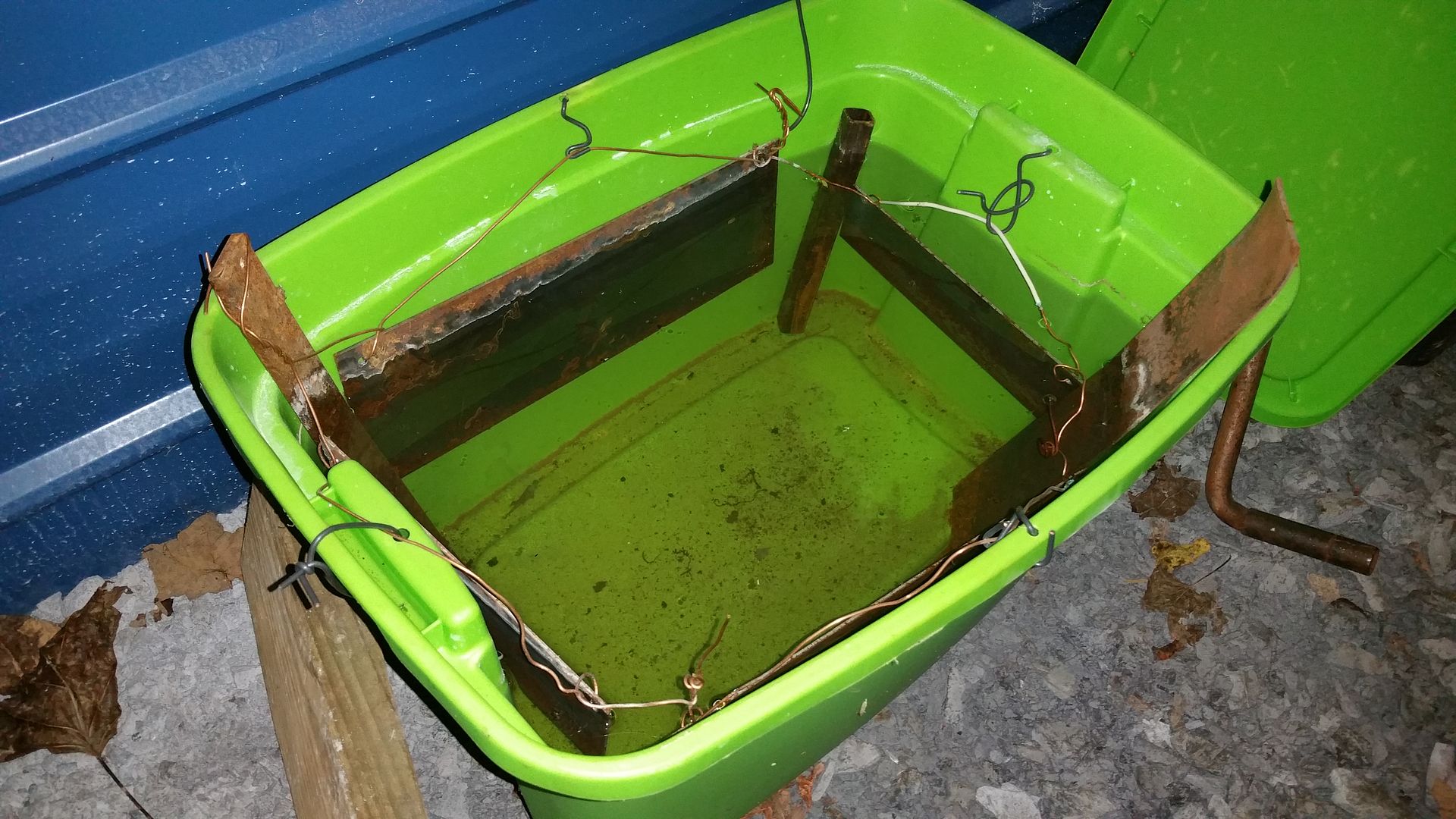

Crashy, please tell us what you de-rusted, and did you use straight vinegar?
Main thing was a pair of fence pliers, joint was frozen solid. Could not even hammer it open or closed.
Just pure white vinegar.
They now work real well, Lots of other stuff in the can (plastic bucket. ) it only took a couple of days & they were about done. It still seems to be working, bubbles now & then. Will change it when no longer making bubbles.
Will pour it on a weed & see if it dies. It should be good for the soil with all the iron in it.

I just restored an old Griswold cast iron waffle iron. It was so rusty I had no idea if it was even good still or not. I just put it in a bucket that was about 75/25 distilled vinegar and water. About 3 days in the solution was bubbling and turning foamy with the water being rust color. I pulled it out and was amazed what a treasure I found. Couldn't even tell the thing was over 100 years old.
If you have the time, vinegar and water works wonders and it's non-toxic.
Gave this mix a try on some heavily rusted trailer spring u-bolts and plates. The pieces soaked in the solution for 3 days and no more rust. They still needed to be wire bushed to remove a brown film. Works great!

It seems that white vinegar works the best. It got pretty well used up, Had some other & used it. Seems to be slower but still works.

agree with white vinegar, I usually put the parts in a bucket of water with bakng soda in it for a 1/2 hour or so to neutraiize the vinegar then oil.

Warning.!!! I got busy & neglected the tools for a few days, once rust is cleaned up,the vinegar starts to build up rust that will barely scrape or brush off. Now what????
