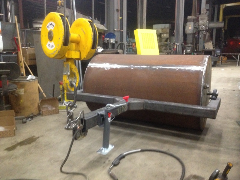

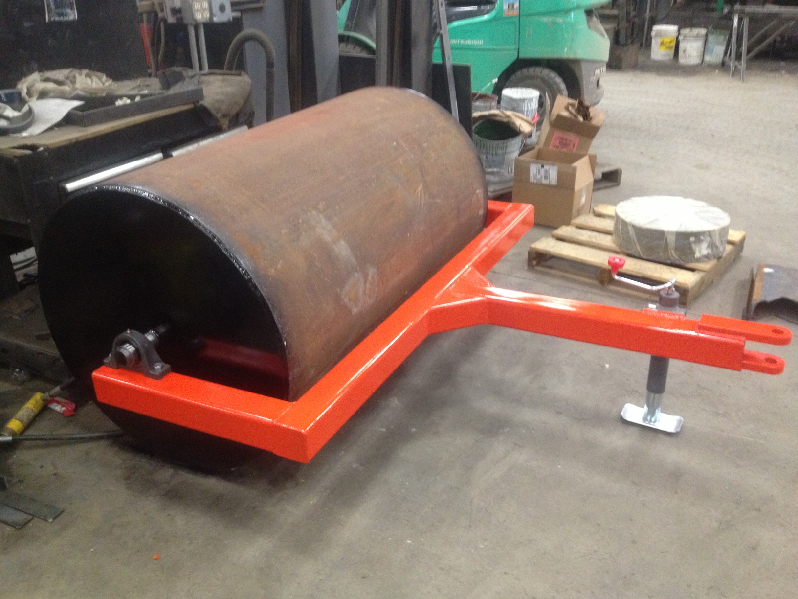

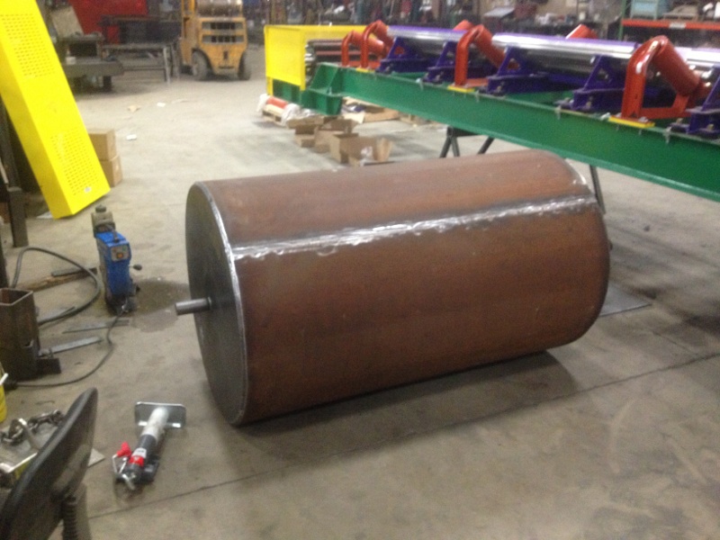

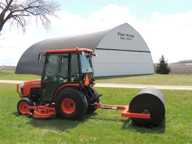

My scrap bin Runway Packer Project heads for the paint booth this morning. :thumbsup:
   / Runway Packer #2

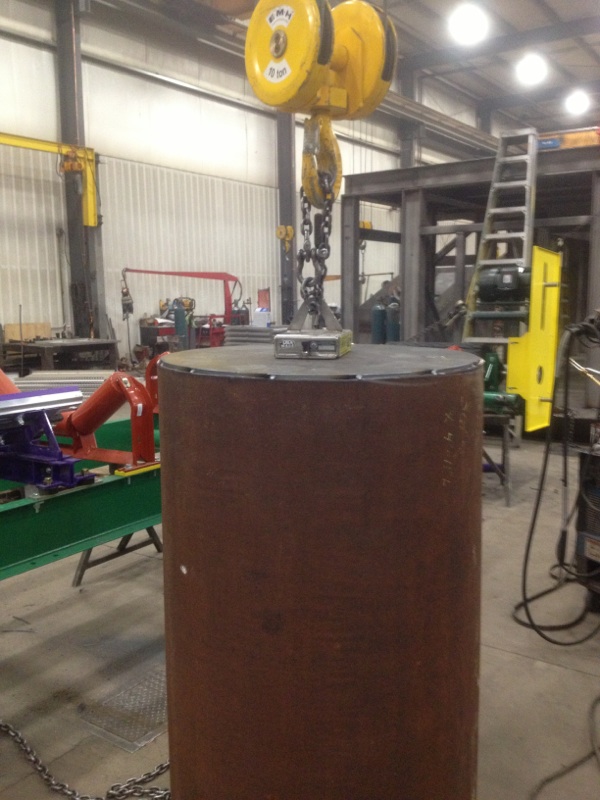

You've got a nicer scrap bin than me! Good work, far beyond many of us here. How did you make the drum?
   / Runway Packer #4

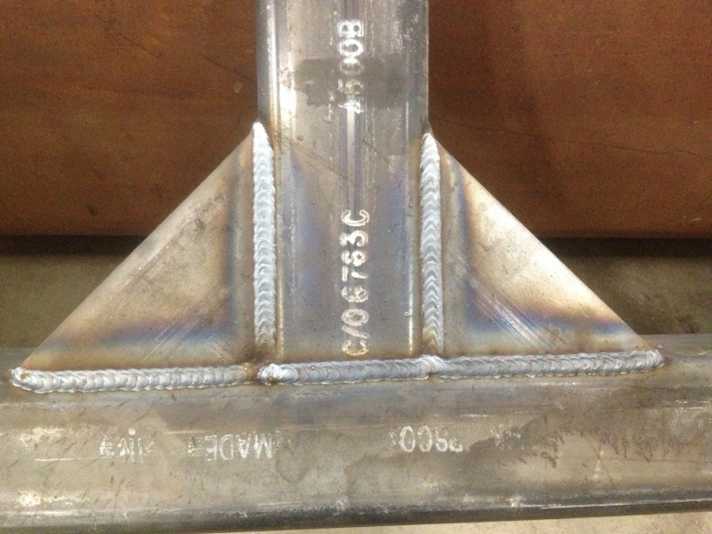

The last pic , MADE? You certainly have a nice scrap pile , and garage .
   / Runway Packer #5
Nice job, much better than mine! How much does it weigh dry? I filled mine with waste antifreeze from my local John Deere/Kubota dealer. It sure beats draining it every year. What is the width of your roller? Nice welds. Mine weighs about 1.5 tons filled and works pretty good. I have a homemade aerator as well that works with a 3 point lift. It does not plug, but I am not changing it at this stage.
   / Runway Packer

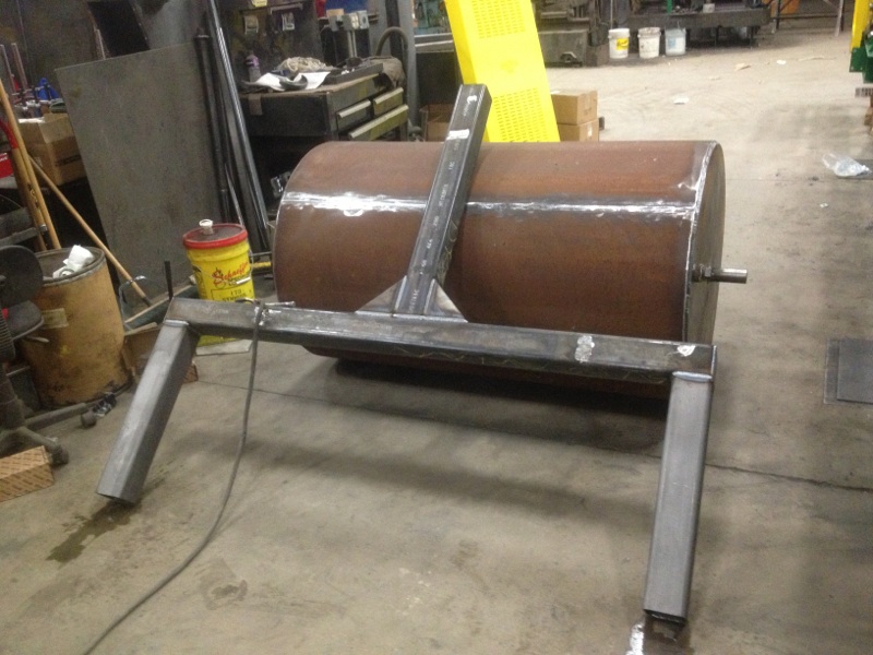

148871_417342324993305_1247691861_n.jpgCould have plate rolled it, but found a 3/8" thick 36" dia. sewer pipe. Total empty weight 1200. Thanks for the used waste antifreeze idea.

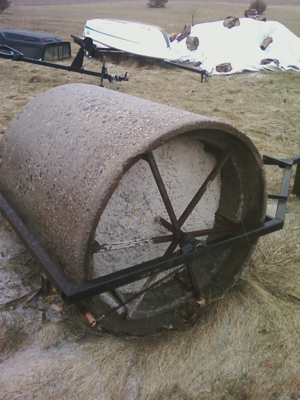

Here is a couple other roller packers I found at other private grass strips.

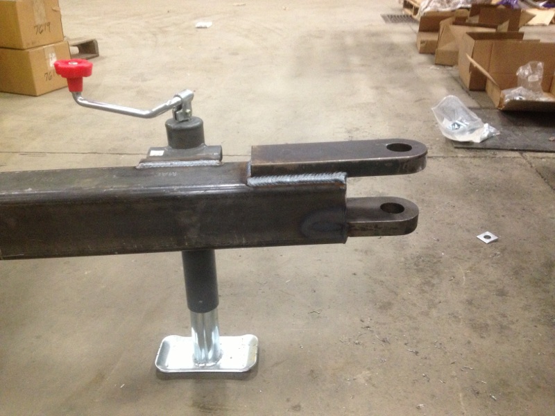

Really nice. Not all scrap bin though. I see a brand spanking new trailer jack on it. :)
I would weld my name in a cursive protruding bead, Mirror imaged (backwards) so that it stamps your name on all your work when rolling dirt. :)
   / Runway Packer
Hitch Jack & Bearings are new....

:cool2: Kubota Orange !

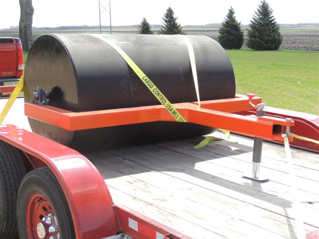

That looks great. So that will hold about 400-500 gallons? Somewhere between 4000 and 5000 lbs when filled including the dry weight?
   / Runway Packer
#12
Down to the Gnats ***...
Based on outside dimensions plus the 1200 pounds empty weight = 3406.38
