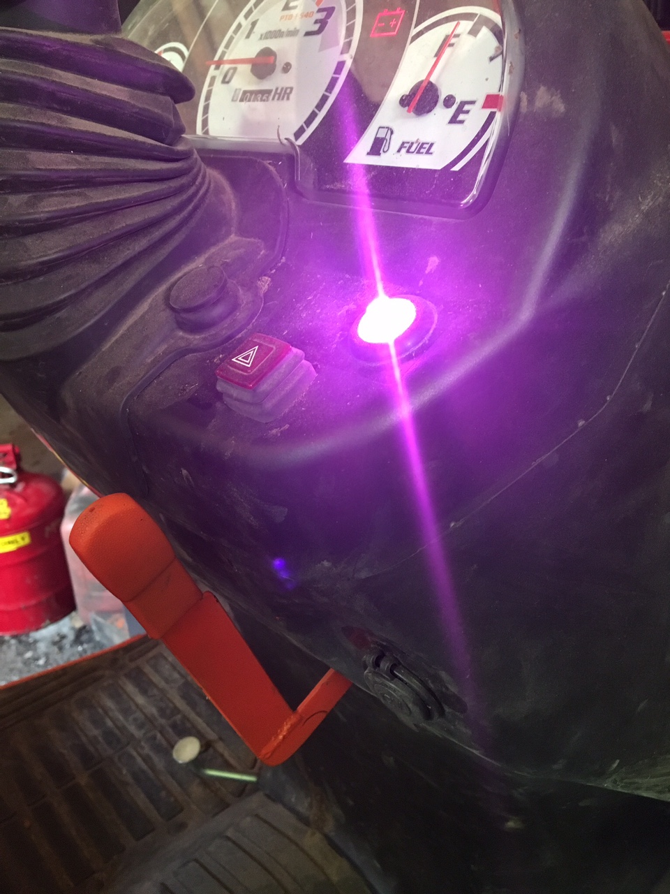

Made several modifications. Added a brake on warning light. Under the cowl there was already a metal bracket with hole for a motorcycle rear brake light switch. Only had drill a small hole in the lever for the switch spring. While apart welded an right angle handle extension. This brought the handle up and gave better visual indicator also. My wife uses it regularly and no more running with brake on. IMG_0487.JPG

You found a poorly engineered problem of lower horsepower tractors. Larger tractors have better visual indication of the parking brake actuators and a brake on warning lamp.
The parking brake on the B20 absolutely sucks and was hardly ever used. B26 made improvements but my wife did the same thing with a new tractor. While I set the brake harder and thus more noticeable, that tractor sees multiple operators. Hillside farm really need a parking brake.
Made several modifications. Added a brake on warning light. Under the cowl there was already a metal bracket with hole for a motorcycle rear brake light switch. Only had drill a small hole in the lever for the switch spring. While apart welded an right angle handle extension. This brought the handle up and gave better visual indicator also. My wife uses it regularly and no more running with brake on. View attachment 650263
That's an excellent modification, thanks for sharing it. I haven't examined things in detail, but the amount of disassembly needed to repair the brakes is probably extensive.

/ Running with the brake on? #20
