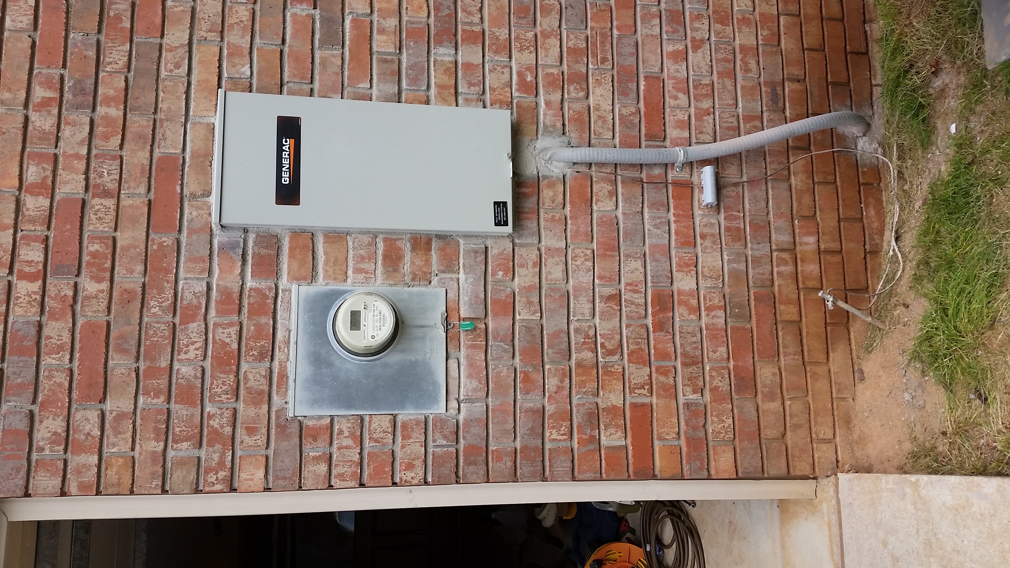

I have a 60 amp circuit that used to go to the oven but I changed it out to a new propane model.
I'd like to use this for my run to the barn if it is suitable. The wire is 6/2 with ground.
Otherwise I'll have to expose some conduit from the breaker box that I'd rather not have to do (for esthetic reasons).
The barn will just have duplex outlets and 4 - 4' LED lights.
is the 6/2 OK to run to the sub panel in the barn?
The length of wire (if I tap into the old oven circuit) would be 189 feet, from start to finish. If I run a wire directly from the main panel to the barn it would be 160 feet or slightly less.
I was wondering if I put a ground rod just outside the wall of the sub panel it might pass muster.

I think your run is a little too long. 6 gage for 60amps is a maximum of about 10 feet. You can go further but you’re going to start getting voltage loss. Either way you’re no where near the run that you want. I think you’d be better off swapping out the breaker for 20 or 30 amps to limit the load to something within spec.

The wire size calculator says you need #4 copper or #3 aluminum for that run.

I assume you're running new wire to the barn. If you want to keep the 60 amp breaker, tap into the circuit and run a #4 AWG to the barn. The existing first 20' of #6 AWG in the circuit won't hurt your voltage drop. Or if you run direct from the panel (and want to keep the 60 amp breaker), use #4 awg all the way.

This is similar to what I did to my barn several years ago. I ended up running #4 THHN-THWN cable in conduit (1 white, 1 black and 1 #8 Green) out to the sub-panel in the garage off of a 240V 60-amp breaker in the main panel in the house.
Is your 6/2 wire rated for underground feeder (UF-B)? if not, you'll need to run it in conduit out to the barn. In any case, as marchanna points out 6AWG is too small to run 180 feet at any amperage for a 120 V circuit.
The Oven breaker is probably a 240 V breaker, however - in which case the 6/2 will get you out to as much as 188 ft with the max 3% voltage drop

Because voltage drop is controlling, you can still run the existing 6/2 to a junction box where the heavier wire is spliced in. You would need to add a neutral and ground because the barn would be a subpanel.
