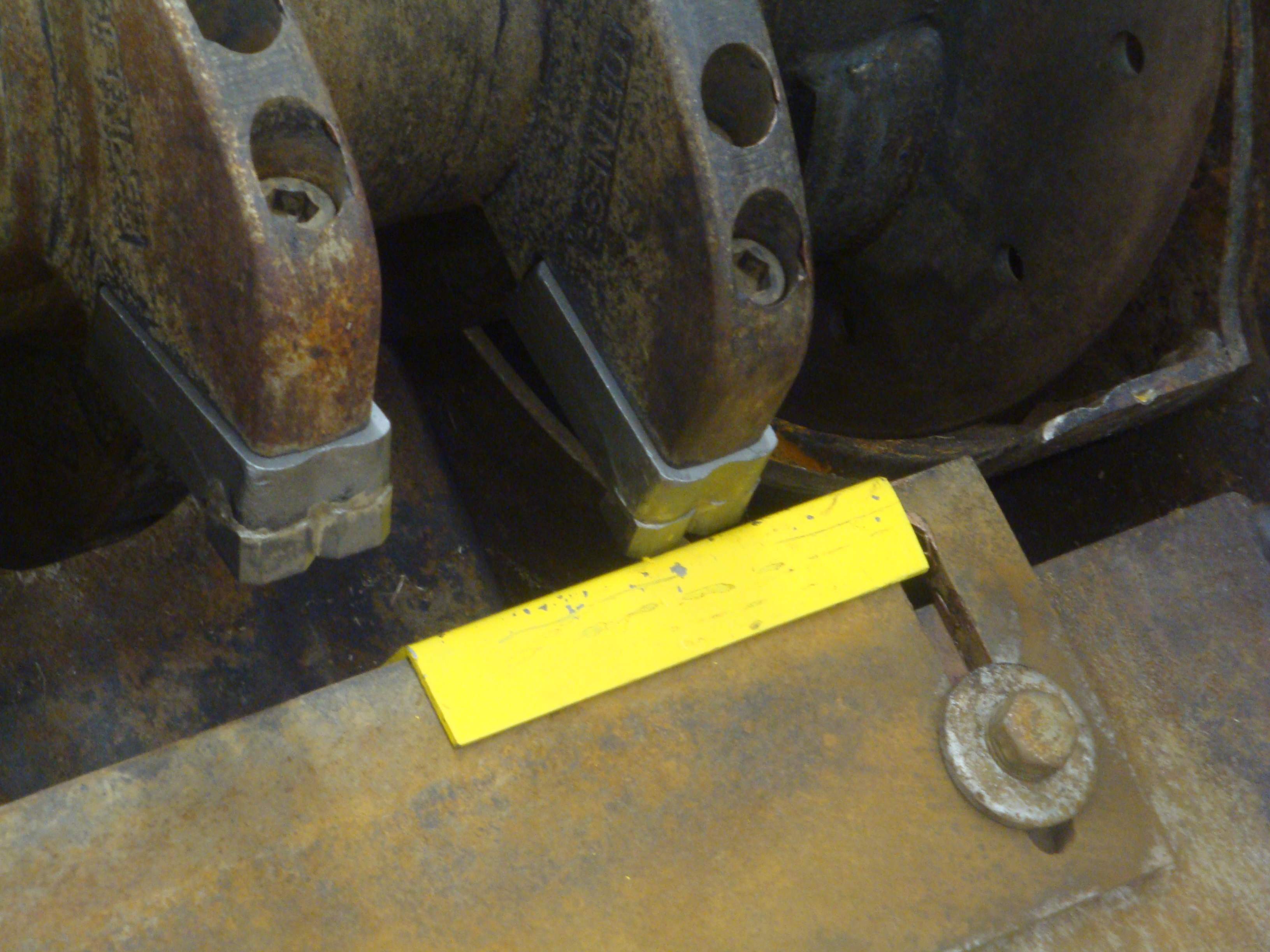

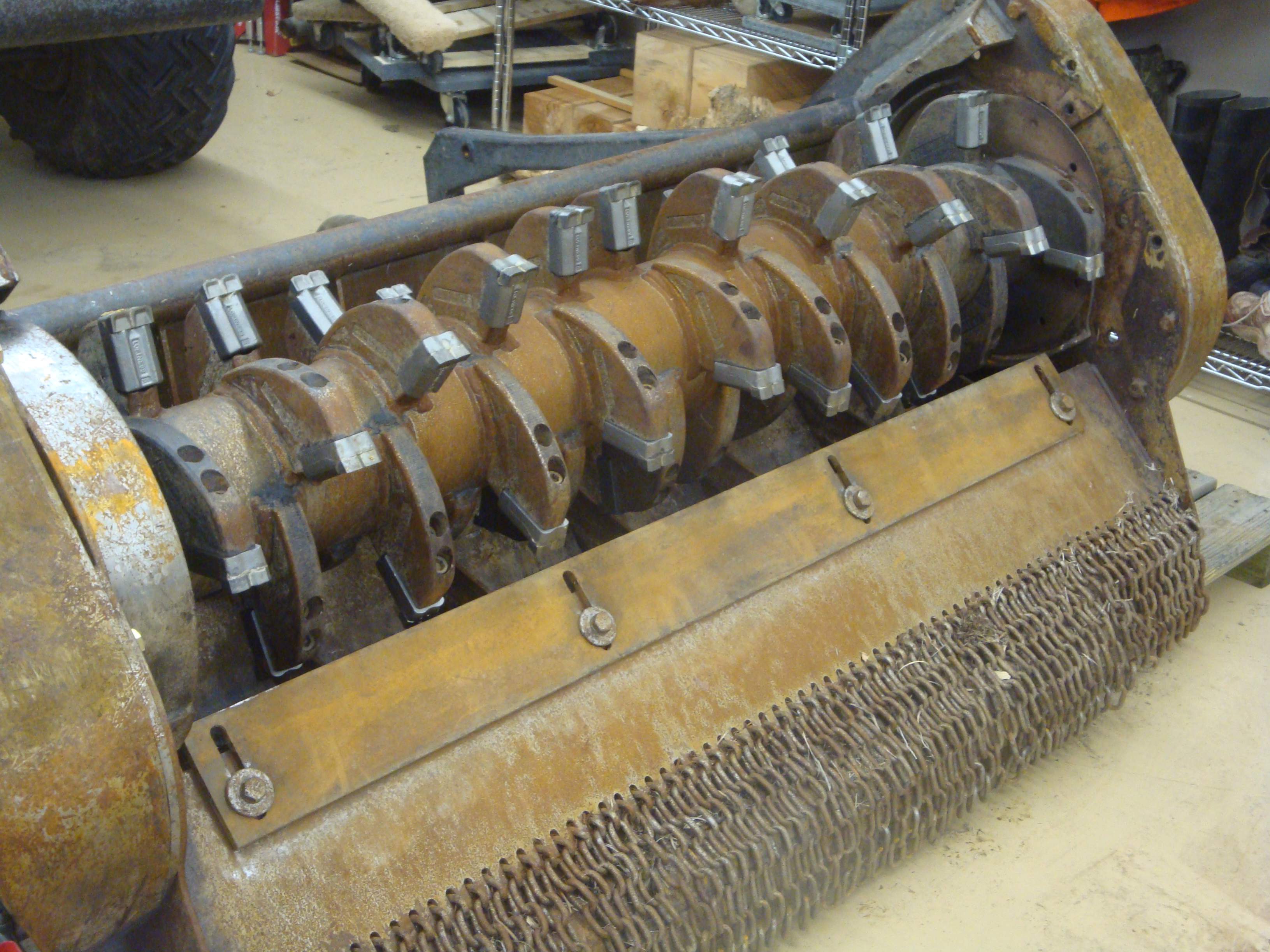

Think twice about the Planer Carbides.
I spent a lot of money swapping out standard carbides for planers and results are disapointing on my Loftness Carbide Cutter. I have less than 100 hours on the new teeth and half are fractured and broken. The Standard Carbides lasted 700 hours without a single broken tooth. King Kong Tools is the OEM supplier for Loftness. The response from Loftness was "planers are best when used in areas where geology is entirely rock and stone free- a Carolina sand beach for instance." I don't have any rocks, only average vegetation that would be expected for any mulcher. The drum is now out of balance with broken teeth. Without material in the drum, the vibration is noticeable.

I tried running both but it never would balance right on my Rayco c140 tried serval different ways I got it close but there still was a slight vibration in the drum ran it anyway because I was feed up with moving teeth around. After bout 50 hrs of running it like that my bearings went out, so I run chippers all around then when I need carbides for a job I just change them out. The quadco system will take your bobcat head from a two bolt tooth to a one bolt tooth so it pretty much cuts. Changing tool time in half, my Rayco has the old Fae two bolt drum before I installed the quadcos it took my 45- an hour changing teeth depending on how bad the bolts in the tools were, to 20-30 minutes with the quadcos. I know a guy running them in the center of his cat hm415b head which is a fae head as far as I know he hasn't had any problems. Once my stock teeth ware out on my cat415hm I'm running going to try it.

I'm no expert by any stretch, but it seems the angle on the cutting edge should come to a sharper angle. The advantage to a knife you can sharpen is the sharp edge. All of the others I have seen have a angle similar to an axe.
