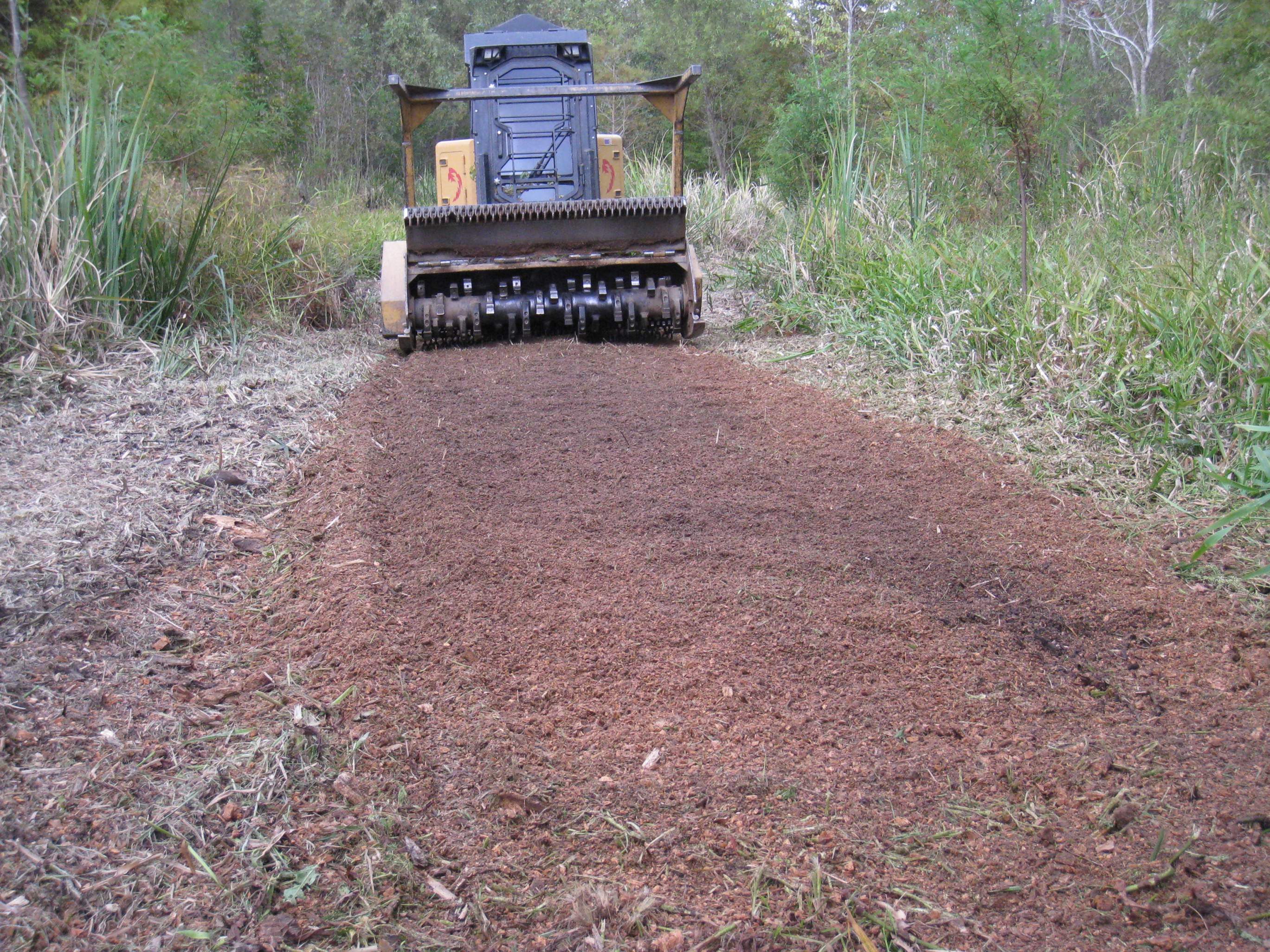

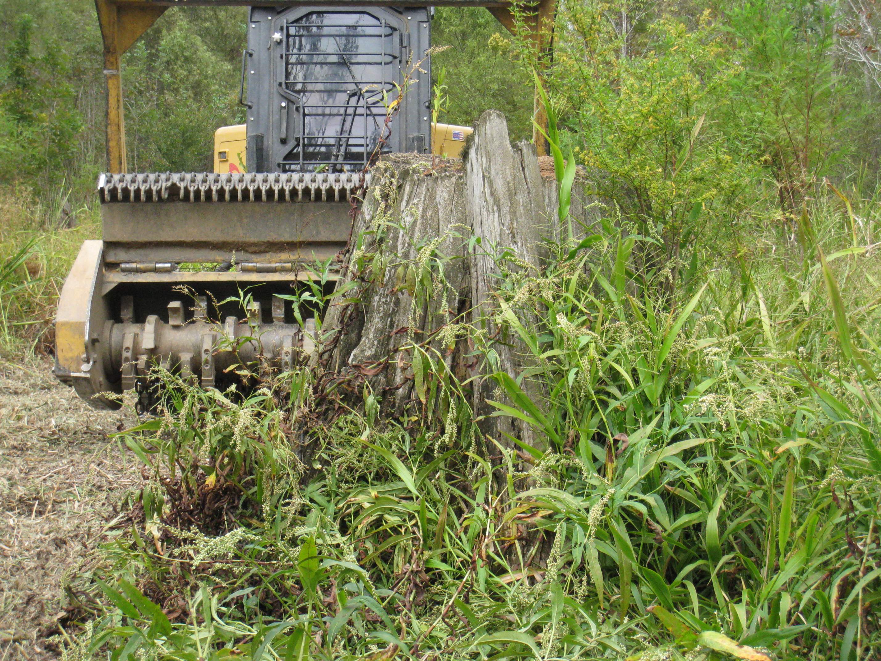

I've been using Quadco's Chipper teeth for 300-400hrs now, There awesome they're double sided much like bradco teeth I've been getting 60-70 hrs out of one side with me sharpening them 4-5 times. After that i just simply flip them over, The fae rotor on my Rayco is a 2 bolt holder the Quadco Holder is great because one bolt goes threw the Fae holder into the Quadco. Then there's only one bolt for the tooth it goes threw the Fae holder an the quadco to the tooth itself. A whole of alot better then Trying to remove 2 bolt per tooth. The pictures below are of a huge cypress stump that i cut in under 3 minutes with the chippers man wat a difference they make! An for u carbide lovers Quadco also makes a double tipped carbide for there holders that also are double sided.

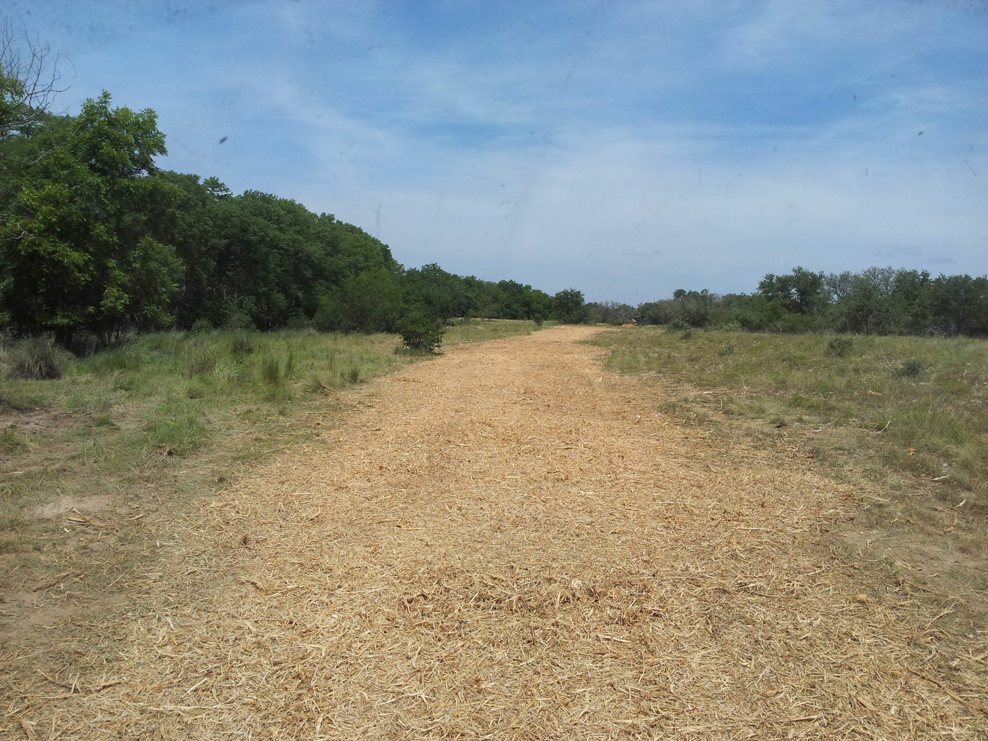

I try and try to get my shreds that fine. It's tough with carbide hammers. I've thought about switching to chippers but I work in a lot of areas where there can and is limestone and occasionally flint. I asked my dealer about running a few chippers with the carbides but they told me I'd have a balance issue.

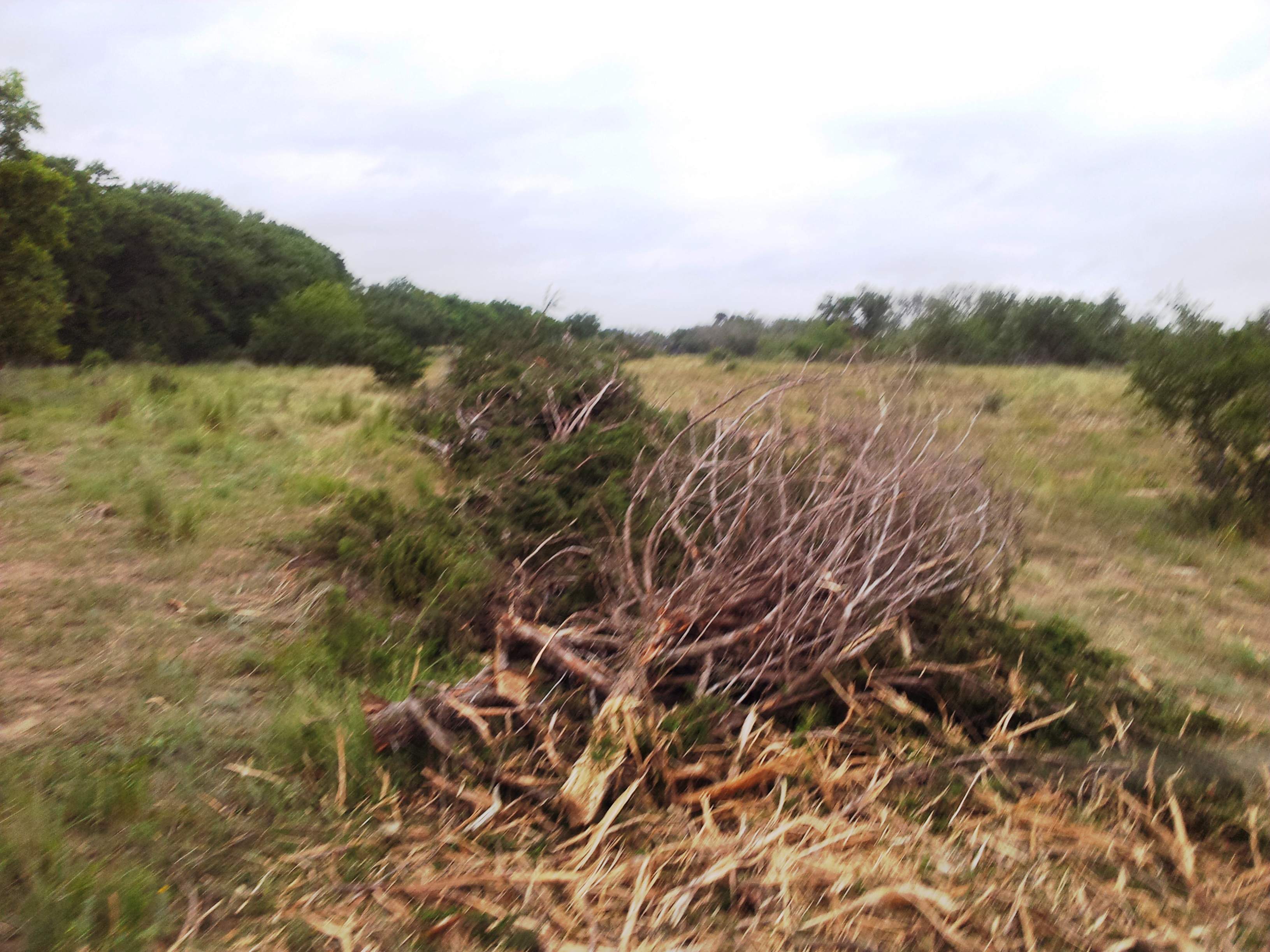

Here's some of what I do.. and I like it to look nice so the land owners can walk and drive without tripping over bigger pieces. I spend a lot of extra time trying to get it smoothed out just right. This area was about 900 ft x 10' of 4-8" cedar trees that I had sheared and stacked the day before. I was covering an old ranch road that had some erosion, rocks, and little vegetation.

Every Dealer will tell u will have a balance issue, but they have never tried it to know it will take time may have to rearrange the chippers several times to get it right but its possible. I have 18 fae carbides and 16 quadcos chippers on my fae and it runs fine had to just keep changing teeth round and final got it right, have had no balance issues.
