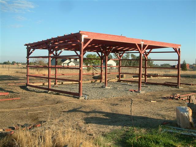

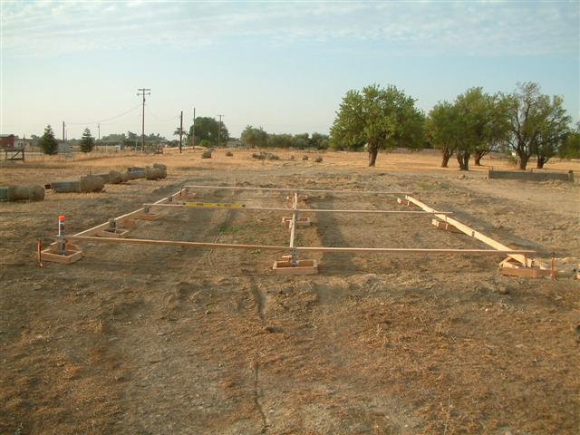

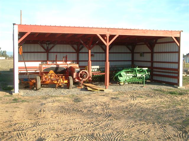

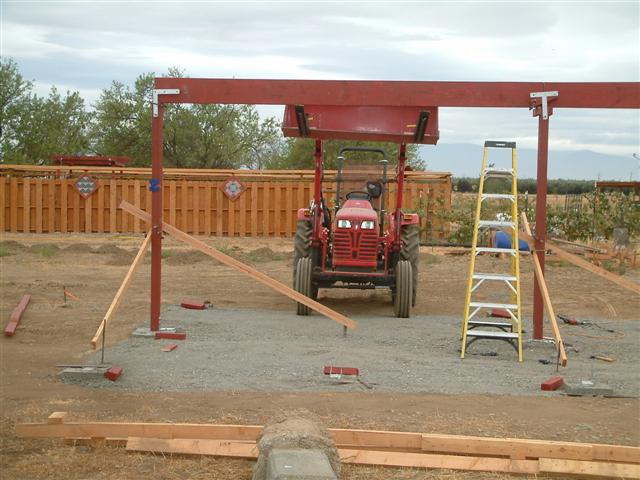

My 20 x 28 ft shed uses untreated lumber for the purlons, rafters, girts and beams. I painted all these members with exterior grade house paint mostly for looks. The posts are pressure treated 4x6 lumber.
Equipment shed posts-1.JPGEquipment shed-1.JPGEquipment shed-2.JPGEquipment shed-3.JPGEquipment shed-4.JPG
Good luck with your project.
