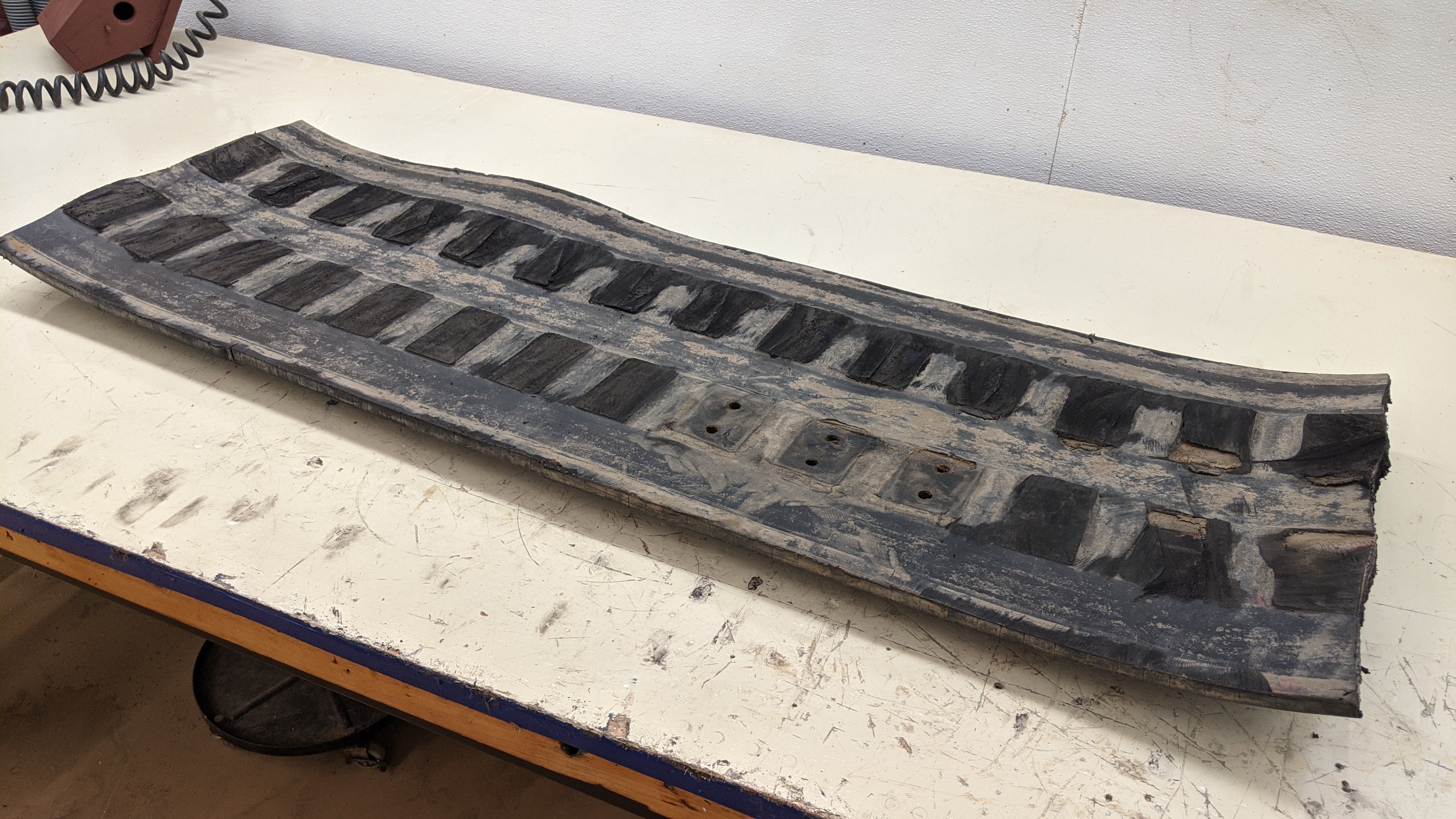

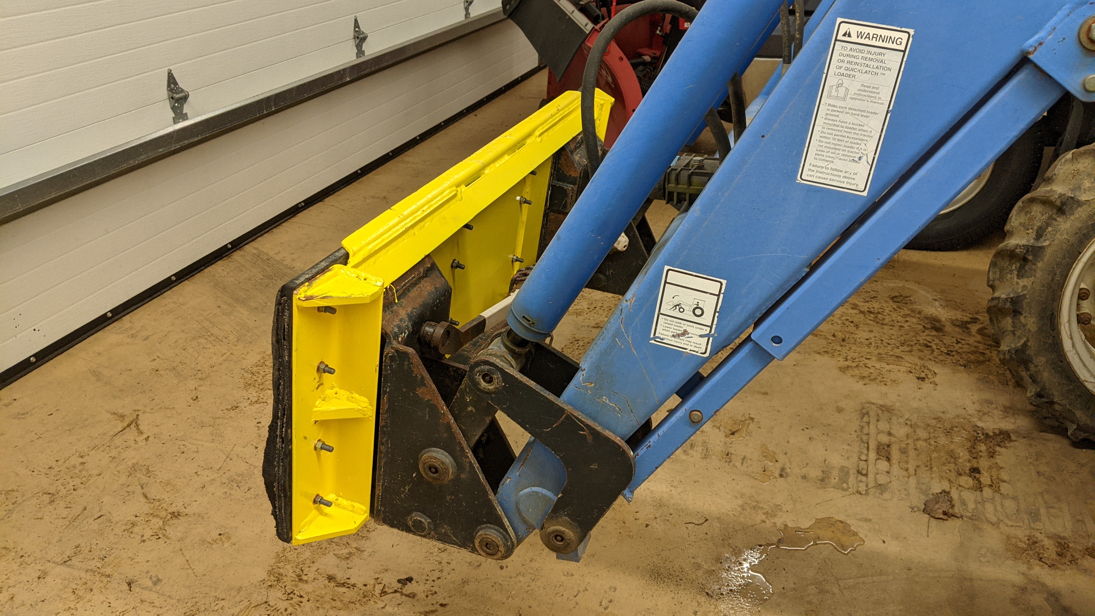

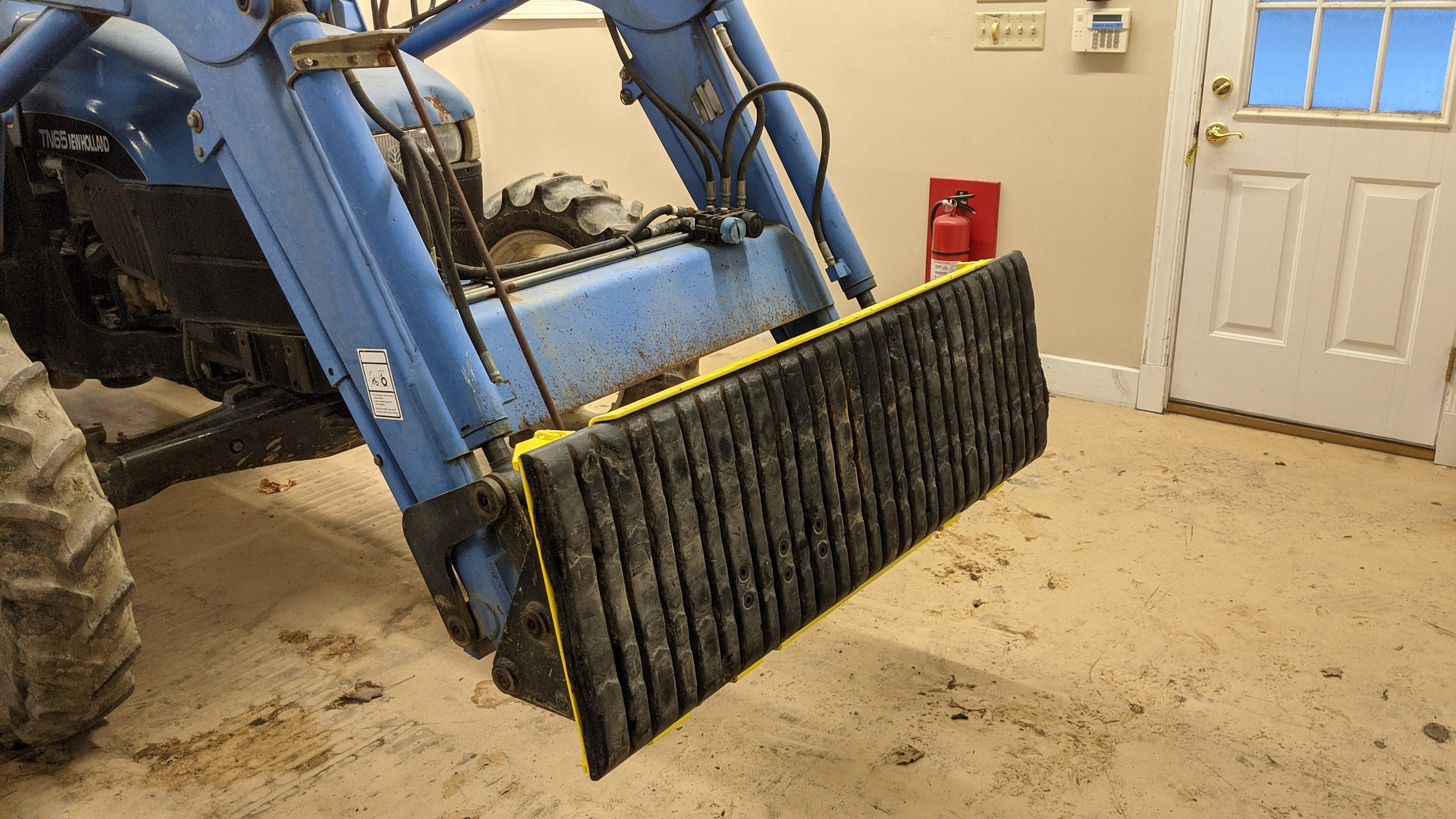

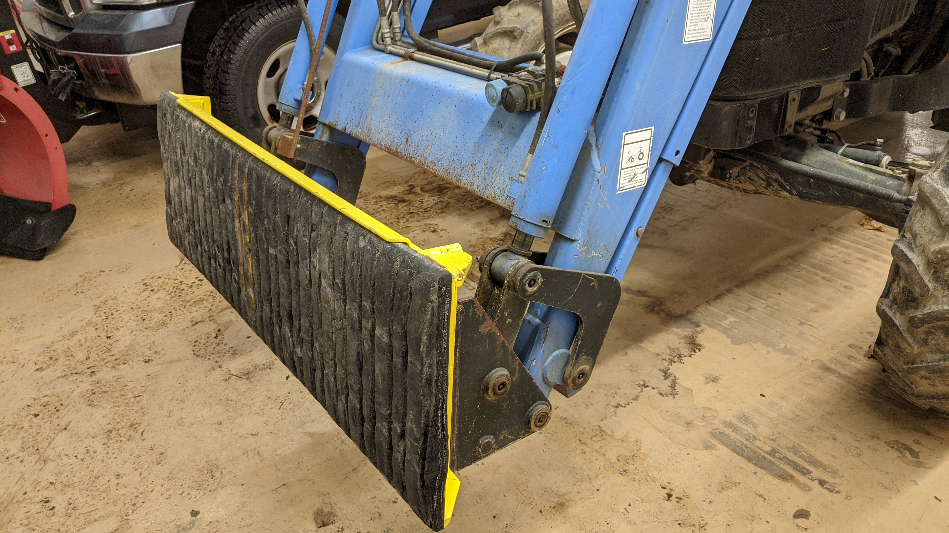

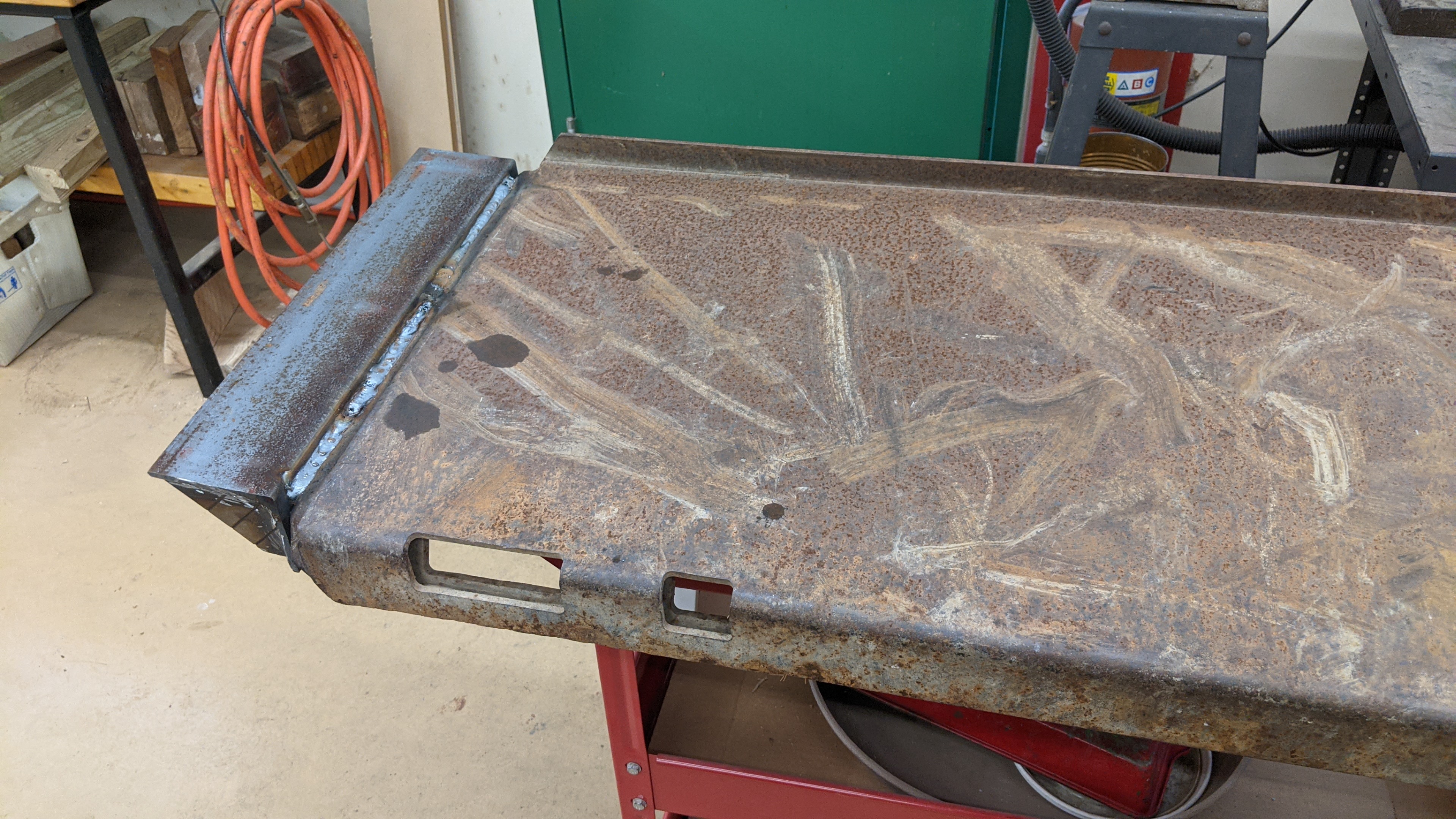

I used some old skidsteer track to make a rubber pusher plate.
Adding 4 wings on each side.
Track was cut with a reciprocating saw with a 12 carbide blade, Outside, lots of smoke.

@McCaskey that is awesome. I made a smaller one long ago but not as nice as yours. Mine slipped onto the forks of a wheel loader or forklift. And good idea using the track steer track
Definitely a top notch job
