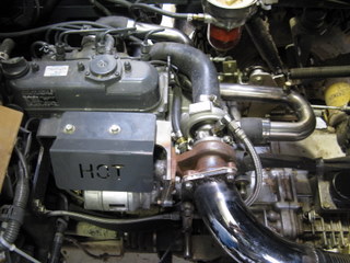

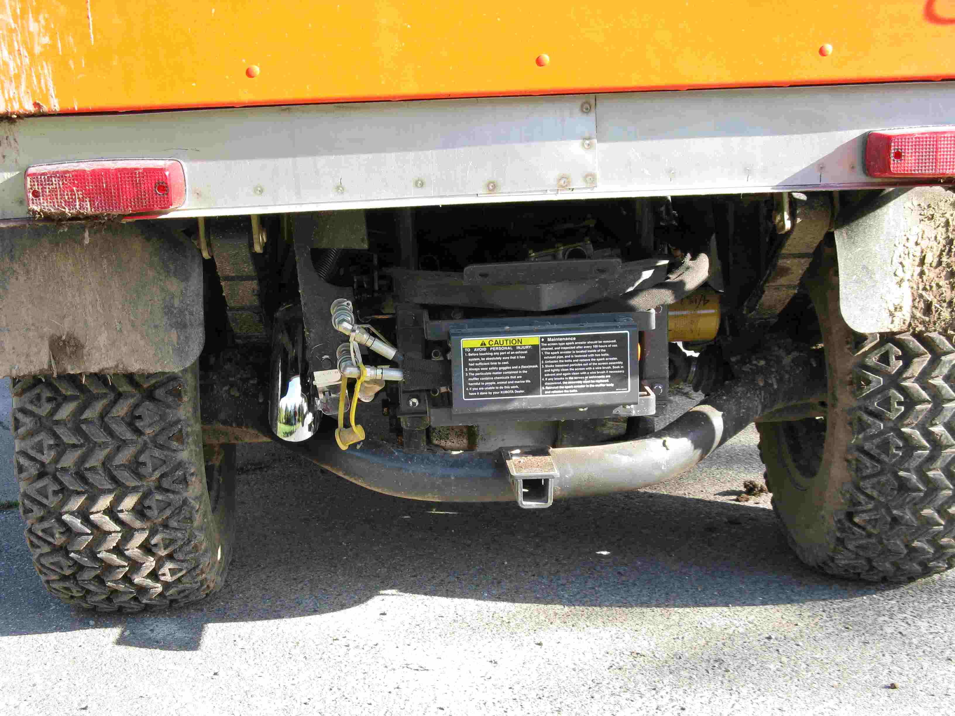

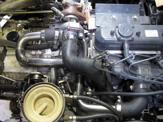

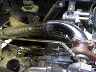

/ RTV1100 Turbo question???????????????
#9
I have posted some photos of my installation.
It was a simple installation and didn't take much fabrication. The turbo hot inlet is 1.5 inches and the exhaust is 2.5 inches. There is no muffler so there is no back pressure on the trubo. The turbo does a good job muffling the exhaust. It's slightly louder that stock. You can definately hear the turbo.
The turbo cold inlet is 2 inch and i used radiator hose. I was able to keep the air filter in the stock position. The trubo air exhaust into the engine is 1.5 inches.
I'm still only getting 4 psi of boost. My EGT is about 1100 deg F.
I have adjusted the injector pump rack and set the rpm to 3600.
Still tring to figure out how to get 6 to 7 psi boost.
Any suggestions would be appreciated.
Regards, Chuck
#15
Old Coot said:
Question, did you see the other guys installation?
I'm wondering if he ran the exhaust over to the intake side. :)
Yes i look at the photos of the other installation.
I don't understand your question, "if he ran the exhaust over to the intake side"?
As i understand it's good to keep the distance from the manifold to the trrbo hot inlet short but the cold air out of the turbo is not too critical. In fact a lot of trubos have inner coolers which causing more restrictions.
Regards, Chuck
/ RTV1100 Turbo question??????????????? #16
Yes I do know about keeping the exhaust hot. That is why you notice I had the exhaust pipes wrapped with insulation on the Mustang. And I agree they run the cold side through inner coolers now. But back then they didn't have intercoolers.
But it seems that every bend you put in causes more turbulance and a drop of pressure. I notice he only has two 90s on the pressure side.
If you seen his installation I would guess you tried to copy it best you could.
I was asking questions more then making suggestions. I'm learning from your work. :)
I should have said mount the turbo on the intake side.
#17
I totally agree but i don't see how the extra bends i have in my setup could cause enough pressure drop to almost cut the pressure in half.
My installlation also has a 8 inch long straight pipe for the hot inlet side with no bends which should help offset any loss on the cold side.
I'm trying to figure out how to get more fuel. I can't get anything from Kubota since they are worried about emision laws.
The pump and injector shops don't seem very familiar with this engine.
Regards,
Chuck
