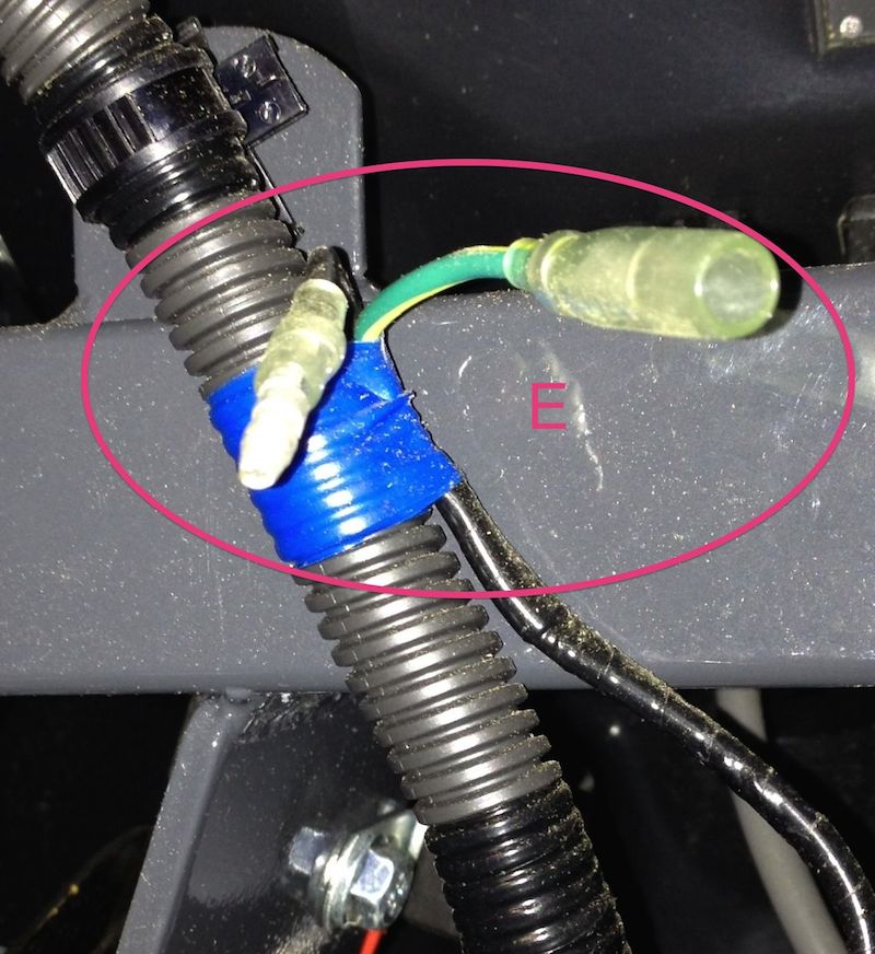

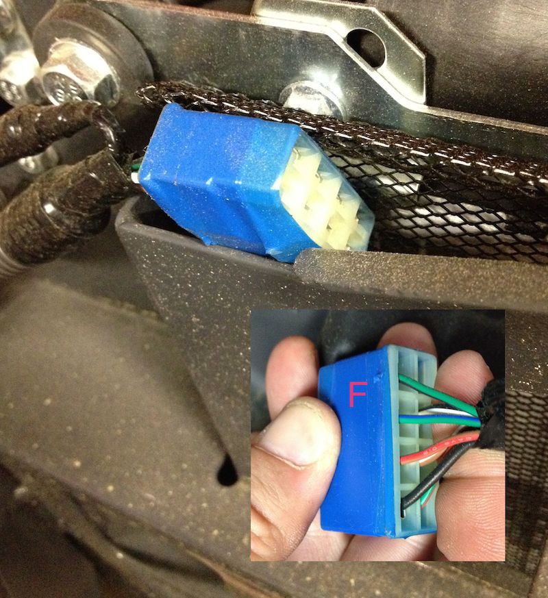

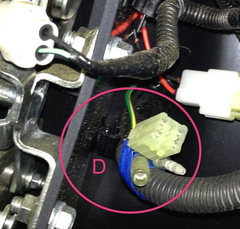

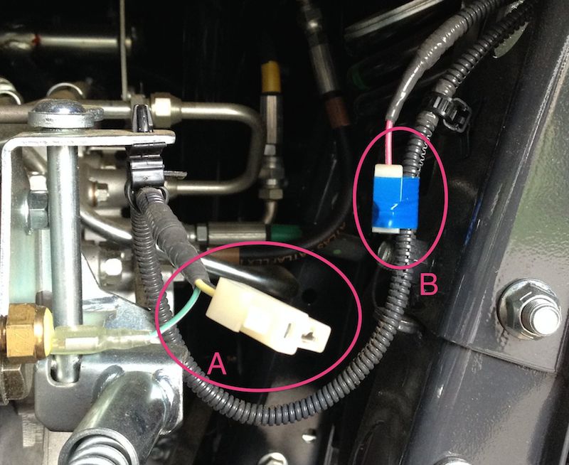

New Kubota owner - Just picked up a BX1870, and an RTV-X900. I've been going over the RTV had noticed that there's some "extra" connectors in various places - presumably for factory options that my unit doesn't have. I'd love to know what these are for, and perhaps use them to facilitate future upgrades.
We ordered it with the VC5080 multiple accessory wiring harness, since we needed one of the harness options for the windshield wiper, and figured that leaving room for future upgrades made sense for the minimal cost difference. It looks like that option is basically the underhood fuse box, and perhaps the 4-switch panel?

The first unknown connectors (A & B) are at the rear, near the transmission.

"D" and "E" are also underhood:
"F" is tucked up by the front radiator grille.

I know the harness is installed for a speedometer. Connections close to the transmission, and at the instrument cluster. Harness for auxiliary lights. Some more that has slipped my mind at the moment.

I too, have just picked up a new RTV-X900 and am wondering what the connectors are for. The ones in the rear are "hot" all the time as far as I can tell. I only did a quick look with my meter, and need to go back and check some more. I thought one would be for the optional back-up beeper, but it is not controlled by the shift lever going into reverse. I'd like to find a schematic of the entire machine. I'll post a link if I find one.
I hope to put in a pair of back-up lights and would like to use an existing harness - I can't imagine Kubota making different wiring harnesses for machines ordered with and without a beeper.

The wires ( connections) by the back of the transmission are "hot" when the key switch is on. The reverse gear does not affect either of the connectors.

I know this thread is old, but better late than never. Item D above is a connector for Kubota hazard or work light switches. An example of the work light switch would be R240153242 for a Kubota excavator. I know you only asked about what it was for, but people have asked about these connectors in other posts. The connector is a Sumatomi nonsealed MT series 6242-5061. Sumatomi catalog is here 自動車用部品:Sumitomo Wiring Systems, Ltd. You can buy the connector at Eastern Beaver. It is listed as the 6P090-MT SPA Female for $2.03.
/ RTV-X900 Wiring Question #14
Is E and C in those photos for the blinker kit ?
