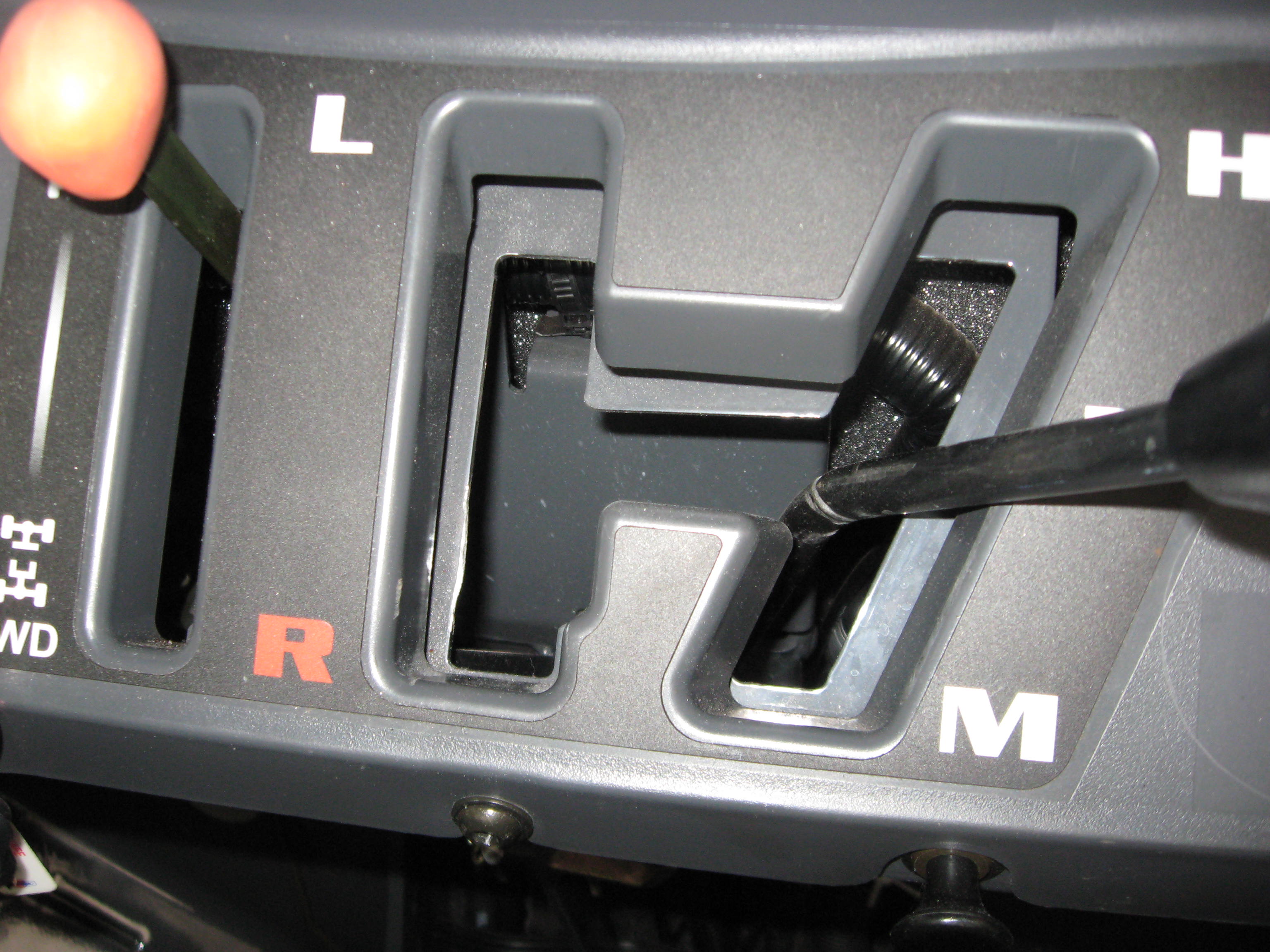

I have had great luck lately with my RTV1100 09 (`90hr) after having the dealer adjust the neutral pressure as described in the WSM. Mine was always hard to shift from day one compared to my 08 RTV900. Then I adjusted the HST arm as per the WSM. Huge difference in shifting. They said the neutral pressure adjustment was off quite a bit.
And yes, PATIENCE is required, but not 10 seconds, 2 or 3. Just don't be in a big hurray. And a FEEL for the trany helps.
Then because I plow snow, I opened up the shift gate to make reverse easier to get to. Not really sure why that piece of metal is even there.
