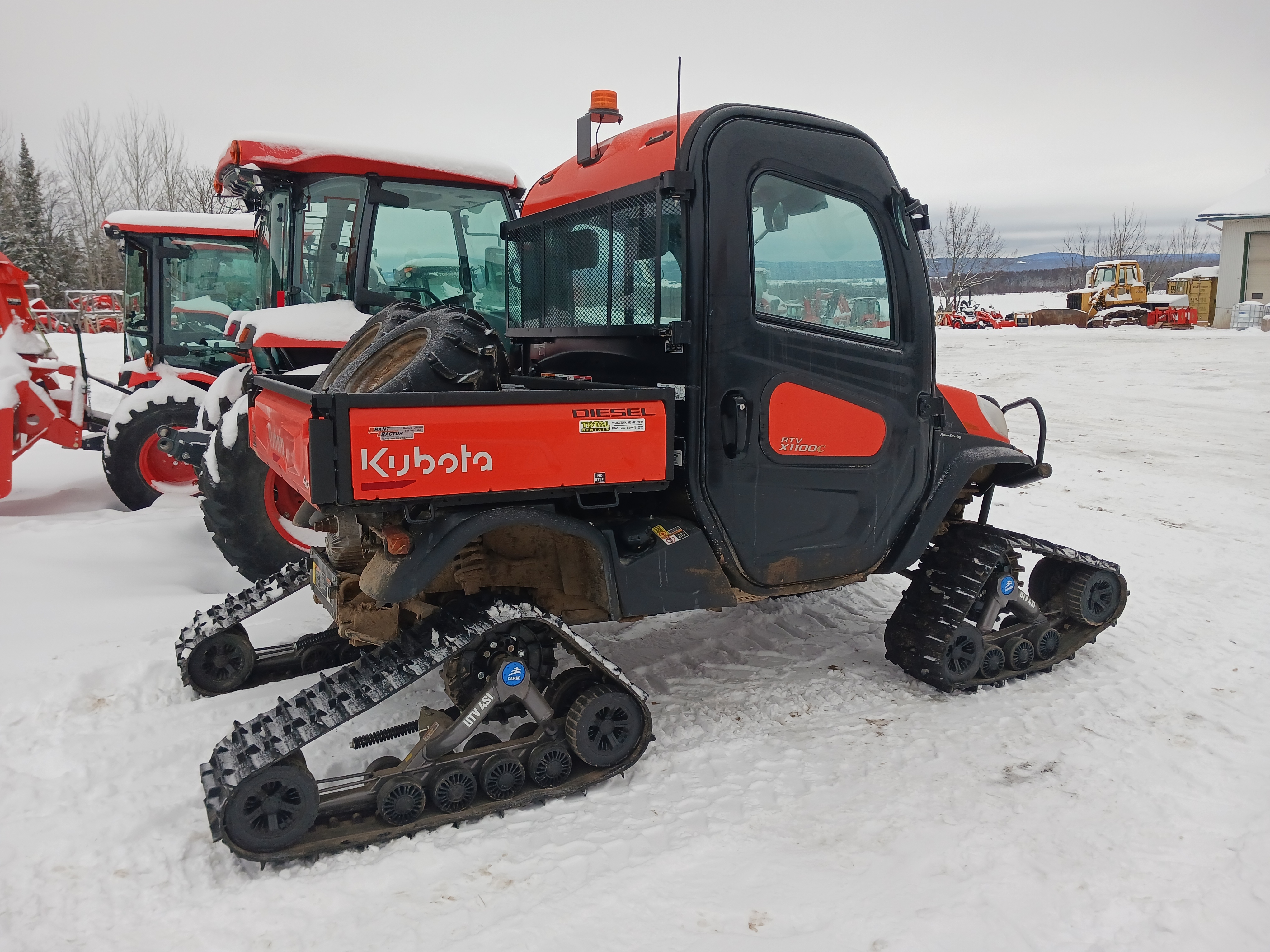

Saw this at my dealer the other day. The powerline contractors here are using a lot of these now.
/ RTV on Tracks
Looks like an expensive modification. Wonder who makes the tracks? Certainly not Kubota.
They are Camso tracks. I never asked the price. I'd sure like to see how they work on that machine.

I just found you tube videos on RTV's with those tracks. I'd be scared to even try and go where they did, but they seem to work! Even looks like it can still go normal (well, for an RTV) speed.
/ RTV on Tracks
I'm always scared of getting mine stuck. You'd need a bulldozer to get that heavy thing out, LOL
/ RTV on Tracks #7
Tracks on a diesel powered Kubby side by side would be interesting in as much as they don't make gobs of power to begin with. I would think the parasitic loss from the track assemblies would further degrade the power output, but what do I know. Not something I'd be interested in anyway. We own a Kubota side by side but not a diesel powered one, rather a gas powered unit that actually produces good power and travels over the 25 mph speed that all the diesel powered ones are governed to. Ours will ran close to 60 if necessary, not that we do ever simply because 60 is scary in it.
/ RTV on Tracks
Huckabones has a video of a Sidekick with tracks as well. It does take away some speed and he says you need a country mile to turn it around.
I mean I guess I can see them useful for somebody like a powerline contractor, or a wood lot.
Like I say though, I would HATE to get it stuck, LOL

I have those same tracks on my 2017 x1100. Love them. Wintertime use only, for plowing and on the lakes for ice fishing. There's a lot of surface area with them and can float over a lot of snow. The tracks also provide a lot of traction for pulling ice shacks, so long as it's not glare ice. They need snow to grab, and they do bite in snow with the amount of surface area. We pulled out a Ford F250 that another full-seized truck couldn't budge. The Kubota walked the F250 right out when in low gear.
However, did get it stuck once, just a matter of shoveling to get the frame off the snow, and backed out. Loss of speed is 50%. And yes, need lots of room to turn it around, I'm a three-point turn expert now.
/ RTV on Tracks #11
I have a set for our Gator. They're a lot of fun but very slow. The drive sprocket is about 12-14" diameter wich is your final drive ratio. Think of it as driving on your wheels with no tires.
If you don't care about flying around with the engine screaming and maybe have more of a "hot rod" machine that's one thing. The Kubota and my Gator are more utility types.
In certain snow conditions anything with tires can get hung up in only 6-8" and the tracks don't care.
We have over a square mile of land with various "grades" of logging trails and roads that are actually more accessible in the winter with the tracks because of the increased ground clearance of about 18".
