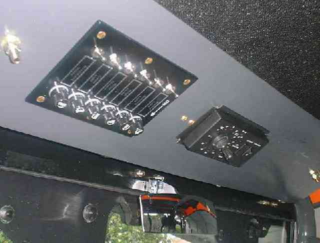

I already have a rocker switch in that hole to run my amber beacon lite. I have to poly roof on it and tomorrow I am picking up some lexan to make doors for it. So will more than likely put a bank of switches up near the ceiling and move my beacon switch up there also.

To make you a secure panel for overhead. Being I also own a sign company, I had access to a .080 aluminum painted blanks. This is the same thickness as a STOP sign. Go to a local sign shop & get 'em to cut you a piece of painted aluminum and make the corners radius of 1 or 1-1/2" ~~~~ Get yourself a marine switch panel with fuses, ( ebay has 'em ***** $ 12.00) and run you a hot wire up to the switches, and then spider out from there ~~~
Get you some very fine sandpaper, and ruff up the paint on the aluminum, prime it with a Krylon quality acrylic, and paint it the KUBOTA ROPS grey color.

That is a very sharp looking panel. I have some of the road sign Alu on hand. I got an old unused directional sign from where I use to work(retire now). I plan on putting piloted lighted switches in it. My main feed wire will be # 6ga and that will also be fused or have a circuit breaker.
   / RTV CCA Battery #15
You're are ready to go then. Be sure to add yourself a few extra switches for future installments ~~~~
