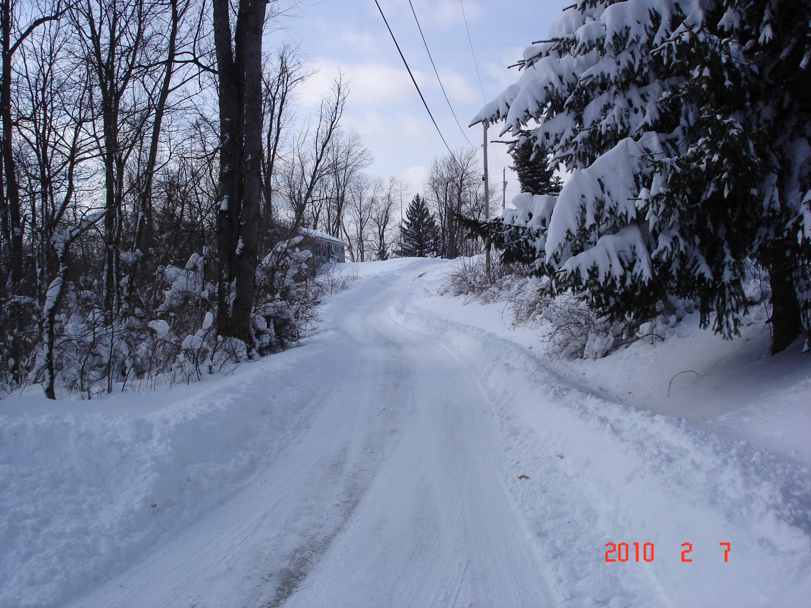

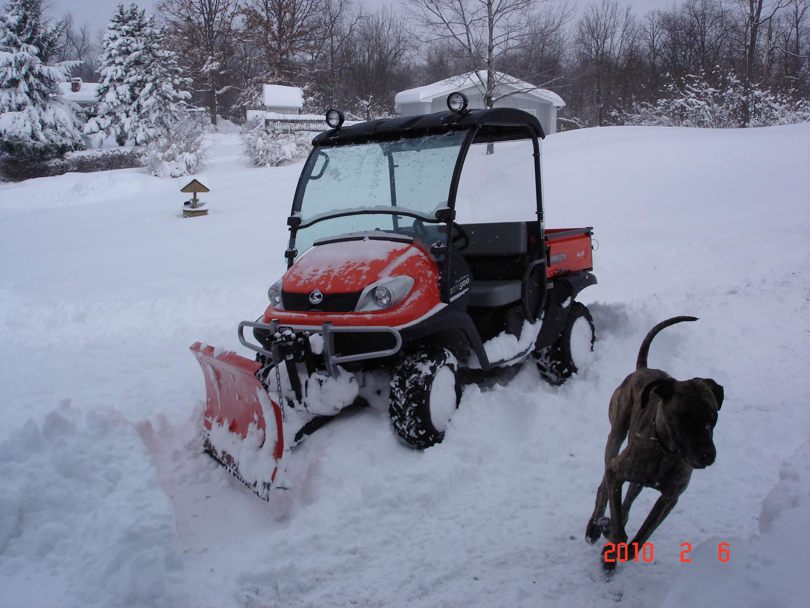

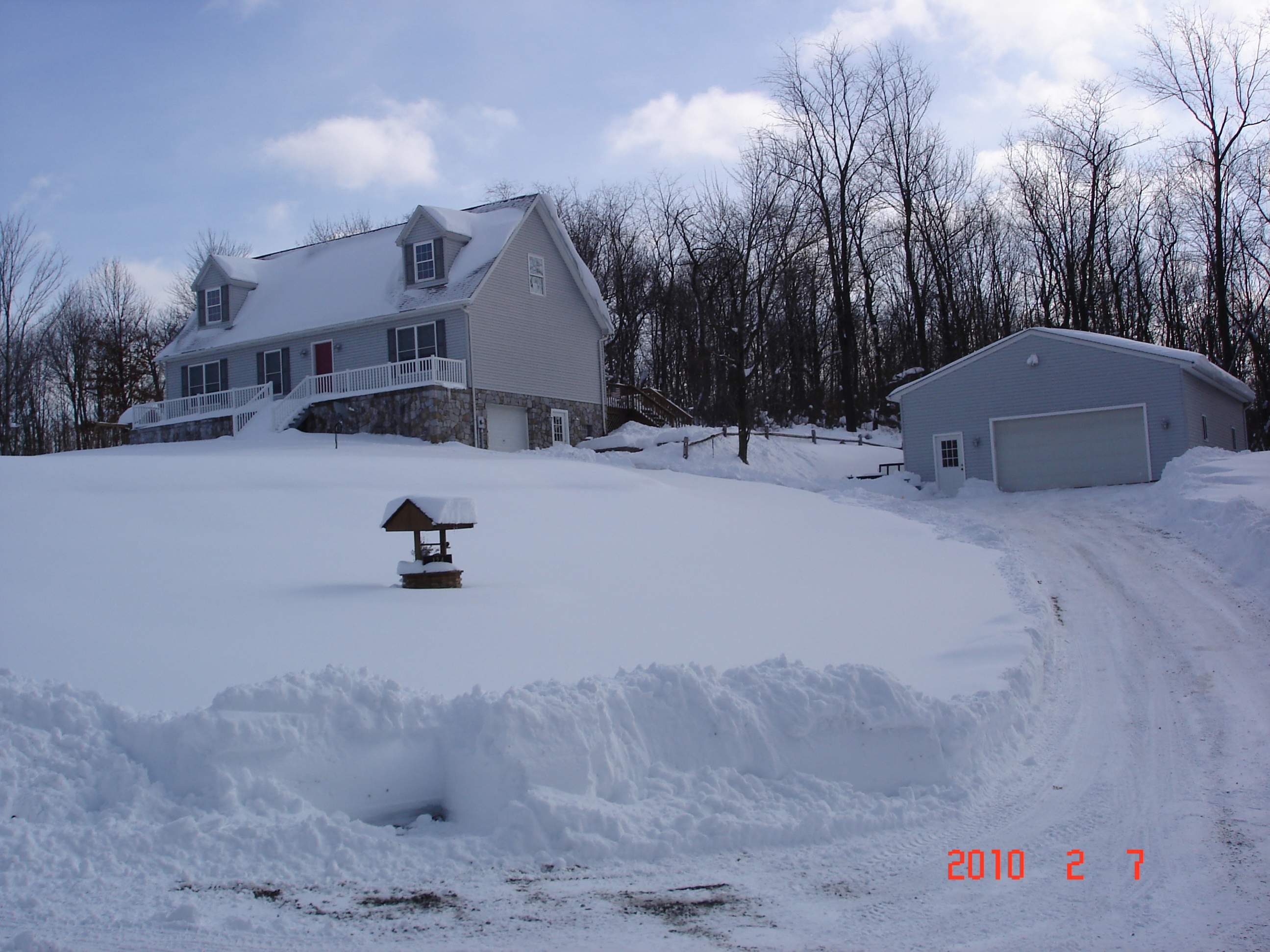

I'm with 737 on the power issue...However, after I made some changes, this thing is actually pretty good now. In fact, since I've been looking at an RTV1100, it's been running even better:confused:
We had almost 3ft of snow here a couple of weeks ago, and I was able to plow snow that the quads couldn't touch.
Am I thilled, no..But thanks to Kubota Canada, not U.S., I actually like this little thing now.
If you're not looking for a race car, go for it. It's a good puttering and work machine. Just don't expect to keep up with ATV's.
