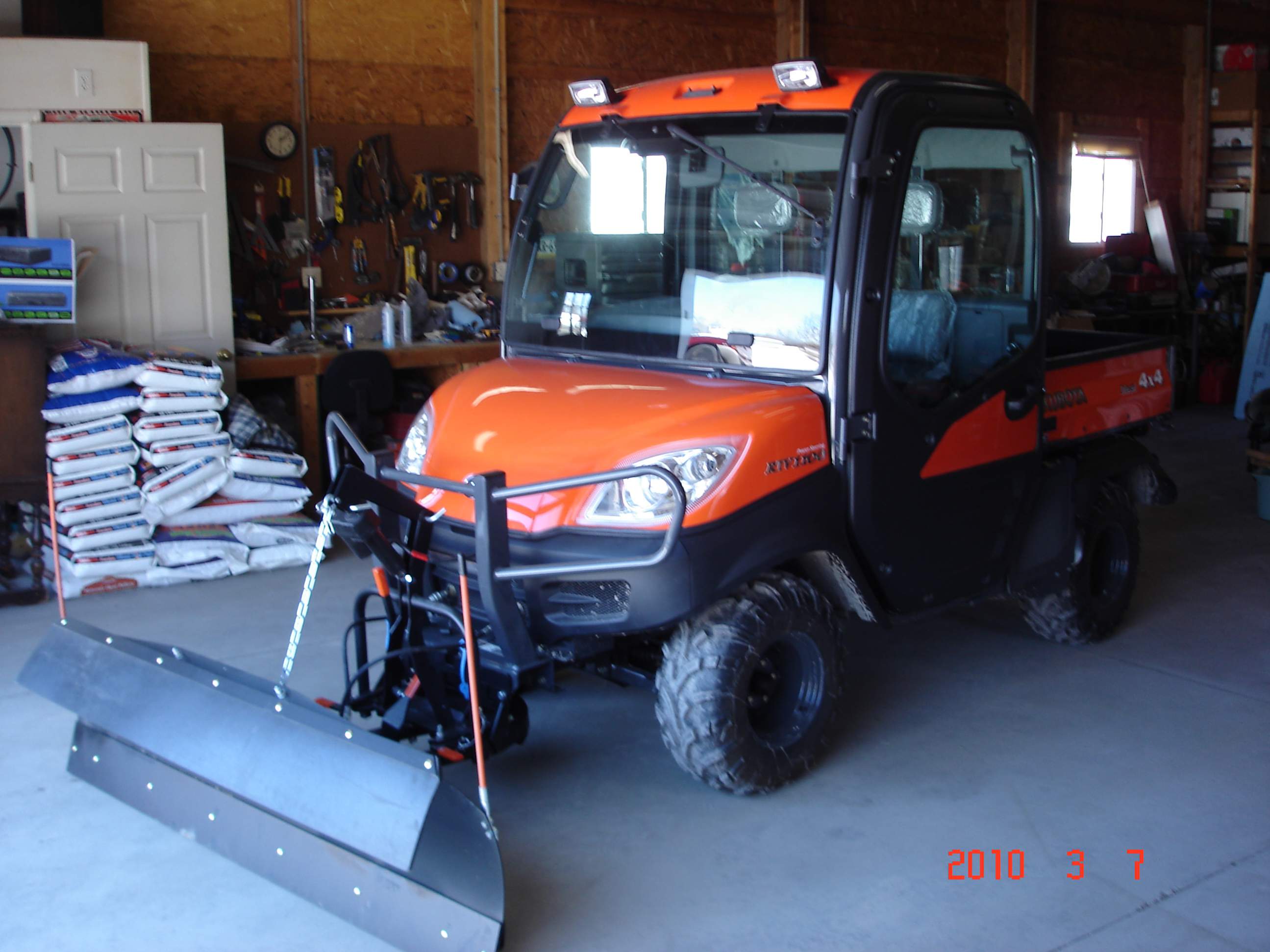

I've been using my RTV1100 to plow for the last 10 years--The last couple of years have been light. I take care of the neighborhood driveways, all over 100' long. I've never had a problem moving any kind of snow with it. I have the OEM 6' plow with actuator lift and hydro power angle with a rubber strip on the cutting edge so I don't tear up gravel or scratch asphalt.
I love the machine for snow removal, no regrets.

HD--6" is no problem whatsoever, I've plowed 9-10" quite a few times.
No, I've never put anything in the bed or added any weight, this thing is already heavy. I have the ATV tires and have never added chains or anything like that.
Obviously it isn't going to remove all snow that has been driven over and packed in--pretty normal there and I wouldn't expect it to. And like any "smaller" machine (not a dump truck) you should move the spoils well out of the way so they don't freeze over--You don't want to try to move a 3' high frozen pile Doesn't do well with that, and again, I wouldn't expect it to.
As far as dislikes--Wish it would move about 10mph faster and a full front locking diff would be nice but that has only been an issue in deep mud. Only had to use the diff lock (rear) a handful of times--mostly mud.
The cab and HVAC is fantastic when you're out in the freezing cold for a few hours.
This is an expensive piece of machinery and I know how you feel doing the research but I have no regrets.
