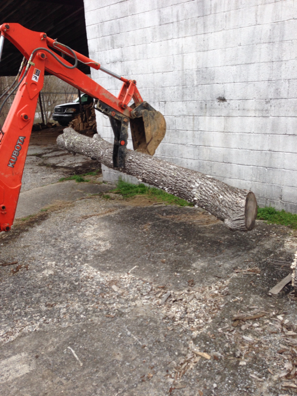

Thanks 4570 man. I use to have on of those. Traded it for a welder I needed. I've always regretted it. What is a back hoe thumb? That's a new term for me.

Thumb attaches to dipper stick and let's you have something to clamp things I'm between it and the bucket when you curl the bucket

Here is what I use my thumb for. The thumb is a piece of metal for the bucket to clamp against. Some of the nice thumbs are hydraulic controlled, but few people have those on tractor mounted backhoes. image-3278431455.jpg

Here is what I use my thumb for. The thumb is a piece of metal for the bucket to clamp against. Some of the nice thumbs are hydraulic controlled, but few people have those on tractor mounted backhoes. View attachment 457362
What is the old saying about never going back, well if you ever use a hydraulic thumb, you will never go back to a fixed or manually adjusted one. I can pick up anything from hen egg sized to maximum lift sized rock or other object and never leave the seat to adjust anything. Between picking up and digging, you have to move the thumb so it lays against the dipper stick and out of the way so a fixed on has to be constantly adjusted. In my soil there is always a rock(s) encountered that sometimes need to be picked up and moved so the thumb is always used. Hydraulic ones are costly to install but worth every penny especially if you are physically challenged for getting on and off the tractor.

JoelD I have something like that but it has an arc of teeth about the size of your thumb shaft, it's also bent in an arc with the inside of the curve facing the boom and bucket. I should have gotten it just from the word thumb. Hands are much more useful with one of those. Thanks a bunch for the pic.
