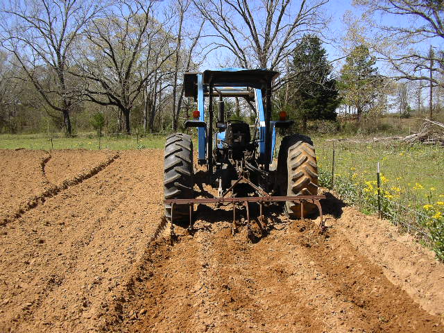

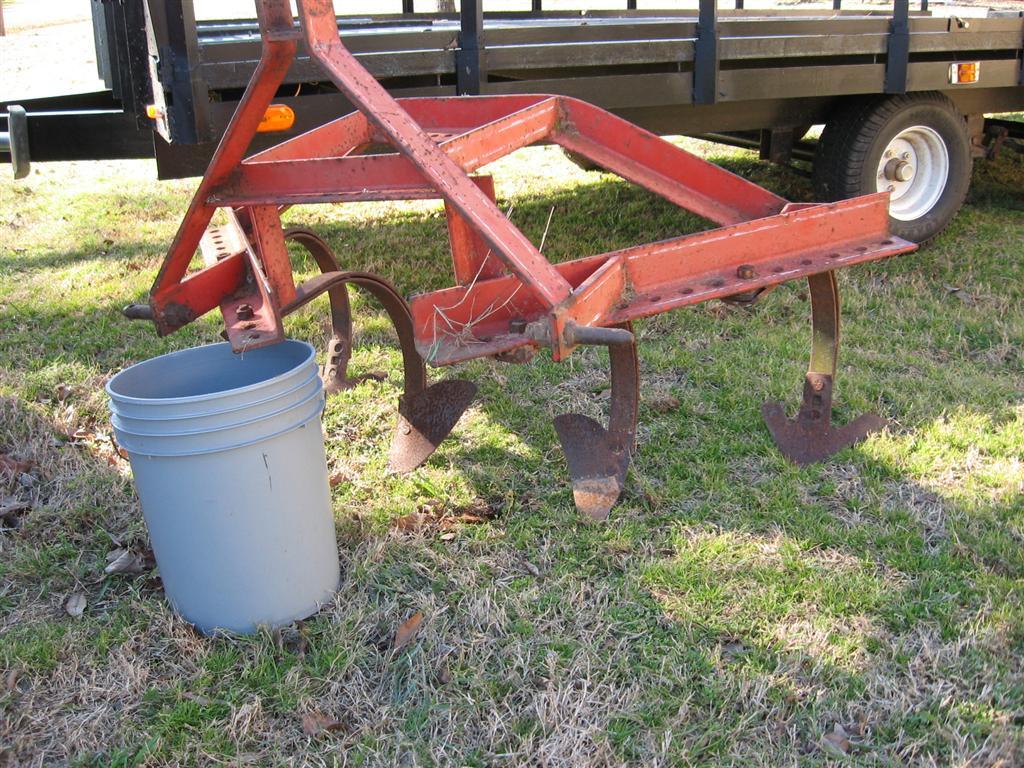

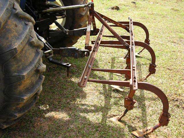

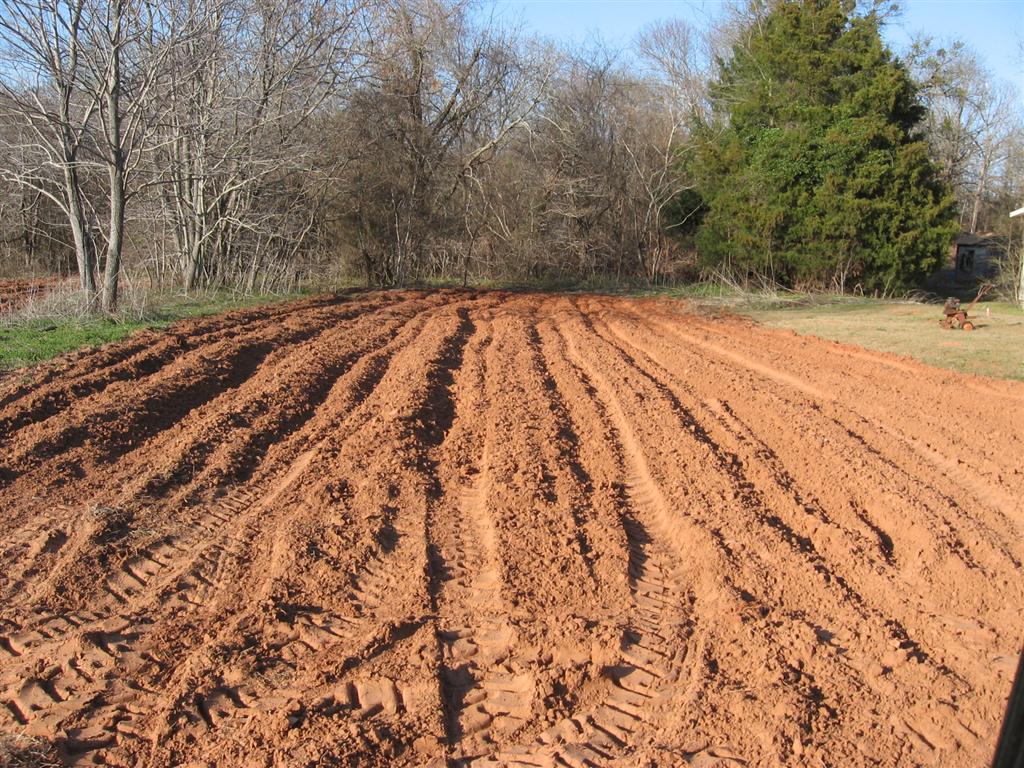

Your tractor width is probably set up where you would need to make 2 rows at a time. The rear wheels would be on the outside of 2 rows. I think a standard row width is about 40"...maybe less. Not sure. So you would actually need 3 MB on a bar to make it work right(2 aligned with the rear wheels, and one in the middle). Here are a couple shots of some row makers. The larger one is on my neighbors Ford 4630. The single row is what I use for my little tractor. It actually sets up the rows a bit far apart but it works for me and my little play garden. I think its because I have all my wheels at the widest position. But it'll give me some nice mounds and plenty of room between.

I think I'll look for a used cultivator like that. That should be what I need. I'd like to make the rows with that after tilling and hopefully that will help with the hardpan problem. Pretty much the ground here is hardpan all the way to the top. When I plowed the spot for the garden the first time with the breaking plow, it only got about 4 inches in the ground on the first pass.

These things only work in nice fluffy soil. They won't cut into any hard stuff (without breaking). Use that tiller to go as deep as you can. I think I get about 8-9 inches, about as deep as the disk will go. Since I have a small area I'll go over it 4-5 times.
