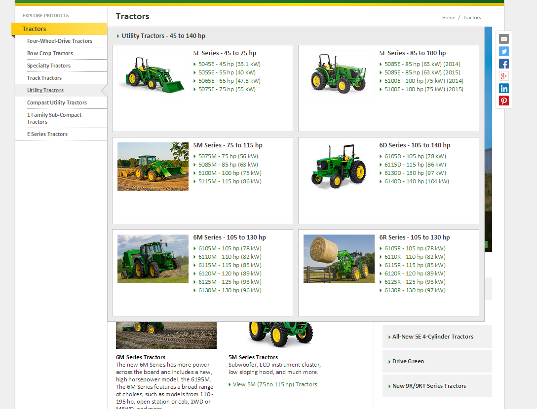

Check your info. Snapshot of the JD site today. These are all listed as utilities on JD's own website. Thanks though! :thumbsup:
They are a little confusing on their website. The listing of utility tractors shows all the 5 and 6 series models but then the name on the 6D is utility whereas the 6M and 6R do not have 'utility' after the name. The 6M and 6R also have taller tires and more ground clearance like a row crop stye tractor. Also, if you include the 6M and 6R in the "utility" group then Deere has no Row Crop tractors under 140 Hp which doesn't make sense either. It seems to me that they have blurred the definitions greatly from what they have been in the past. Of course when they advertise a 1 Family and then I saw an ad for a 3 Family tractor I had to scratch my head a while to figure out what they meant. I know it is all a marketing thing but They certainly have a lot of numbers and a lot more confusion with their latest breakdowns.

Well, thats partially what I was getting at. The 6R is def a row crop tractor. The 5E and 6D are definitely a utility tractor. To me, the difference would be the wheel adjustment in the rear. If it has infinitely adjustable rear axles, its in the row crop family for a new machine. If you have to flip tires to get your width, that's more of a utility in my mind. The M's are in the middle somewhere.

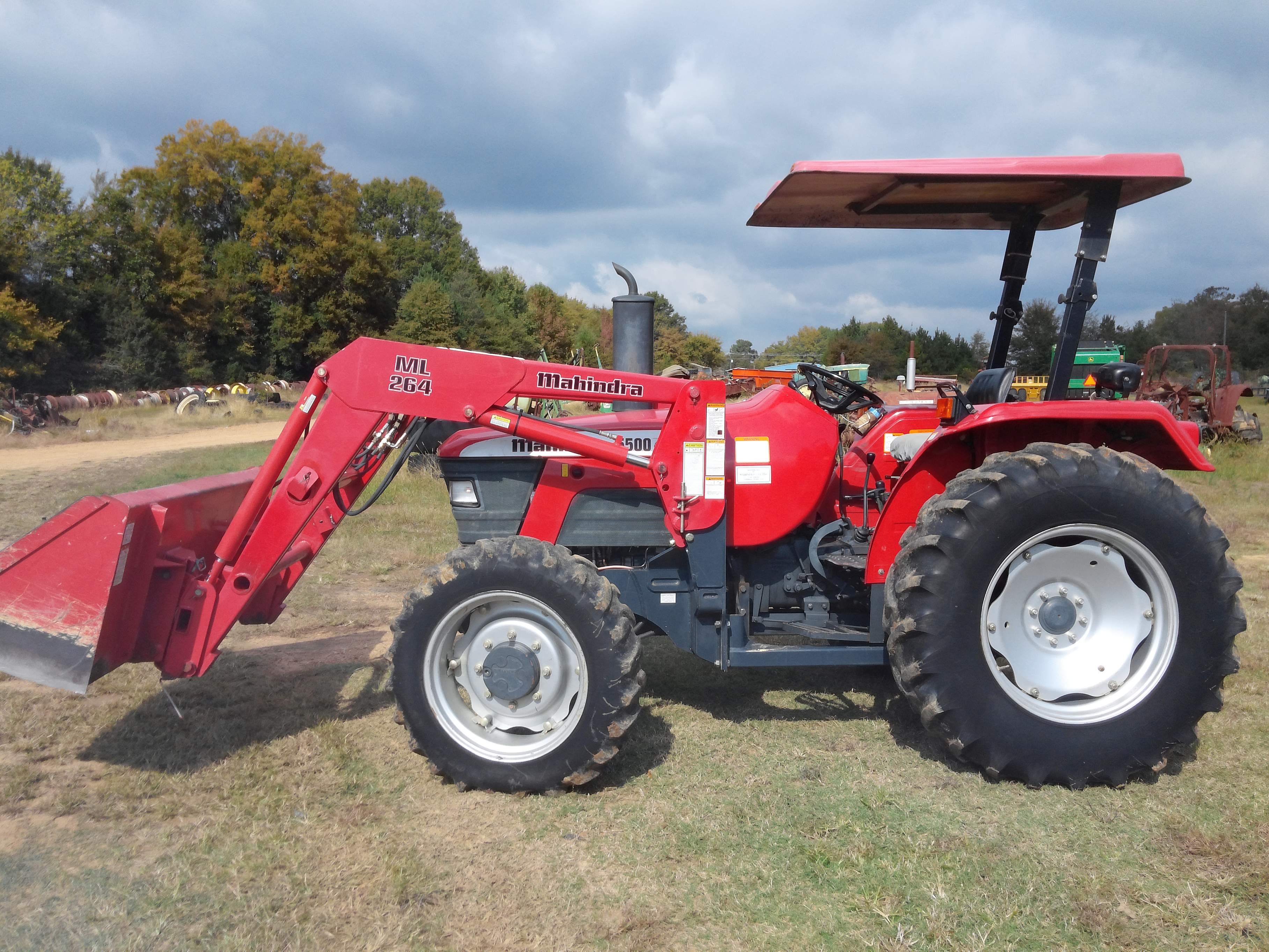

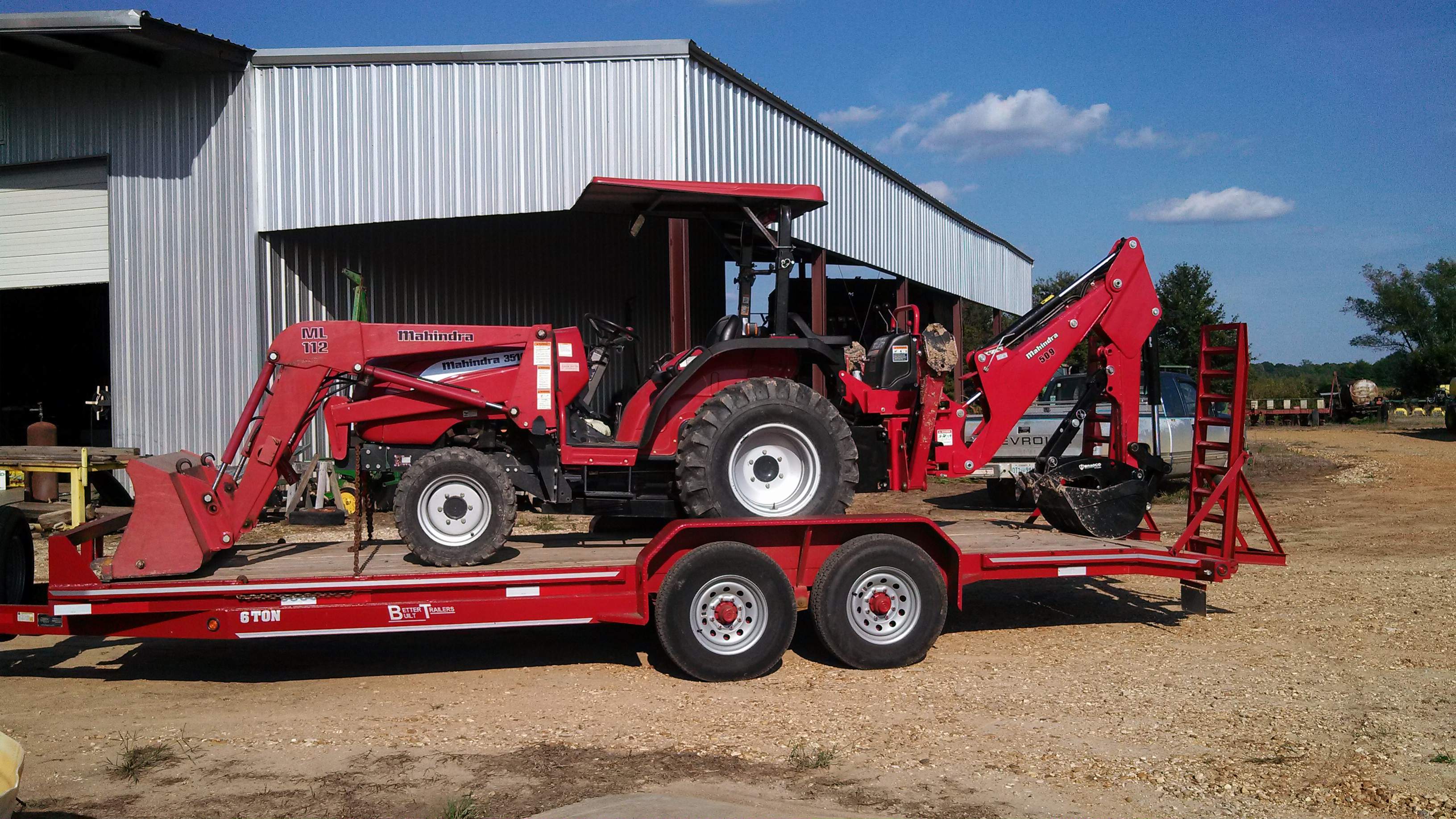

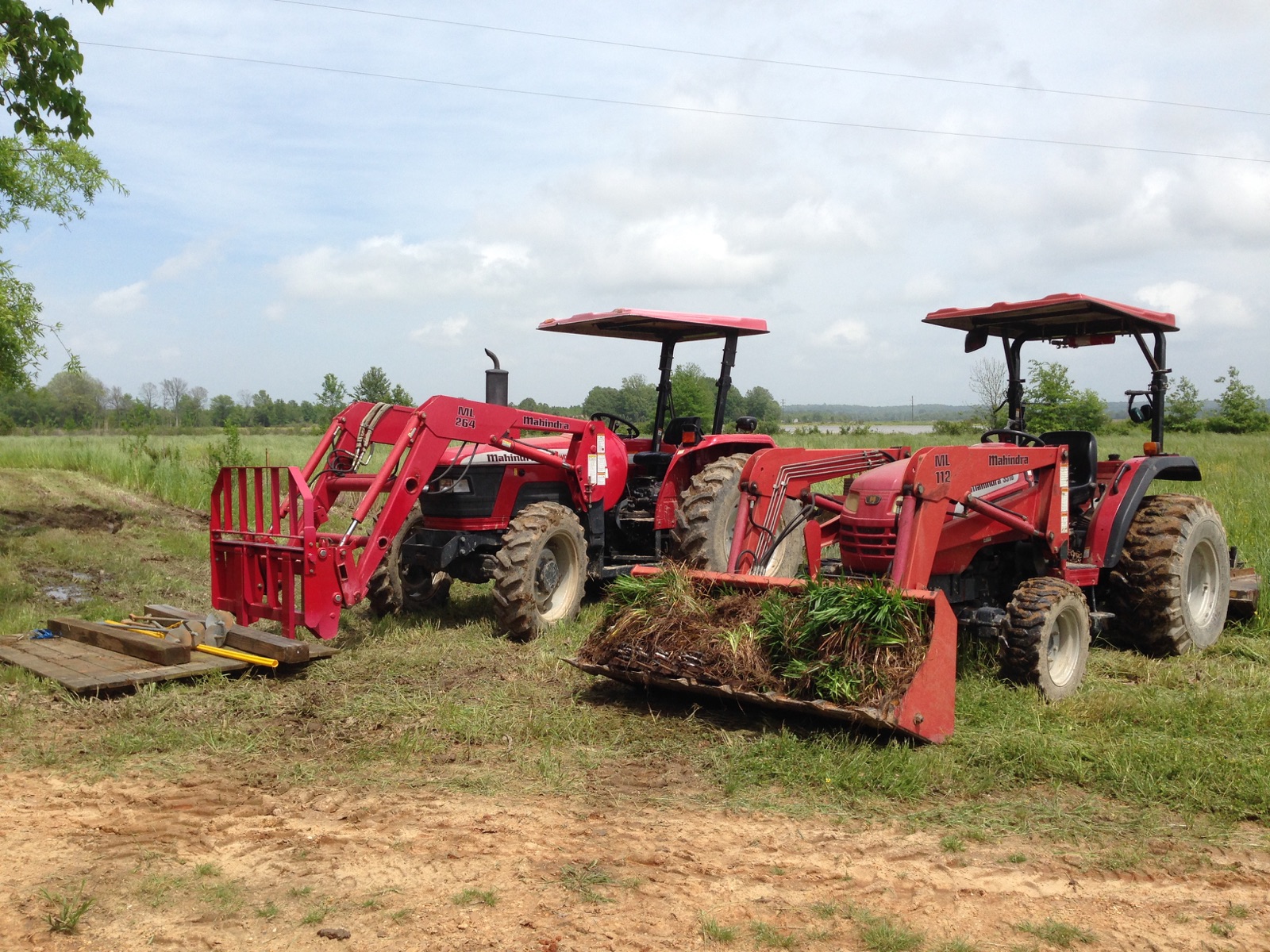

Utility
Row Crop
Side By Side
Need one of each to -'Get'r'dun'!! :thumbsup:

Utility
Row Crop
Side By Side
I would have to disagree, I see a Compact Utility Tractor and a Utility Tractor. Nowhere near the old era and modern day row crop. I could "technically" use a Utility as a row crop pulling a 2 row planter. Modern row crops are the big boy 6 cylinders that weigh in the 10,000+ range and are running transmissions designed for torque. Modern day utilities are intended for haying, clipping pastures, feed chores, etc. A true row crop tractor will make a Utility look like a CUT.

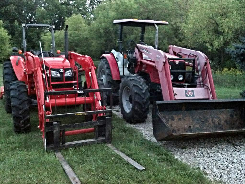

Buddy's 95hp 5455 next to my M8540 85 hp utility. His tractor has a base weight of nearly double mine. He sitting at roughly 15,500lbs according to the guy who hauled it for him versus ~9,000lb It's taller slightly longer and has taller tires. The operator station is much bigger and has a lot more bells and whistles like electronic locking differentials front and rear. Not sure I can really fit in many places he can't both are pretty good sized. Compared to the smaller utility's like his is old 40hp JD2040. The Perkins engine on the Massey is nice and smooth compared to my Kubota.
