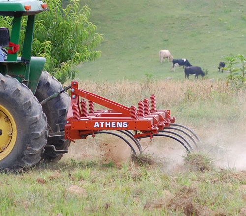

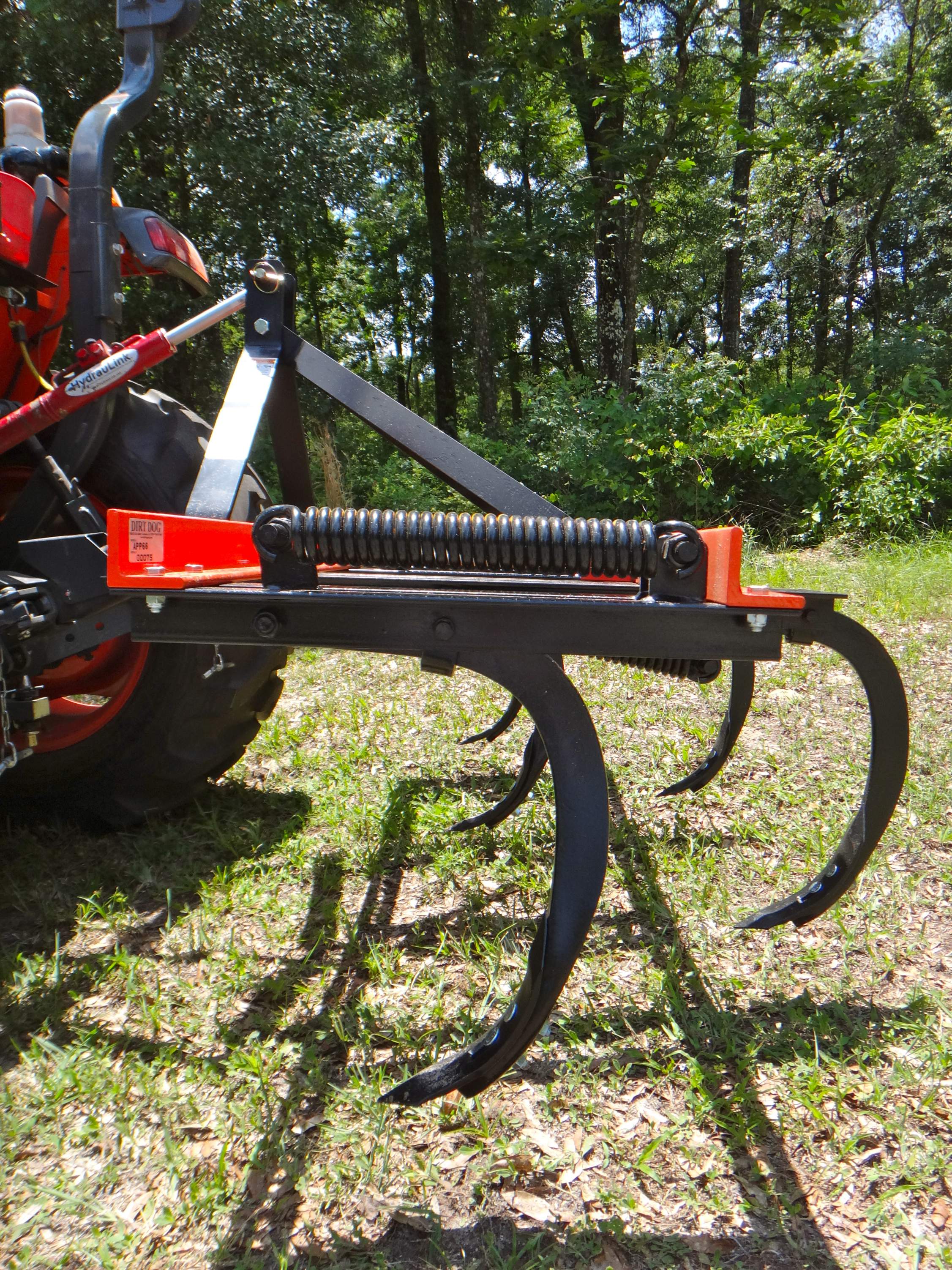

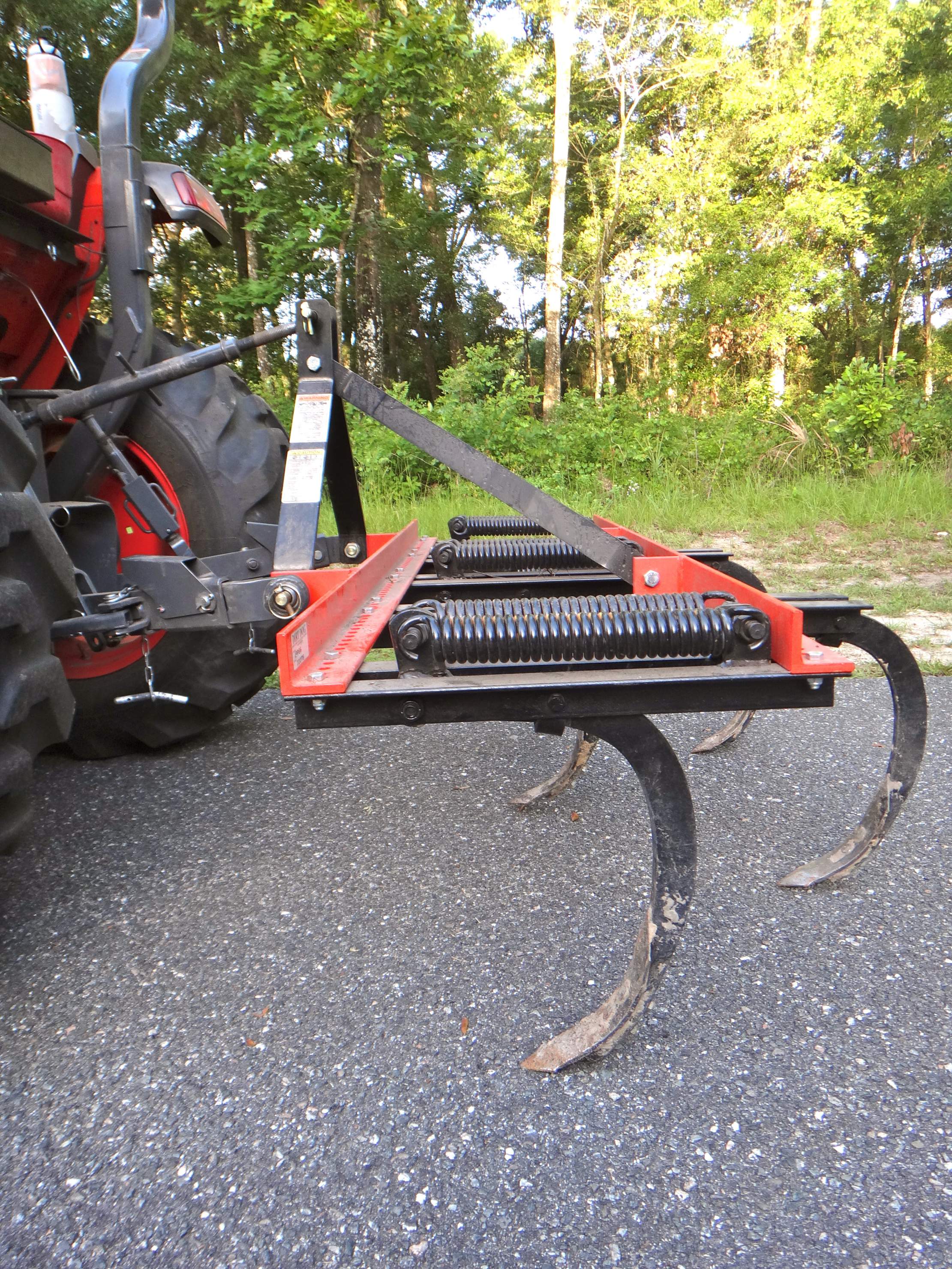

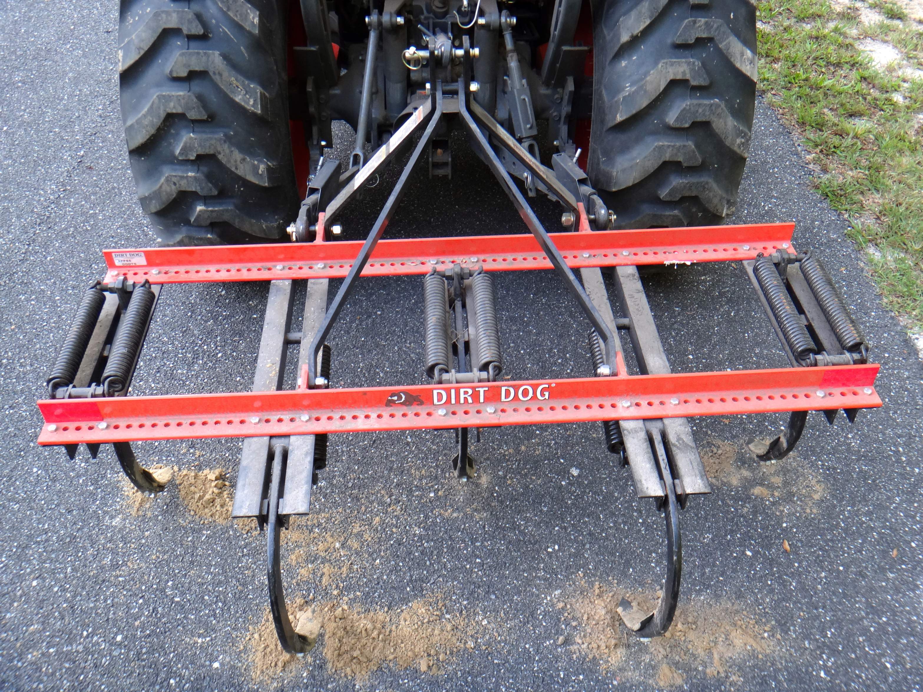

/ Row Crop Cultivator #9
A Field Cultivator is essentially a light duty Chisel Plow. Field Cultivators are SECONDARY TILLAGE implements.
Dirt Dog (brand) Field Cultivators are made with as few as three tines suitable for 2,000 pound (bare tractor), 4-WD tractors.
(True) Chisel Plows require 6,000 pound (bare tractor) or heavier tractors. Chisel Plows are PRIMARY TILLAGE implements.
MORE: http://www.tractorbynet.com/forums/attachments/339095-dirt-dog-all-purpose-plow.html?highlight=
This nine-shank Field Cultivator has been on Craig's List/Gainesville/Florida for months. A bargain for someone:
CULTIVATOR
Nine shanks would require a 4,000 pound (bare tractor) to pull through Florida soil. However, shanks are removable.

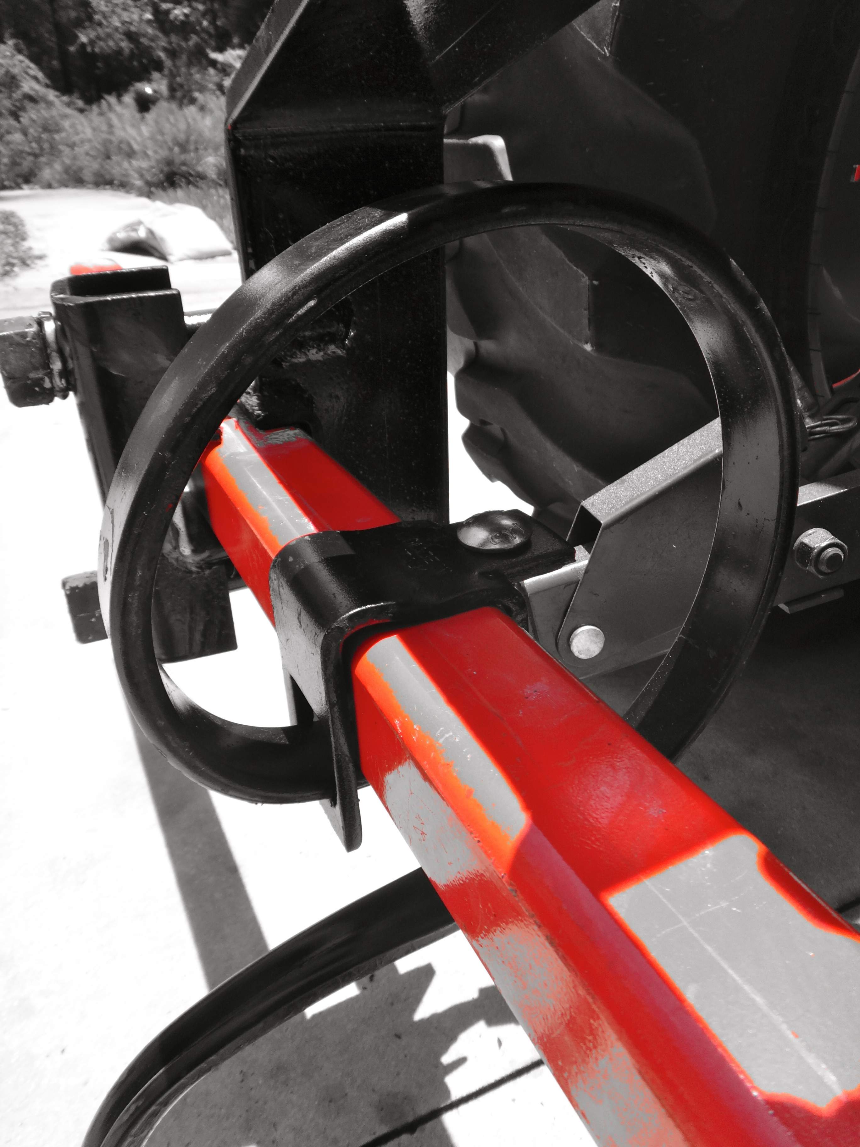

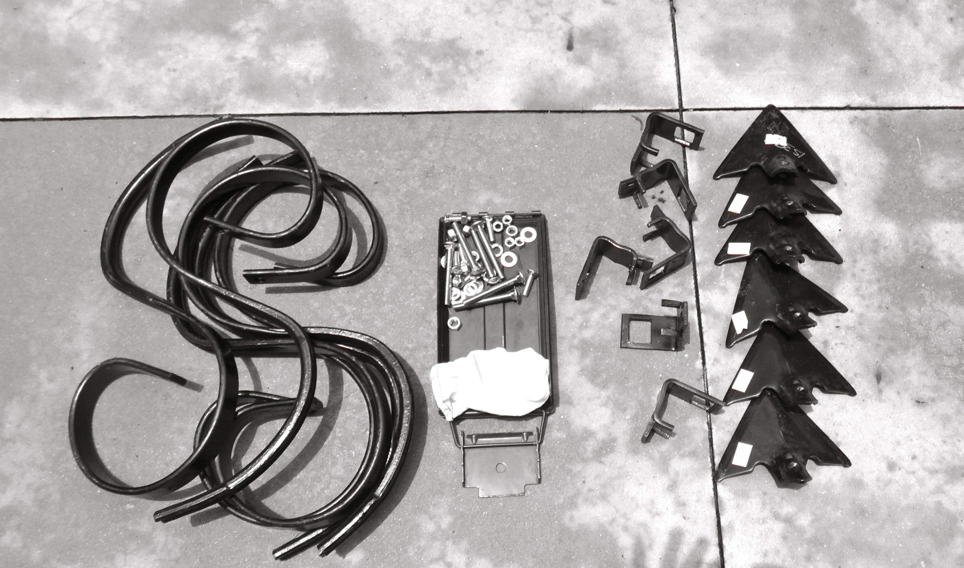

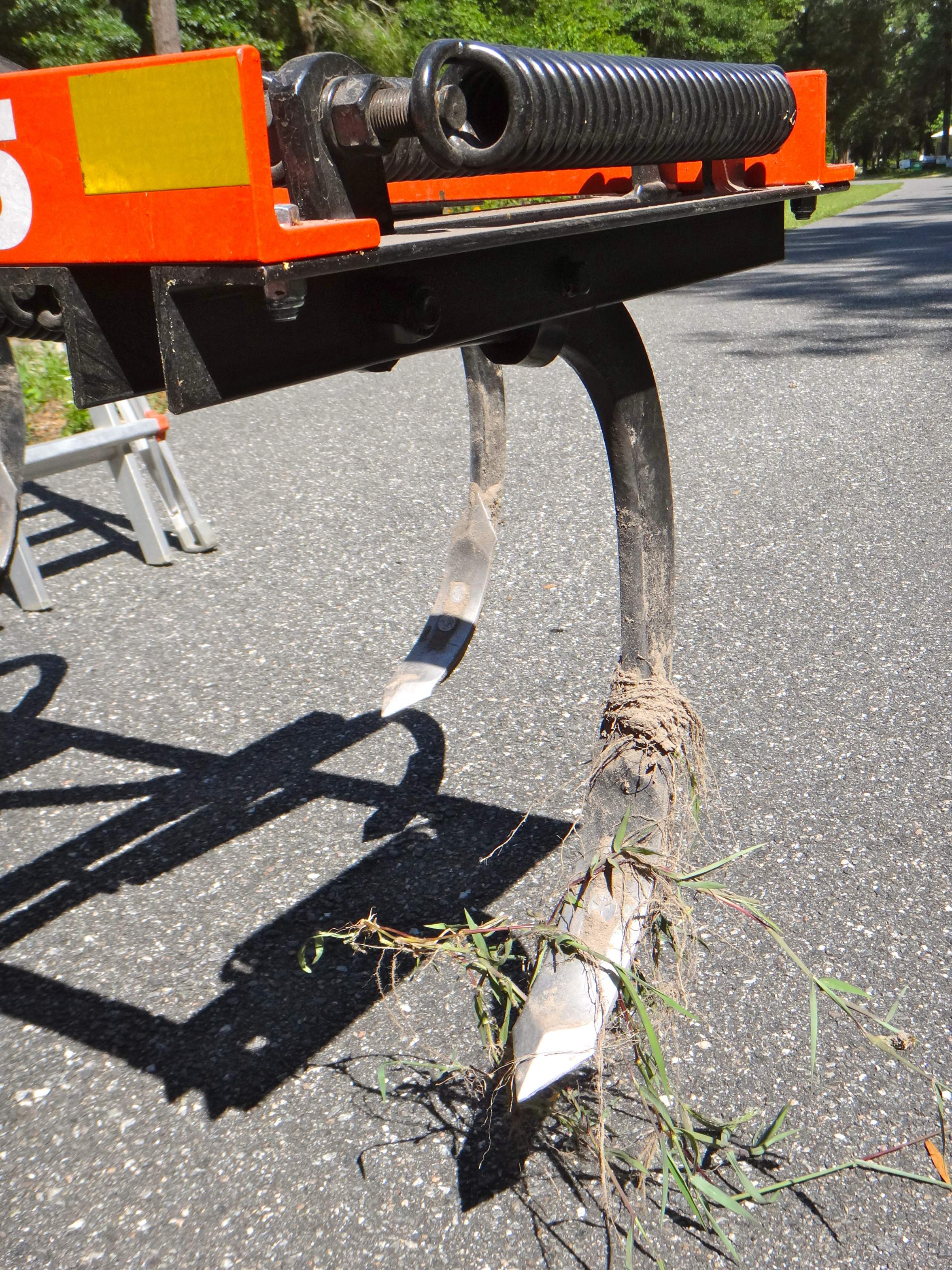

/ Row Crop Cultivator #10
I'm just up in air about what would work. Agri Supply has "S" tines for $10.99 but they only have one bolt hole for the sweep. The "C" tine has two sweep holes but both only mount with a single bolt. Guess if it becomes an issue I could fabricate some sort of bracket to keep the tine straight on the frame.
One PLOW BOLT attachment for the sweeps has never been a problem for me, once the nuts and Plow Bolts settle in.
Here are photos of the S-tine bracket. S-tine attaches to bracket with 7/16" X 3-1/2" carriage bolts and ny-lock nuts. Brackets are available in multiple sizes. Best supplier: Agri Supply: S- Tines and S-Tine Clamps
The Tool Bar Cultivator is an Italy import form Woodward Crossings in Pennsylvania, which they term a Wunderbar, rated for 65-horsepower. I have two of these. One for BX, second for my L3560.
MORE: http://www.tractorbynet.com/forums/...rd-crossings-modular-tool-bar.html?highlight=

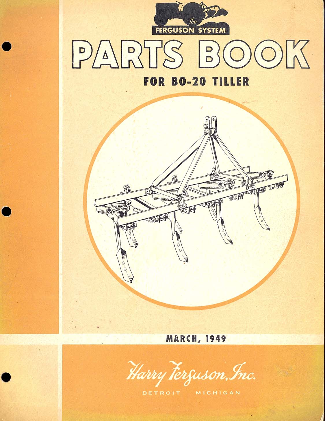

/ Row Crop Cultivator #11
Think Ford designed it in the 50's and called it a Field Tiller or something like that. The photos posted by Jeff above kinda explains the original implement. My understanding is today a "cultivator" is used for weed control on existing crops.
Harry Fergusion, inventor of the Three Point Hitch, also invented the Field Cultivator, which Ferguson called a Tiller. Ferguson's "Tiller" was one of the first four Three Point Hitch implements, the Three Point Hitch Moldboard Plow being #1.
Ford stole Ferguson's design. After a lengthy lawsuit, primarily over Ferguson's Three Point Hitch, Ford paid Ferguson.
