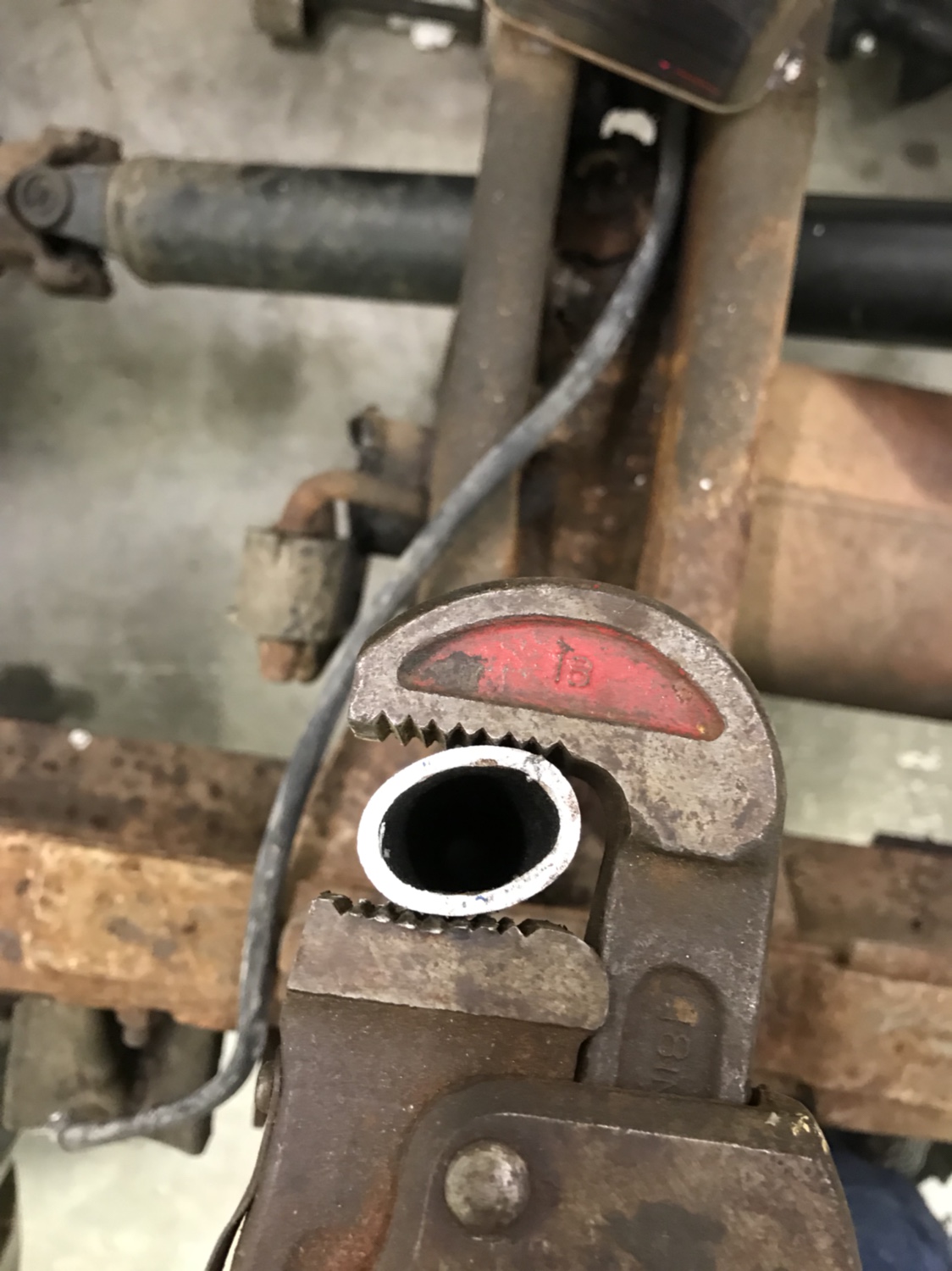

The head of the plug was cut off before we drilled through it, after drilling we chiseled away the rest and cleaned it up flush to the pan. After that tapped the easy out into the hole and started turning. Came out smooth after all that.
Unless I am mistaken, I do not believe anyone posted this ^^^ exact plan. So,,,, we never posted a plan that Kando could use to get the plug out? Kando outsmarted all of us :thumbsup:
So the question now may be who had the post that was closest to Kandos plan?
/ Rounded off drain plug #1,929
I’m pretty sure drilling and using an easy out was suggested multiple times. Also I don’t think it was ever stated that the cross bar was removable.
