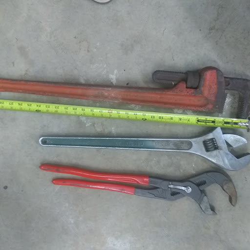

I am not arguing that a Knipex pliers are stronger than a similarly sized pipe wrench but I do believe the design and actuation of the jaws and teeth create more grip than a pipe wrench... again from my experience... no data, sorry. In fact, looking at Mc/I stress, a cheater pipe may fail the Knipex handle before a decent quality pipe wrench handle, but I don't think strength of the tool is the issue.
I will vote again for Knipex and heat. A little cheater won't hurt. Looking at the OP posted pics, I would say grip is the primary issue... let's get a better grip and add some heat.

OK back to the topic at hand....still think 1/4" of threads is enough for the jaws of a properly sized pipe wrench...plus you get the full leverage of the larger arc...(further away from the center)...
I do too. I still feel I could have that plug out in seconds with a pipe wrench. The OP spoke of "cinching down the pipe wrench on the flats". That is precisely the WRONG thing to do. pipe wrenches aren't adjusted down, the flexible movement of the pipe wrench is the principal of how they work.
