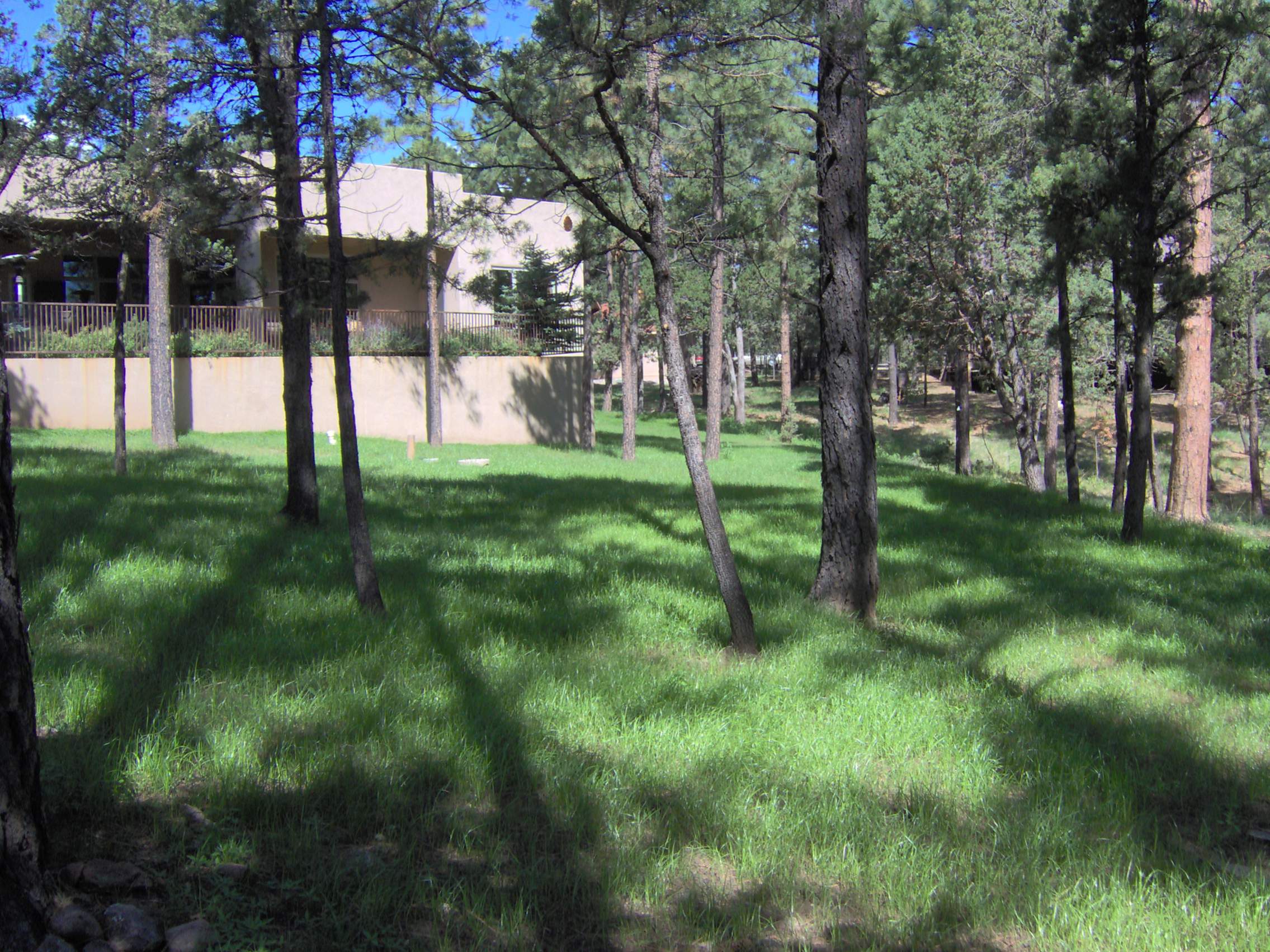

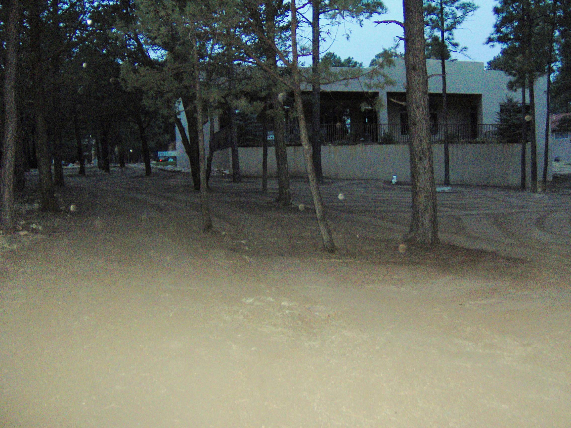

I have had good success with K31 tall fescue stays green about 10 months of the year, some years have been good all winter long. Just checked it at Tractor Supply for $57.99/50 lbs. I also use Scotts starter fertilizer 24-25-04 which works well for my locale as I need the phosphates. No need for lime in my locale as my ph started out about 7,4 to 8.0 depending on the sample location. Seed @300lbs/acre and the fertilizer 125 lbs/acre cost about $500/acre right now, I have seen the seeds and fertilizer discounted about 25% in the off season so you may be able to cut this down to less than $400/acre. I have started mixing in perrenial rye where the need for four season green is needed and so far it has worked out well. Thinking I will overseed my lawn with the P rye this fall.
I find that tilling and running a landplane grader scraper help to smooth up most lawn areas the best. I will generally plane the ground untill I can see and feel how smooth it is with the tractor crossing the yard at high speed. I then run a spike tooth harrow, broadcast seeder with multiple trips to insure uniform coverage and run the harrow to cover the seeds. I use a water filled roller to finish the job and then add water.
Here's a picture of my lawn using the above methods and a customers lawn with before and after results.
