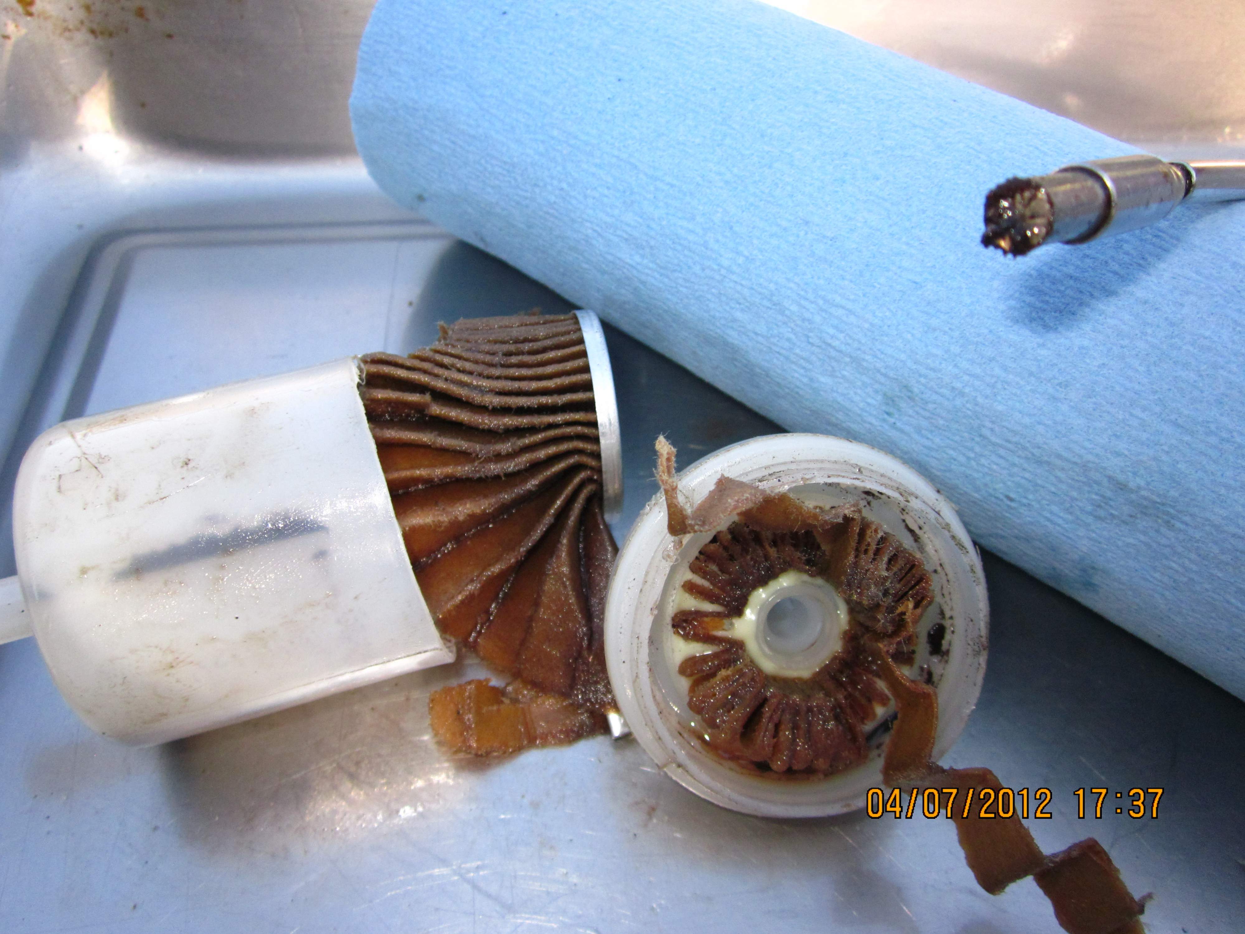

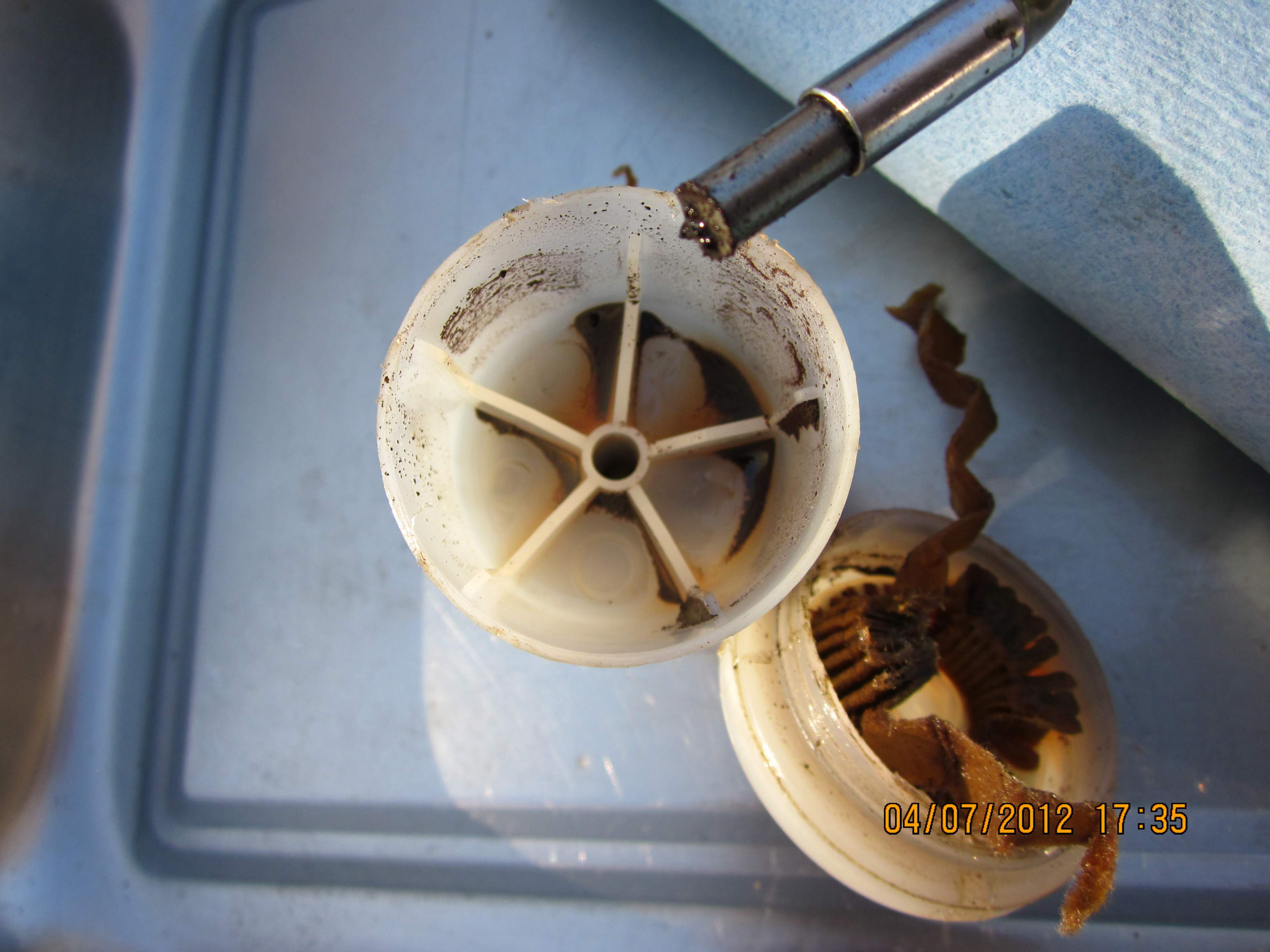

I read your post as my BX24 has been running rough and fuel gauge quit working last Fall. I have had to blowback to the tank four weeks ago for no flow condition after tank ran low on fuel. Today I was changing oil and filters and upgrading to SUDT fluid when I noticed dark spots on fuel filter while changing it. Cut it open and got a magnet. Metalic corrosion dust!
Always garaged and never had a water problem. Buy my fuel only from a major independent supplier that we used to buy our test fuel at GM from (Spencer Fuels). Looks like the same problem you had. I am ready to remove and seal the tank sending unit openning off like Don White suggested.
Just rolled 400 hrs and that filter was replaced for rough running less than 20 hours ago. Plan to call Dealer on Monday and see what they think and have to say.

I am interested in your posts because I seem to be having similar problems with my BX25.
The pictures look pretty black suggesting that the rust may be iron sulfide. We would expected a more brown-ish orange color rust from water (condensation) problems.
It is possible that your diesel got contaminated with sulfur-reducing bacteria (SRB). SRB can convert sulfur in the fuel to more corrosive sulfur compounds including hydrogen sulfide.
It would be difficult to tell for sure. Chemically speaking, if you mix the black rust with a little hydrochloric acid and get a rotten-egg like odor, then it's definitely iron sulfide and SRBs are suspect. I don't recommend that you try this outside of a lab without special safeguards.
