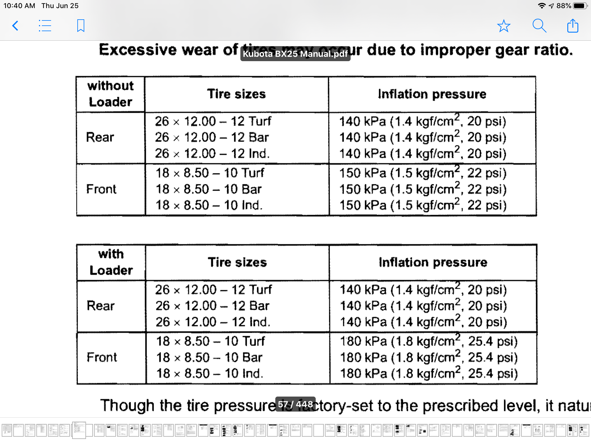

Not sure where you are getting your tire pressure values but here is a screen shot of the manual for tire pressures on the BX2370-1.

My manual says 17psi front and 14 rear with turf. No loader. Your chart says model 25 not BX 2370 ??
Yes the manual is for the BX25D. The base tractor is a BX2370-1 outfitted for the BH and FEL. I can’t imagine running with the subframe on and BH and FEL off it would that much weigh difference. I’m no expert. I will agree it rides rough but it is a tractor. I have not noticed the pressure in my tires on occasion and they have gotten as low as 16 and it was noticeably sloppy. I also never take my FEL off and don’t use it for mowing. I guess a different beast from a BX2370 given use and attachments.
