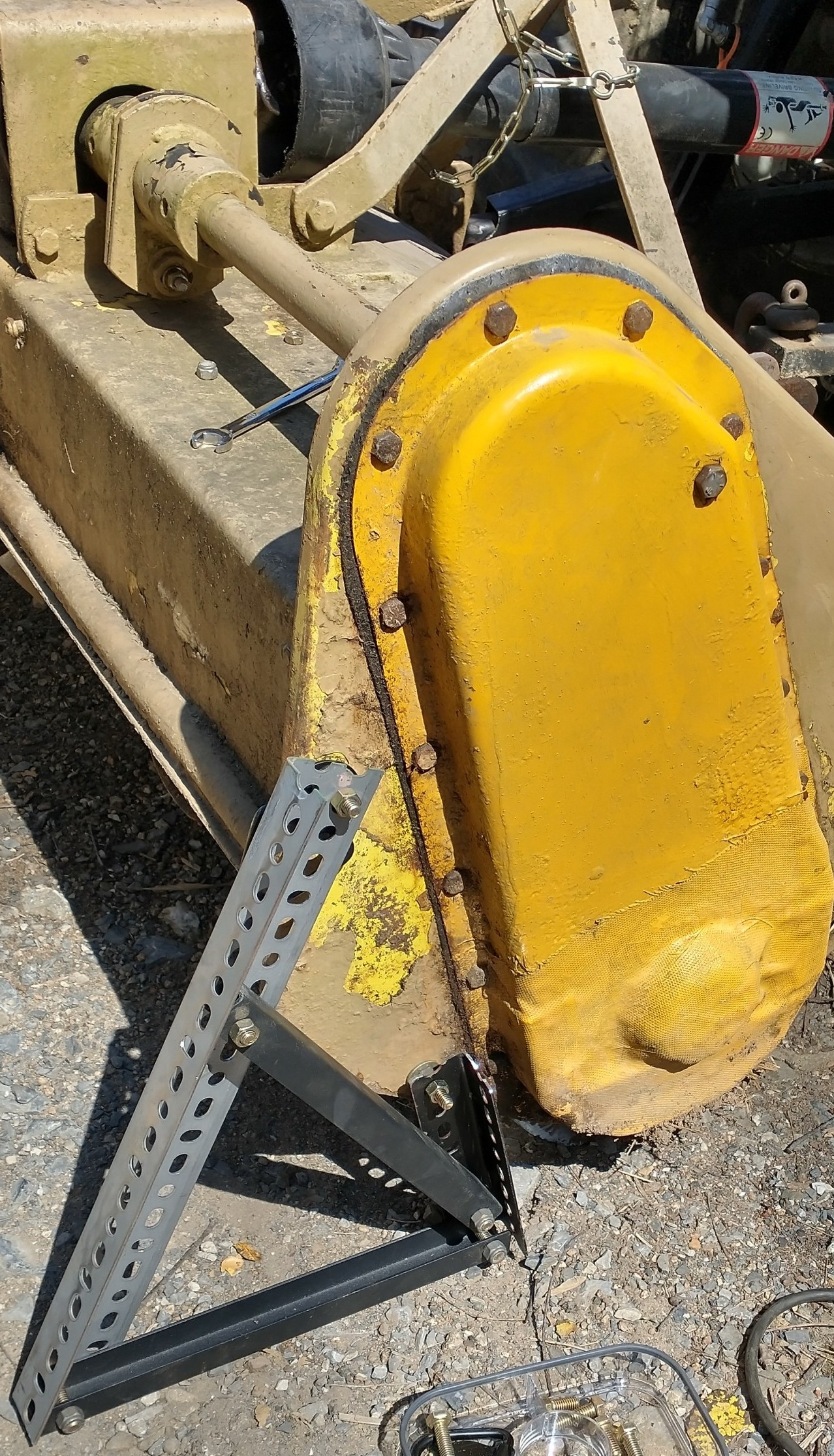

Well, I found a used JD 4 foot tiller so that is what I use. Width of tires is 60", but the tire tracks really don't matter that much, works fine.

Well, it a kind of yellow, I don't have anything green either:

   / Rototillers for beginners #24
Well, it a kind of yellow, I don't have anything green either: View attachment 715128
OK, I'll bite . . .
Those are some interesting skid shoes on that tiller. Looks to me like that perforated angle would get bent up dragging through the ground. No?
Is that some kind of epoxy repair on the bottom of the gear box? Does it work? As in not leaking? Wish I'd have thought of that a few years ago when I had a troublesome leak on a JD haybine gear case. Might have saved lots of time and money.

Looks like a stand to hold the tiller up, and dirt on the bottom of the case to me.

Yes, the repair is fiberglass and west system epoxy over the rusted chain case. No leaks.

You are right, it is a parking stand.
Got it. Thanks. Can you leave that on when you use the tiller or do you have to unbolt it?
The other thing I was asking about is the mesh fabric material that looks to be wrapped around the oil case from the bottom and up above the bulge where the bearing is. Is that a repair of an oil leak or am I reading that wrong too? Thanks.
Thanks! Had a similar case that was hard to remove and install. I tried to fix it once and the dealer tried twice and it still always leaked. Had permatex oozing out of every gap and bolt hole. This might have been a solution for that one. Good option to keep in mind. I don't think I've seen it before.

Yes, I removed the case for the repair. I have a fair amount of experience working with fiberglass, made my own surfboard in high school.
