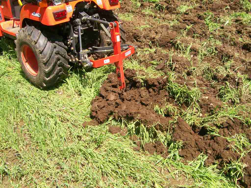

Here's a subsoiler. Also, while you're in the search mode, take a look at "middlebuster". Several of the TBN members have 'em and use 'em with tractors in the same general hp class as yours.

This is a middlebuster on a BX. They can be bought as a combination subsoiler/middlebuster in "XB" size for the BX tractors at TSC for a little over a hundred bucks. Don't know if this is what you want, or need, but they are available for your tractor.

I have a middle buster on a BX2350 and it works great. Don't really have a problem with traction, and I have turfs. I paid $120 for a King Kutter Middle Buster on sale at Fleet Farm. So IMHO I think a Middle buster and tiller would suit your needs.
