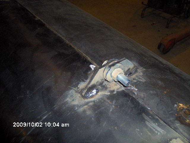

/ Rotisserie
#11
http://www.tractorbynet.com/forums/attachment.php?attachmentid=141566&stc=1&d=1254536441
http://www.tractorbynet.com/forums/attachment.php?attachmentid=141567&stc=1&d=1254536562
Still looking for idea's
