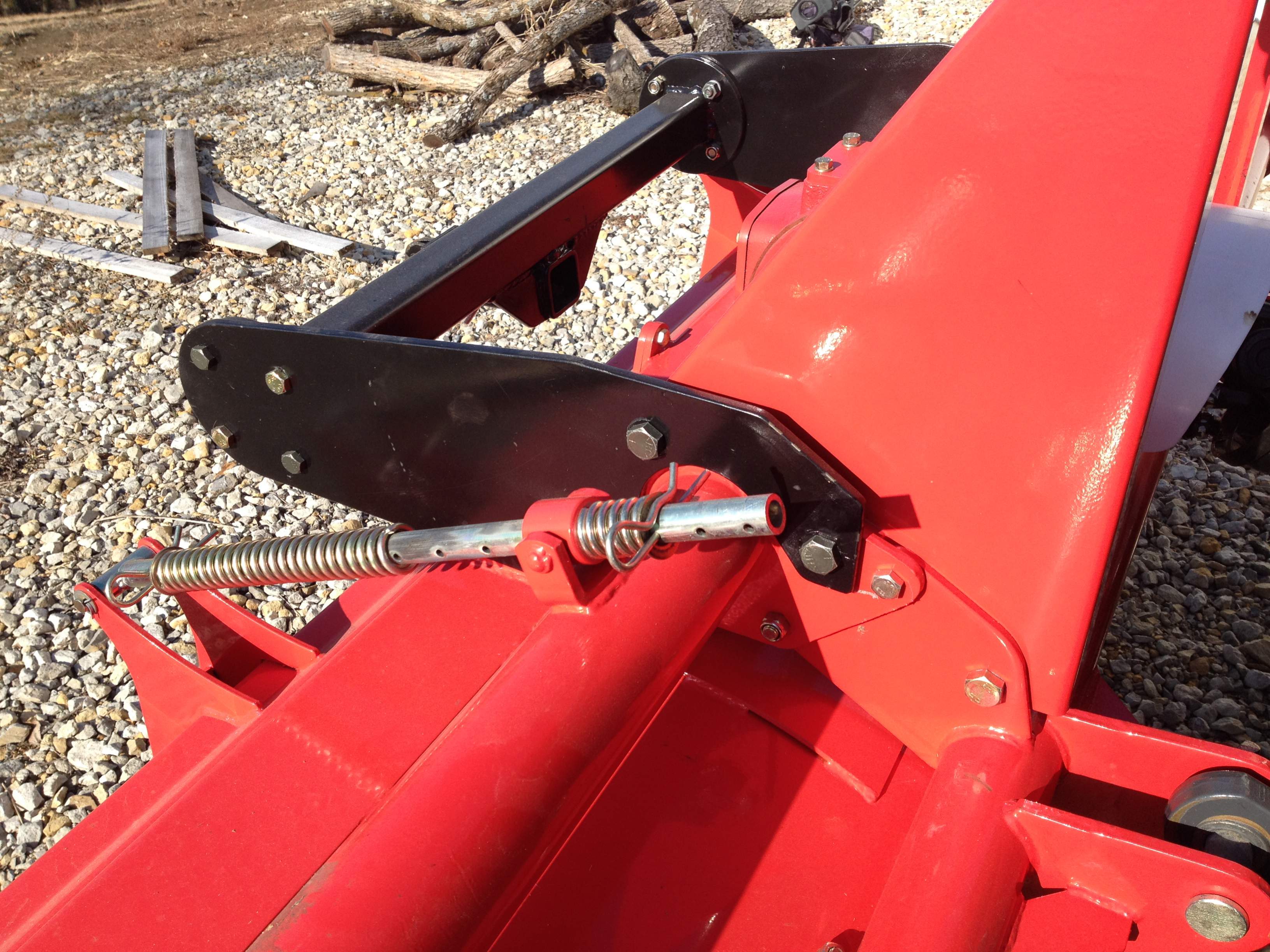

If you look at the pictures you can see the normal location of the spring. To hold the tail gate open you pull the lower clevis, to free the lower spring, lift, and put the clevis pin above the small spring topside where you want it set. My unit came with two springs per side for adjustment (long one below, and small topside. To put down force on the tale gate you move the spring up on the bottom against the mount and put the clevis pins in to hold closure pressure. Once you get it assembled, you can play with the spring and clevis pin location to get it to do what you want. It is fairly easy to adjust, but a second hand makes it easy. That tale gate is heavy
Now to work on the tines I have a choker chain with a big hook on one end that fits the lower edge of the tale gate and chain it up as high as it will go using the top link frame. You will need to free the top spring up, lift,I then put the clevis pins in the closest hole to hold open, as back up in case the chain slips. On my unit there is a hole in the bars at the correct location for this work.

Here are a couple of photos of the side arms for the receiver mount I fabricated to allow attaching a cultipacker to a YJR080.

Take a look at ebbkubota second photo above. That is how the springs should be. You move the clevis pins into different hole positions to get more or less pressure.
