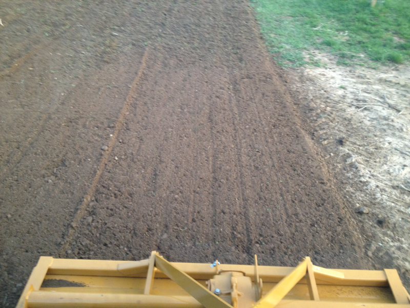

I have the standard sized TSC-branded-KK 48" tiller on my BX. The reason I don't go with ANY XB attachments is 1) Standard size fits and works just fine 2) If I ever upgrade to a larger tractor, I don't want to re-buy all my attachments.
btw, the KK 48" tiller is a beast. The paint was a little soft at first but I bought a can of Cat yellow and repainted where needed. It goes on soft then hardens like rock after the solvent gas out. Also have a 48" KK rotary cutter and KK Carry-all. Welds are good, paint is good (enough), products are great. No problems here ever.
I cut about 3" or less off the PTO shafts, just make sure that the shaft doesn't bind when the implement is lifted to the top position. And then cut to that length.
Hope this helps your decision. Orange (XB implements) isn't always better in this case.
