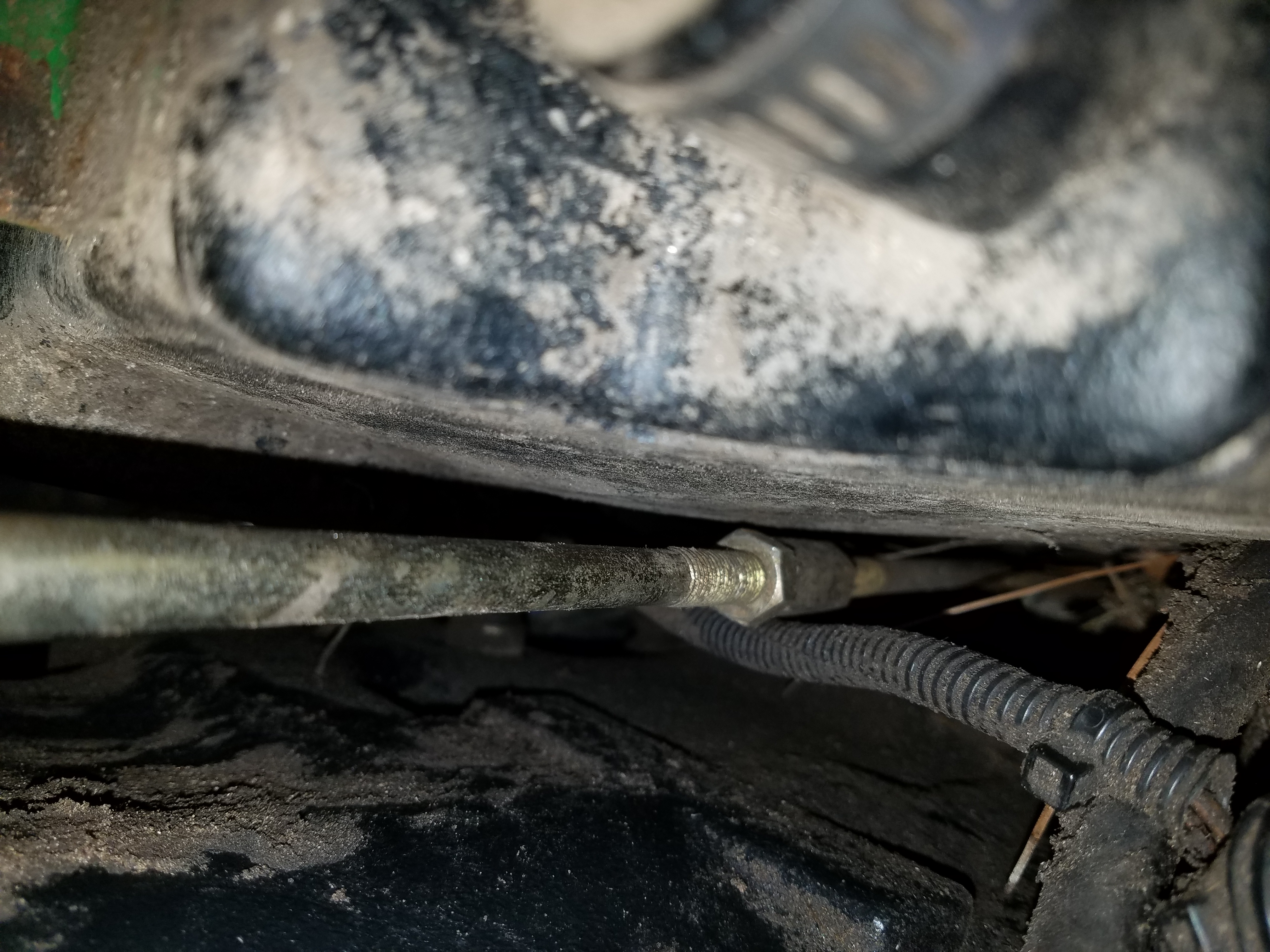

PTO inside the tractor is slipping. See my earlier post. It's not the mower or the external shaft. Do you have an independent PTO or a live PTO?
Post #13....OP said: "I have an independent pto."

How hard is it to replace these clutches if they ever fail?
/ Rotary mower stalling #26
Most the time you have to split the tractor....in half. It is better to make a simple adjustment.

I tried adjusting the pto clutch linkage...couldn't. The thing is in a very tight spot and I can't even get a wrench on good enough to loosen the jam nut.
I also noticed that if I put the PTO lever halfway...the pto will spin faster and mower wont bog down as easy.
If I engage the pto fully..the pto will be slow and mower will bog down.

Is there any wrench I can use to get in this tight spot?
/ Rotary mower stalling #29
Maybe a crows foot;
or can you pull a pin or two and drop it out to adjust and then repin it.

I can't even reach the pin. My hands are too big.
I will try a crowsfoot.
Thanks.
/ Rotary mower stalling #31
That is what I was thinking...a crowsfoot, swivel, long extension, and swivel head ratchet. You think it is metric?

Was able to get whole linkage off, but I can not put the **** small snap ring back on. Lost it. The lever is staying on, so I might leave it as it.
Adjusted everything.
Mower is doing great!
Thanks guys!!
