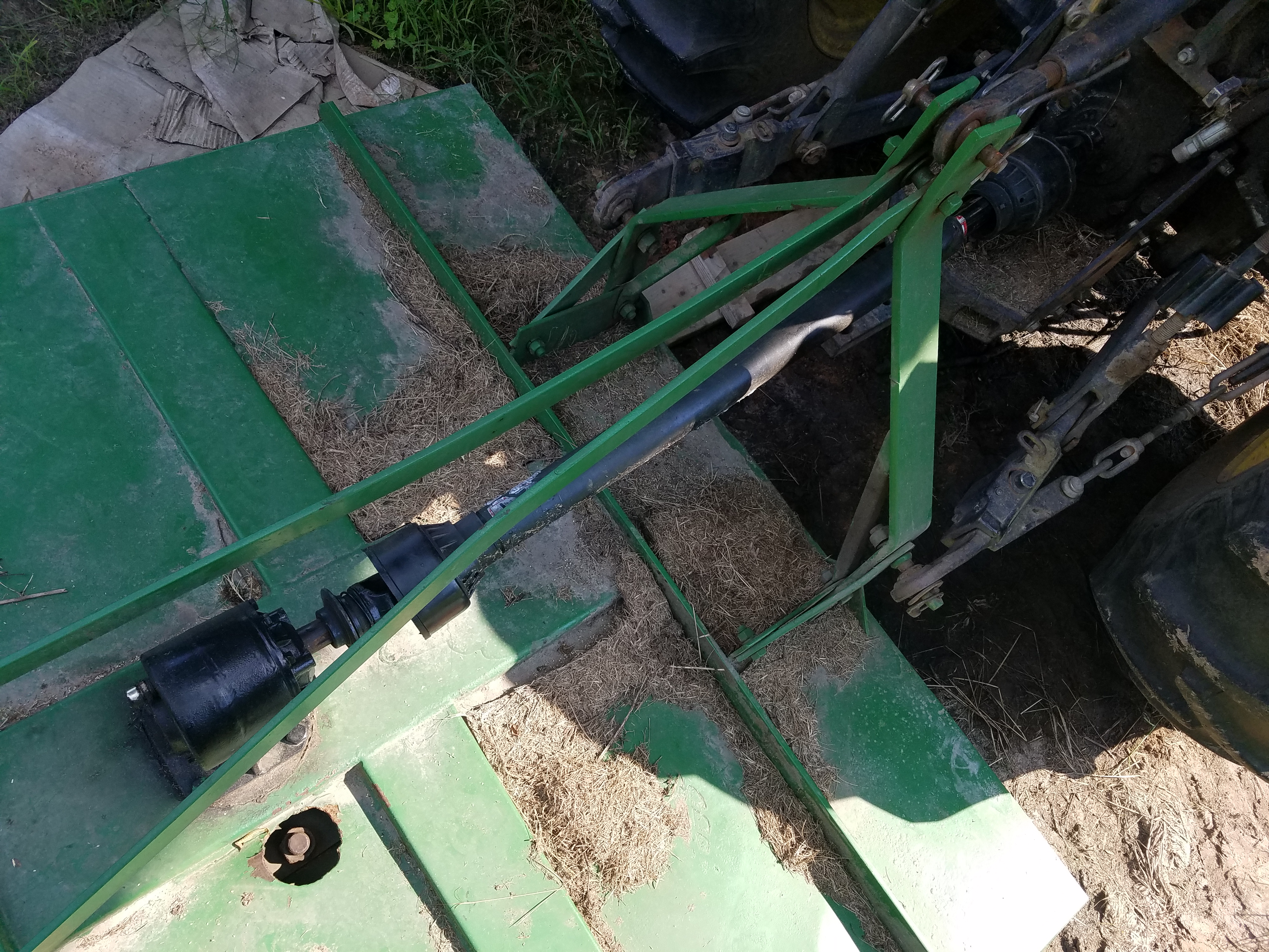

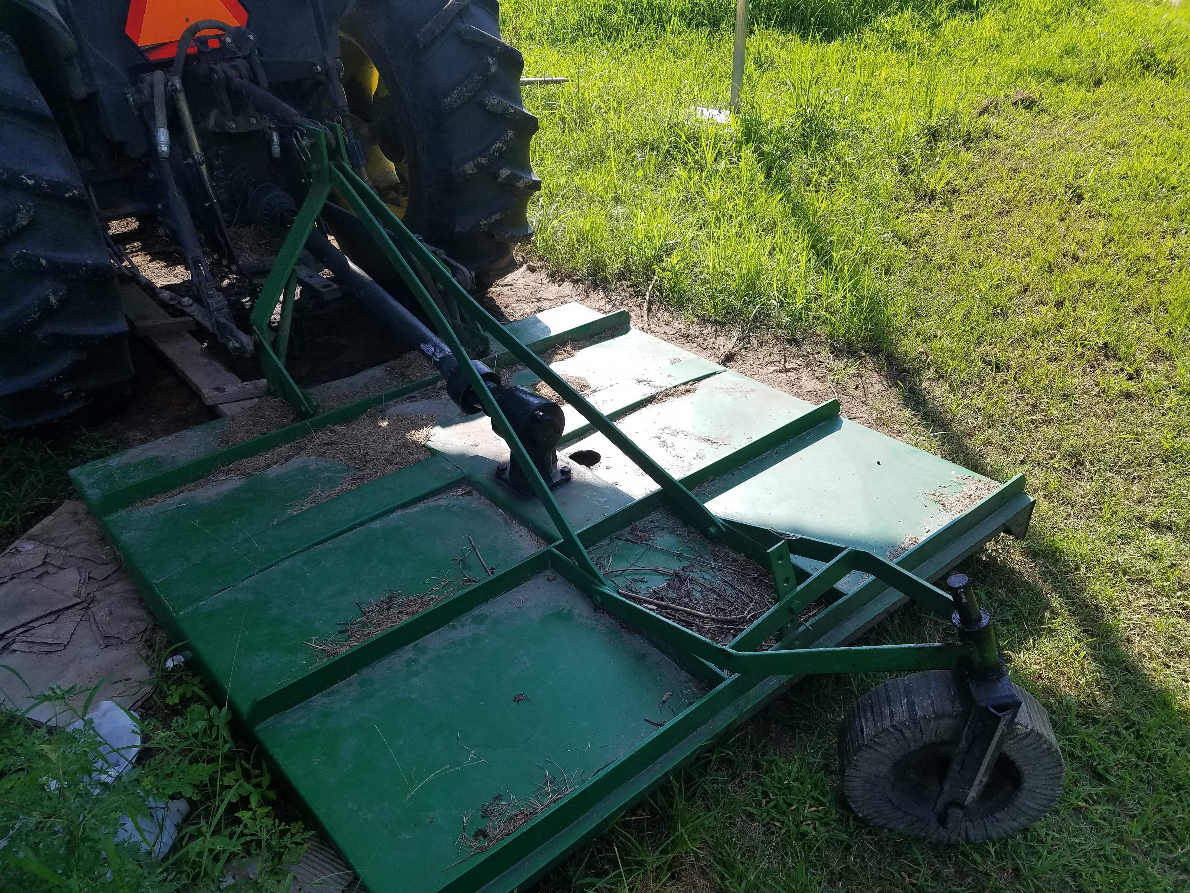

Rotary mower keeps stalling on me. I have it up to the 540 mark and it starts bogging down in the grass. I have mowed with it before, but now it seems like it doesn't want to do nothing but stall out.
Basically, the pto just stops until I lift up on the mower deck. I don't have a slip clutch pto shaft on it.
The other mower I did use would cut with no problem through the grass
I am about fed up with it. The grass isn't insanely thick either.
What could be the issue? Guy I bought it from supposedly put a new gear box, stump jumper, and blades on it.

1) Are the blades sharp?
2) Mower should NOT be level. If level, grass is retained within.
Front of mower should be 1" to 2" LOWER than the REAR, so only the front cuts and at the rear the blades exhaust clippings.
3) A deck with less height does not mow longer grass as well a a deck with greater height.

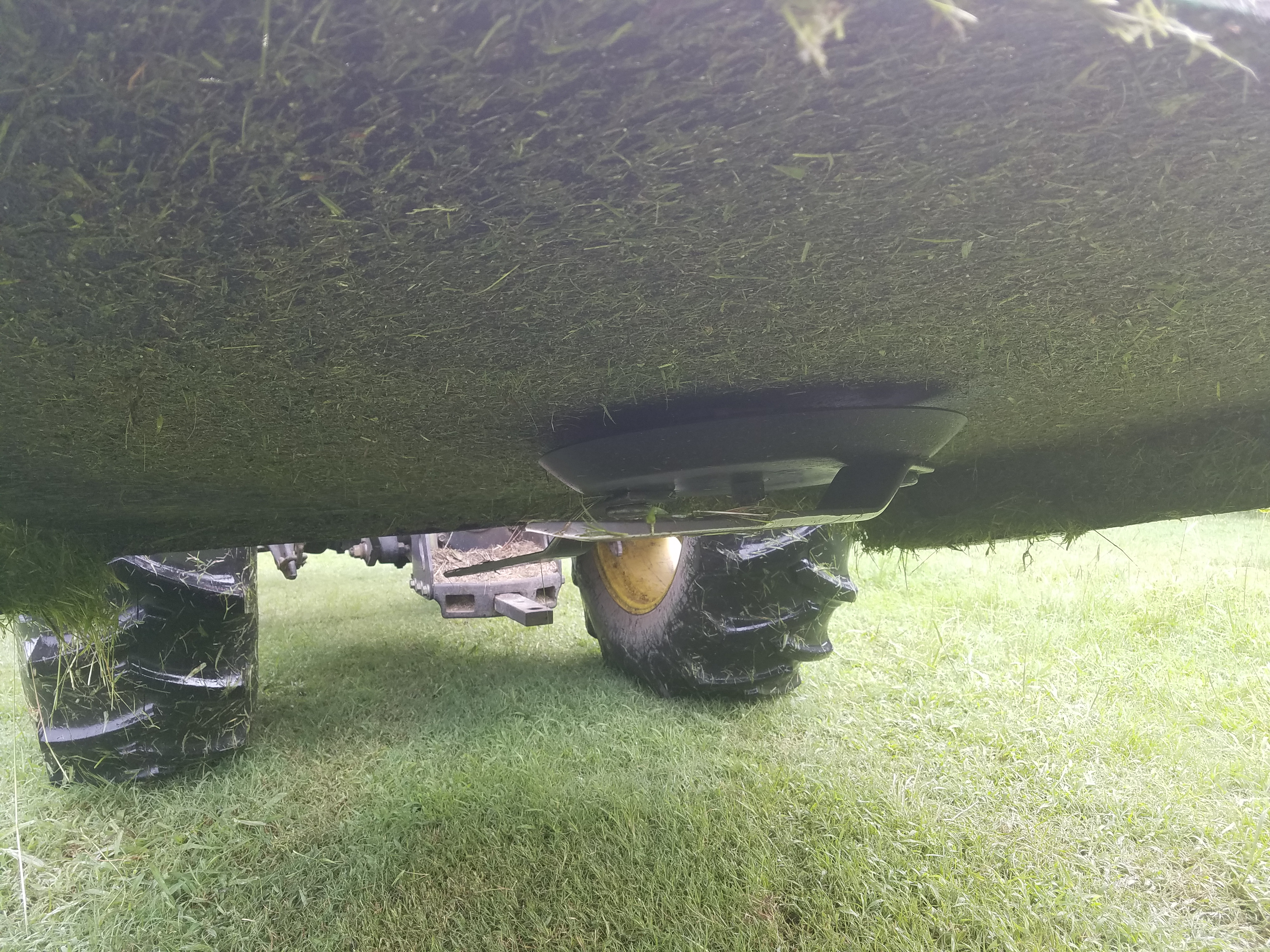

flip it over and make sure that the guy ya bought it from didn't put new blades on it. mine bogs down a bit when blades are needing some lovin. also check fluid levels and grease fittings. if that don't fix it move up to the tractor and figure out why the torque is dropping.

If you mean, as I am interpreting it, that everything from the PTO output on the rear of the tractor and the entire PTO shaft on the RC (basically everything in the pictures you attached) stops spinning until you lift the cutter back up - then your issue is in the tractor and not the cutter and I would refer you back to what ericm979 said.
If the PTO output on the tractor & the RC PTO shaft is still spinning but the cutter head is not turning, then you have either sheared a pin between the shaft & the gearbox or the gearbox is trashed. Since you also state (and show) that you do not have a slip clutch, then a shear pin is the most likely culprit in this scenario as that is how the RC is designed. The pin shears off before something more expensive breaks since there is no clutch.

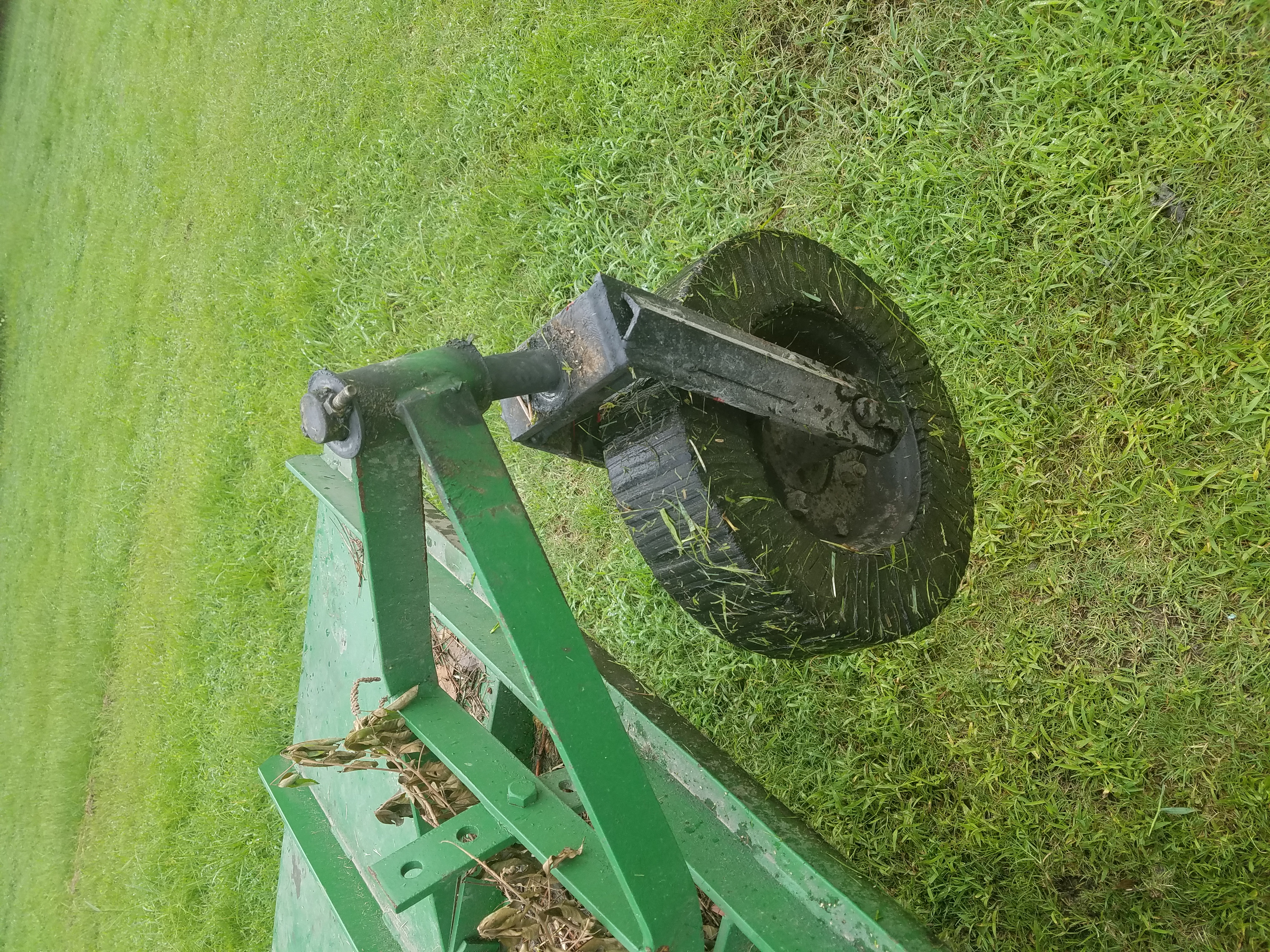

I think I do have it too leveled.
I am probably going to take the slip clutch off the older mower and put it on this mower and see how it does.

It looks like you have an input shaft on the gearbox has splines. That is for use with a slip clutch. You say you don't have one and neither do I but I don't see how a shear pin will work on a splined shaft. You may not have a solid connection. from pto to gearbox. Does your shaft slow when the cutter bogs?
/ Rotary mower stalling #15
My flail had splines on it. Flails typically rely on the belts slipping for protection. The replacement shaft I ended up with has a sheer pin inline with the shaft on one side despite not needing protection. Part of the shaft itself slips on itself if the pin pops. A bit of an uncommon design, but gets protection on a splined input.

When the mower stalls, does the PTO shaft (inside the safety shield) also stall? If it does, the clutch inside the tractor is slipping.
If the PTO shaft keeps running properly when the mower stalls, check the connection of the gearbox output shaft to the stump jumper/blades. Is the nut tight? Splines stripped? Key sheared?

Here are more photos
