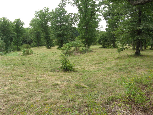

Well, i am going to offer an opinion based on the 4 hrs of brush hogging experience that I now have.
While a cutter as wide, or wider, than the tractor is probably the way to go if one has large open areas to mow, I don't think I would want that in my situation. I have numerous trees to cut around, in addition to the piles of rocks that I created trying to clear the place of stones, and also have a few piles of un-burned logs remaining from bulldozing many years ago:
My cutter is about 4 inches narrower than the rear tires of the tractor (2 inches per side), and if it had extended out past the rear tires I would have been forever "hooking" things, or else i would have a sore neck from looking back all the time watching the thing (I do look back, but not constantly).
I should add that I only have a short section of one boundary that is fenced, and for other reasons I do not mow along that fence.
The OP did not describe the layout of the land in question so i don't know if any of the above would apply in his situation.
