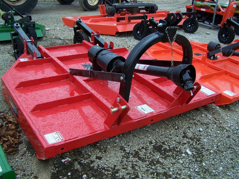

We can deliver this cutter to the Williamsport truck terminal for $2095. Ken Sweet

I just edited it to show the pic only. How does that look? Ken Sweet
Well, no offence, but it looks like one of those cutters that traps a LOT of dirt and on water on top of it...
Personally, that's something I don't like having to keep up with...
Do you have to have a big azzed socket to get the blades off it??
SR
SR
Most safety conscious companies stopped putting holes in the top to keep some dummy from sticking something in it while the flywheel was still turning. Ken Sweet

A mower with a sloped top might be a good idea, especially if it'll be parked outside. I've seen mowers rust out when grass left on the deck was rained on.
Ken that must make changing blades a real treat!
em14
/ Rotary cutter suggestions? #20
Ken that must make changing blades a real treat! em14
I have an old cutter that must not have had a hole in the top. The previous owner used a cutting torch and fixed that problem.
