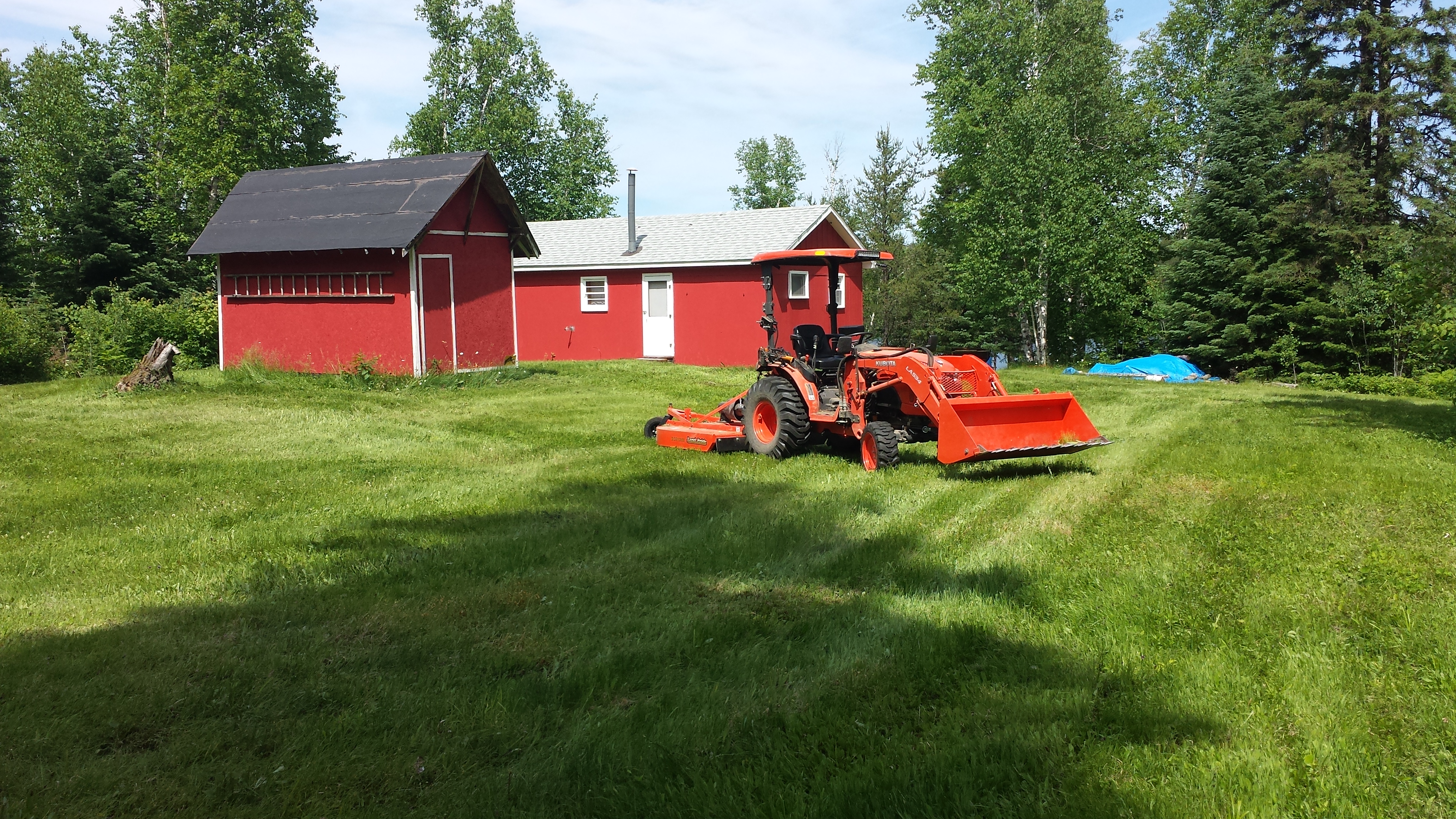

I have a Land Pride RCR1260 that I bought new with my B2560 in the fall of 2017. The main reason I chose this cutter over anything else was the fact that I could include it with the tractor and a couple of other implements in my 0% financing. I haven't used this cutter a lot but I have used it to run over brush as thick as 2" and it has worked great. Last summer I used it to help the neighbours at our camp. They live in Michigan and are about 5 hours away. When they come to their camp in the summer they have to fight with 2 to 3 foot tall rough grass and weeds for a couple of days before they can enjoy their camp. I went over and cut the entire lot in about 15 minutes. By cutting it down to about 4" they were able to finish it off in an hour with a push mower when they arrived. I then widened the road to their place by about 5 feet using the cutter and just driving over the alders impeding on the road. I couldn't be happier with the performance.

You're welcome. My plans for the cutter are to mow both sides of my camp road. My camp road is on an old snowmobile club groomed trail and the club used to keep the road open. That club folded a few years ago and the road has grown in very quickly. I'm using a JDunn grapple, my bucket and the cutter to get rid of the brush a bit at a time. I should be done sometime this summer. Then I can just use the cutter a couple of time a year to keep the alders and evergreens from growing and impeding on the road. I plan on doing the road to the neighbours' camps as well. Total cut will be about 2 miles each way but it will be easy once the offending brush is gone.
