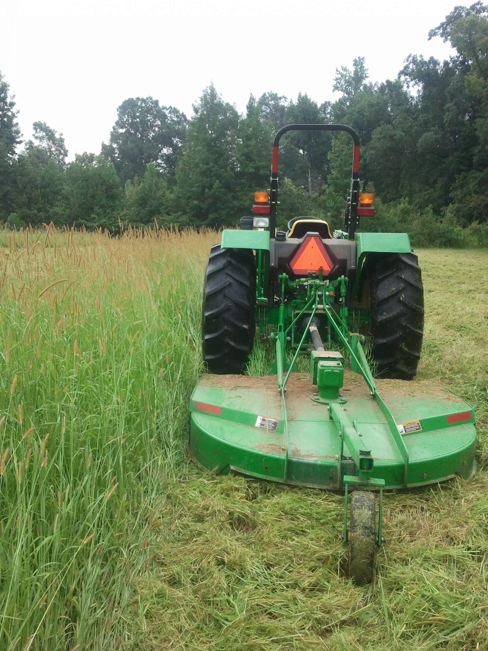

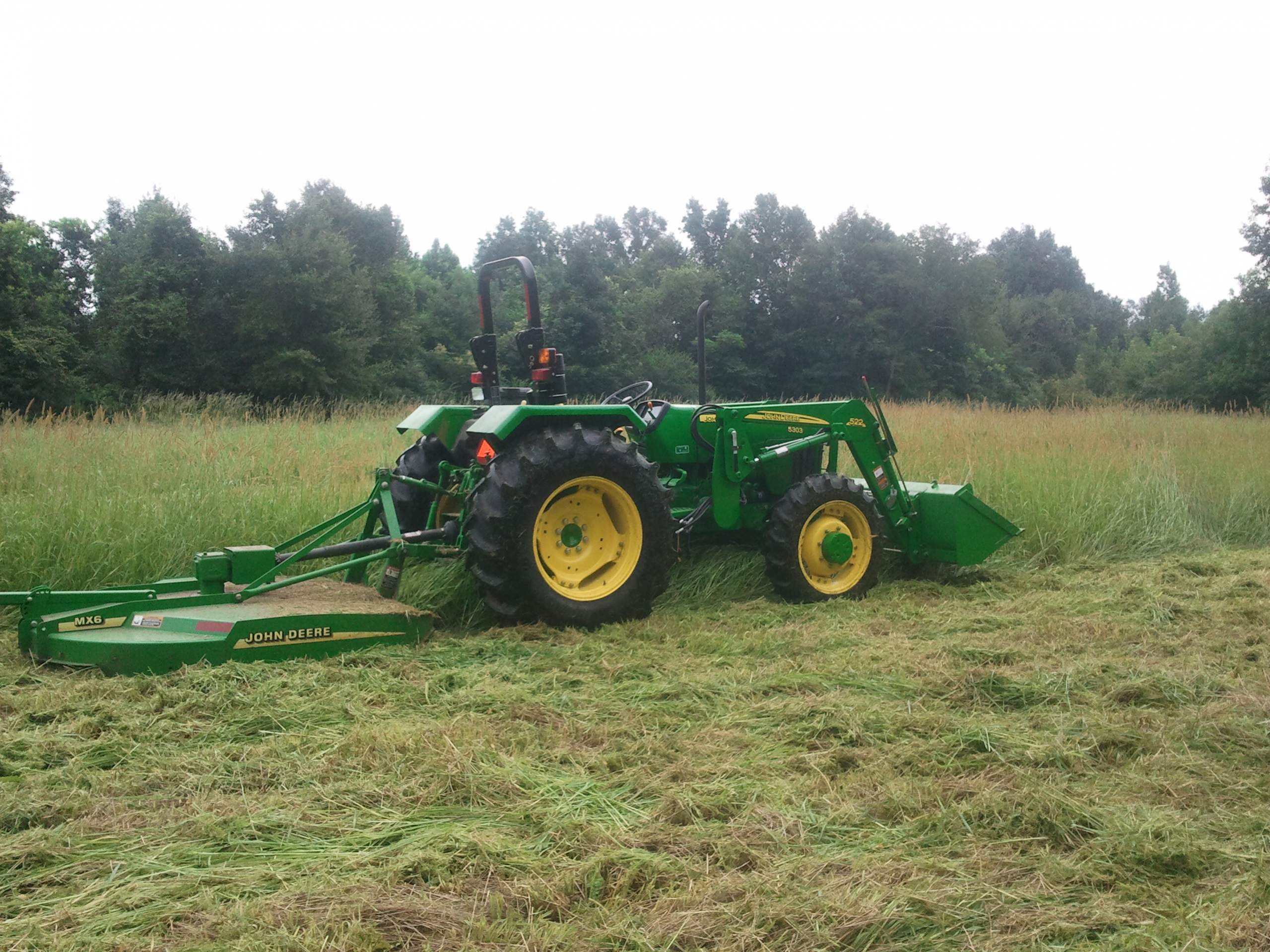

Put in about 15 hours mowing this weekend. Took a couple pictures of what one of the food plots I was cutting looked like. Most of the food plots had 3'-4' tall grass and also cut about 5 acres of 2'-3' tall bahia. I have read several posts lately about rotary sizing. I am running a JD 5303 with around 56 HP at PTO with a 6' JD MX6 mower. On several occasions I could tell the tractor was bogging and even had the clutch slip. I was running approximately 5 mph in these conditions. I am certain slowing down would have been a little easier mowing, but I was needing to get done.

I'm not certain but I think the sway chains are adjusted tight when the implement is raised. They will loosen a bit when you lower it down. The implement will not sway when raised but have a fee inches of play when near the ground.
   / Rotary Cutter Setup #16
Hey I notice you took off your rear chains. What difference in the quality of the cut could you tell?
I've noticed also that my MX6 makes my tractor grunt in heavy grass (44 PTO hp). I've lowered the rear wheel (which is raising the mower) one hole lower than you have yours and it is like I gave my tractor about 5 more horsepower. You can still get a great low cut by putting the front low with your hitch control. Try that set up and I think you'll be pleased with the results. Hight of cut will be determined by your three point hitch. It gives the mower more of a high back to low front angle to cut the grass and I'll never go back to that hole that it came set up in. I would sure like to see the Deere engineers explain the other holes that would let the mower ride lower. On mine the rear wheel would be hanging the air on the last three holes.

I actually didn't remove the chains, but never had them. I bought the cutter with my first tractor and they were not on it then. After reading the post about flail mowers vs. rotaries, I wish I had them. So far have not had anything bad happen with slinging debris. The cutter is left set up just how I received it. I may look into moving the rear wheel position to see how it does. I still have a bit more mowing to do. Thanks for the suggestion.
